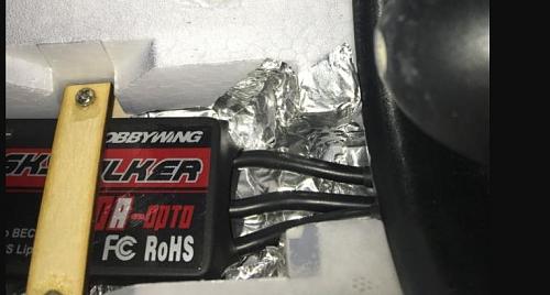

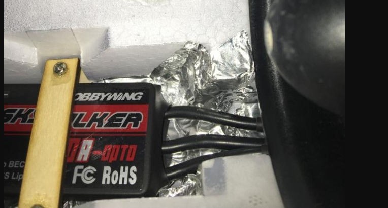

              Someone posted many pages ago the details of how he did this. Quite interesting how he created the alternate pathways to avoid passing near the ESCs.
              Someone else talked about adding metal shielding between the ESCs and servo wiring (I elected to do this because it was easy.). I'm not convinced the metal shielding helps, but I did it anyway. I say that I am not sure it helps because there is no way to ground it.
              I used aluminum metal pipe wrap tape. The servo wires run in a foam channel on the other side of the metal tape.
              Click image for larger version  Name:	MiG-29.jpg Views:	0 Size:	58.3 KB ID:	312207
              -GG
