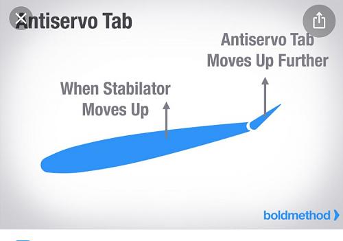

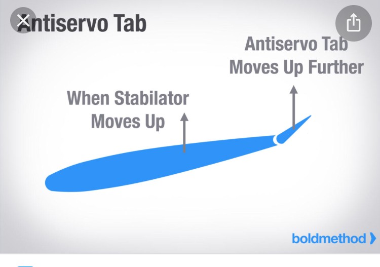

                  Hi Airguardian et al....
                  So there is no confusion, the anti-servo tab may (and typically does) “also” function as a trim tab. But the primary purpose of the anti-servo tab is to “fight the pilot’s inputs” and fight him harder as the deflection amount increases. You can see how this would be the case(photo and video). As the stabilator trailing edge moves more...the anti-servo tab moves even more. They move as if in symphony-always moving with each other.
                  While a normal trim tab....the pilot uses these to prevent him having to “hold” a control in a given position. He lets the trim tab do it for him. However, by tweaking the position of the anti-servo tab with a separate trim control, the anti-servo tab may be made to have the dual function of a trim tab.
