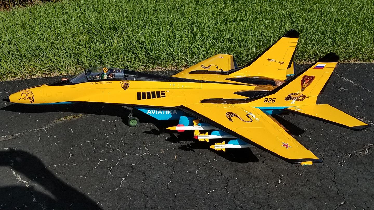

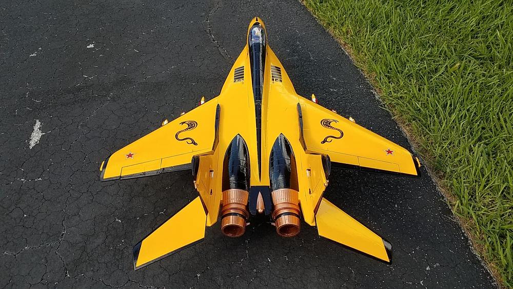

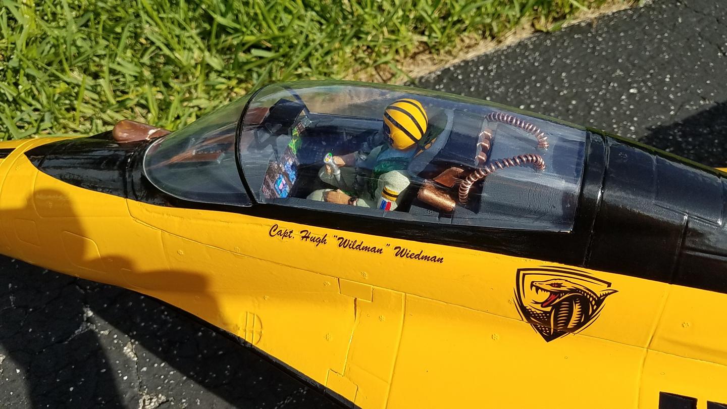

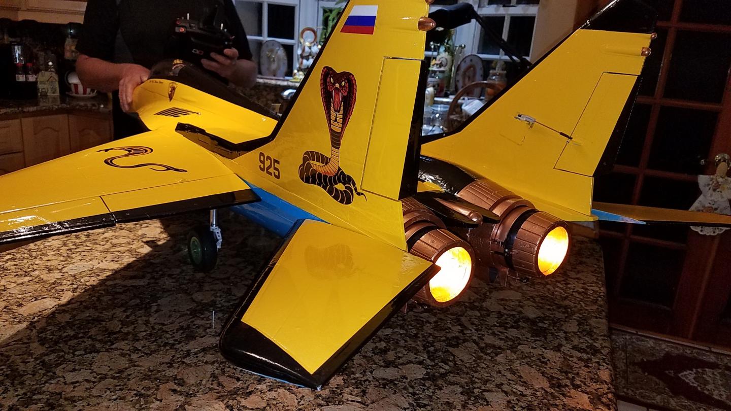

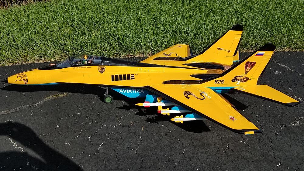

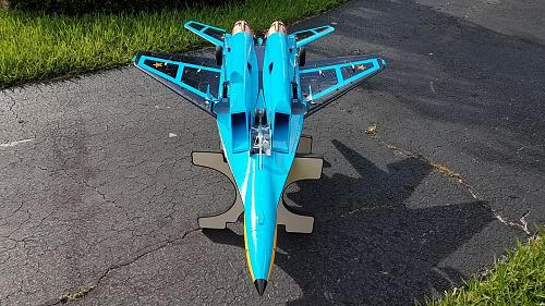

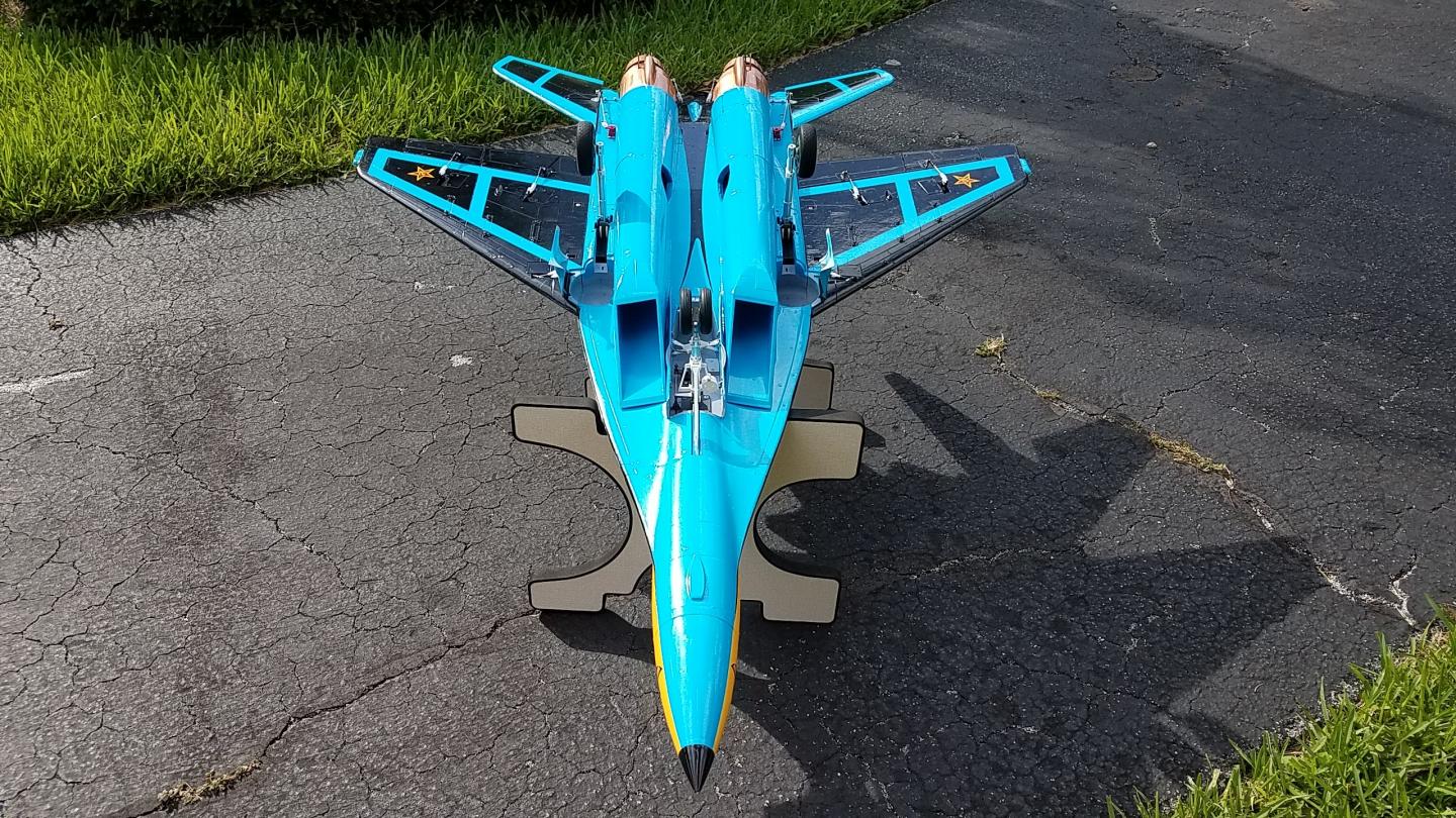

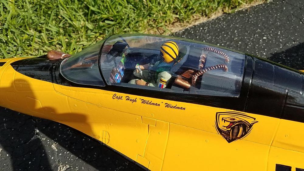

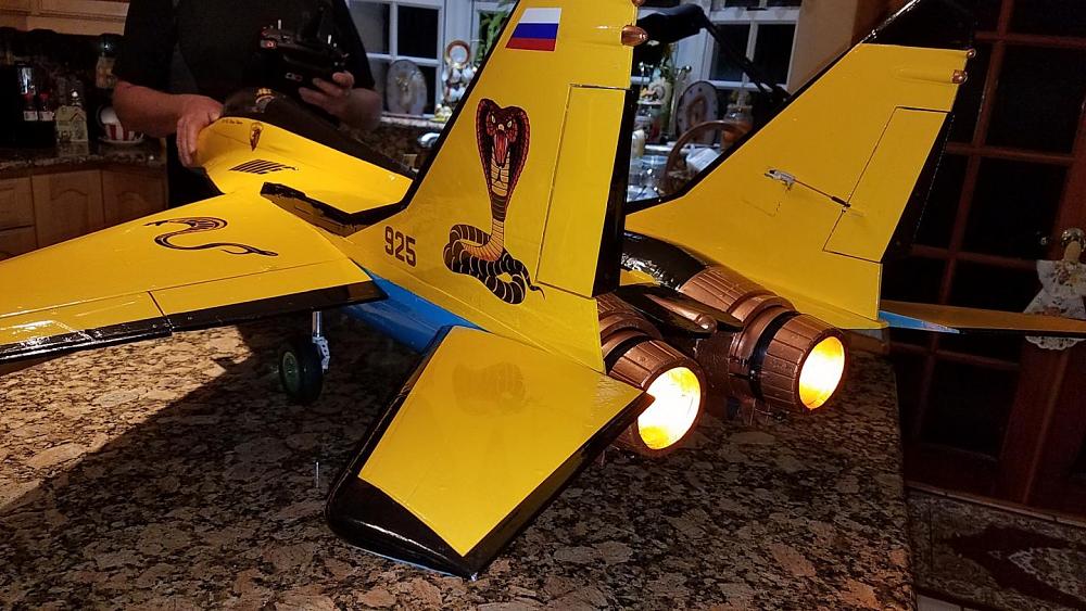

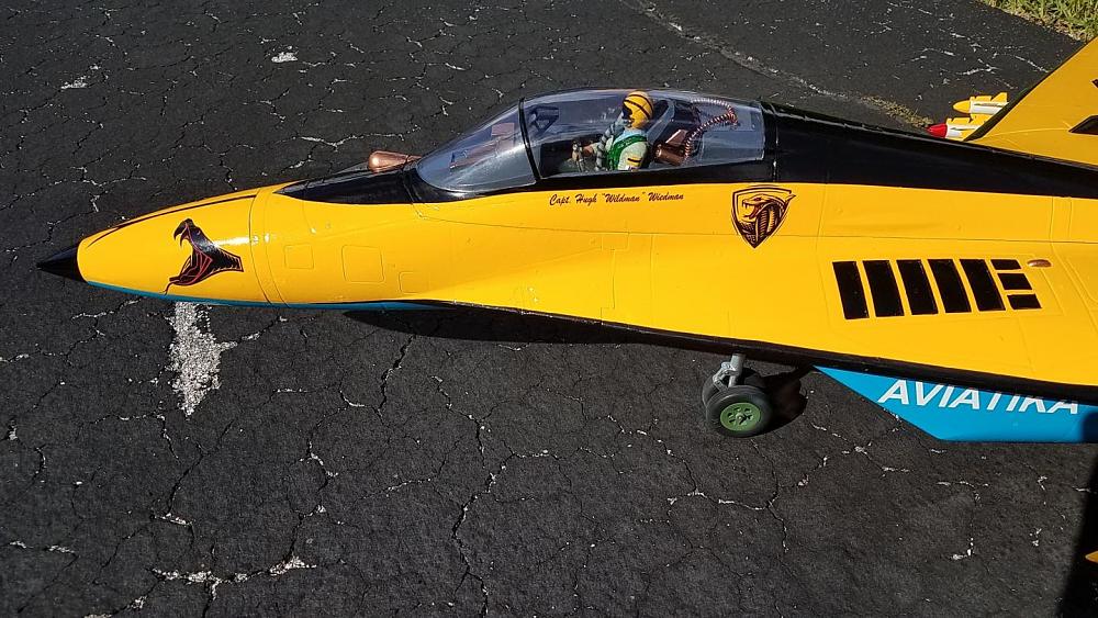

                        • Almost finished with the repaint and modifications of the Mig 29, now going on 6 weeks! Exterior is finished, still need to get RudyD54 to help with installing the channel expander and gyro for the TV nozzles and programming the AR 836T AS3X receiver and TV mixes to mirror his outstanding setup.

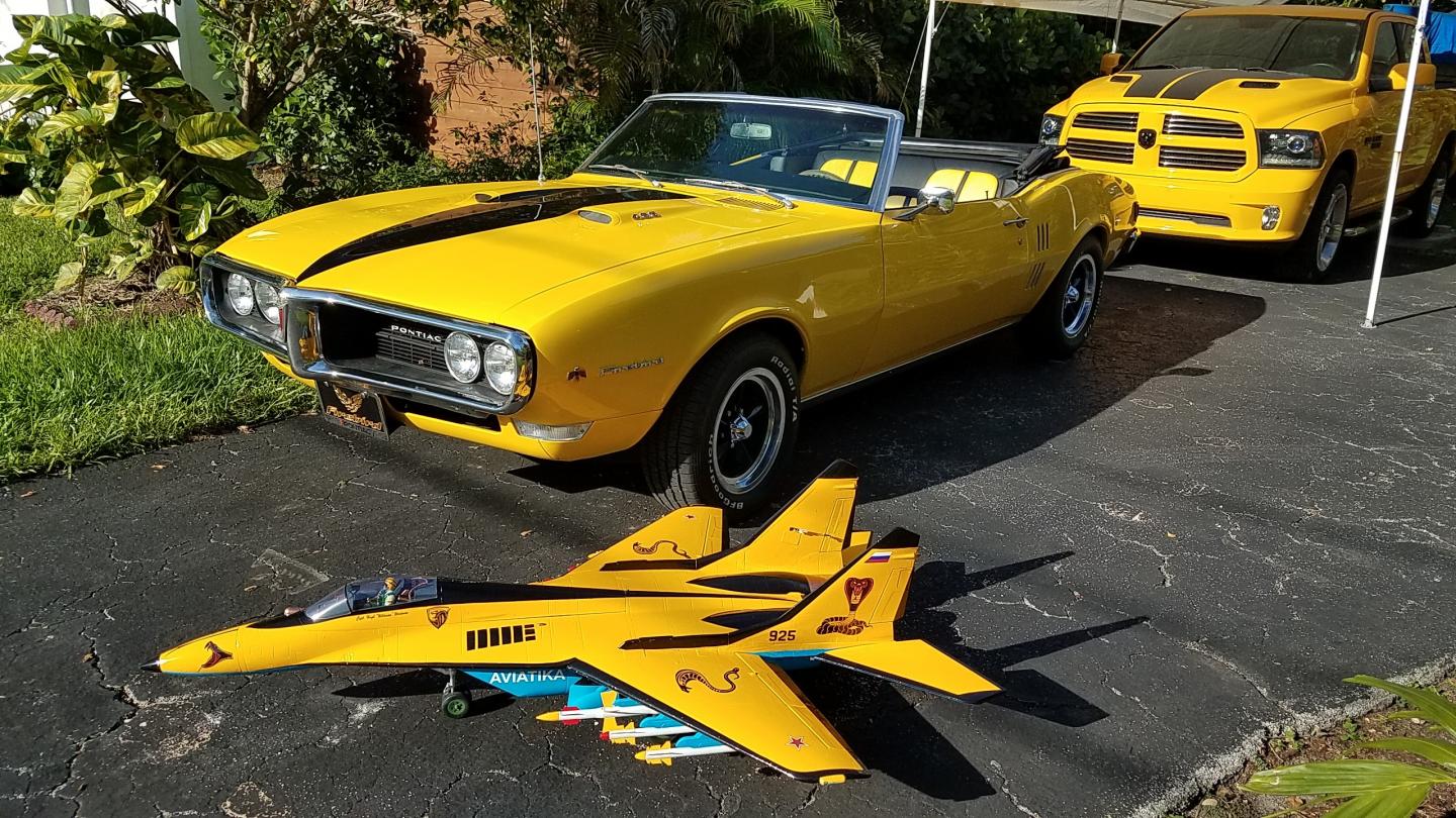

                          Ever since this came out, I was trying to figure out what scheme to do since I couldn't leave well enough alone. There were so many outstanding repaints posted here, but wanted something a bit out of the ordinary (yes, that's me in a nutshell). Then my CO said why don't you do something in yellow/black, to help visibility and similar to your refurbished Firebird 400/Ram Truck/Stinger 90. Finally found a livery that actually existed (rare for me). Turns out there were only 2 done in this scheme, and the Russian pilots crashed into each other in an air show maneuver over London and it was never used again. Boy, that's just my speed, a failed livery never repeated again! Tried to locate the Russian pilots, but seems they've somehow disappeared somewhere in Siberian at a "special undisclosed location". Of course I still couldn't copy it exactly, needed to change it's "Karma", so designed some cobra images and of course Callie did the rest.
                          Upgrades Include:
                          • TV Nozzles and channel expander for them along with a Hobby Eagle gyro for TV
                          • AR836T AS3X RX with remote satellite
                          • ProModeler DS150 elevator servos and servo horns/control rods/control horn upgrades courtesy of Alpha
                          • 20 amp Castle BEC
                          • RC Geek afterburners with nozzles lined with aluminum AC foil tape
                          • RF chokes
                          • Upgraded cockpit instrumentation and JHH full body pilot
                          • enlarged the cheater holes by about 30% as per Corsair nut outstanding build video post #1740

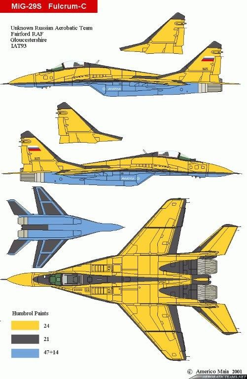

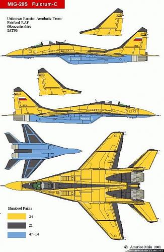

                          The Birth of a Scheme:
                          Click image for larger version  Name:	20210711_180833.jpg Views:	0 Size:	285.5 KB ID:	318528Click image for larger version  Name:	20201223_151755.jpg Views:	0 Size:	271.6 KB ID:	318529Click image for larger version  Name:	#2 Scheme.jpg Views:	0 Size:	272.9 KB ID:	318530Click image for larger version  Name:	#1 Scheme.jpg Views:	0 Size:	94.3 KB ID:	318531

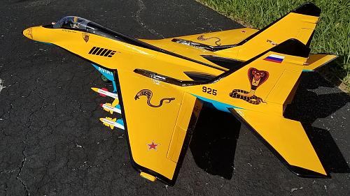

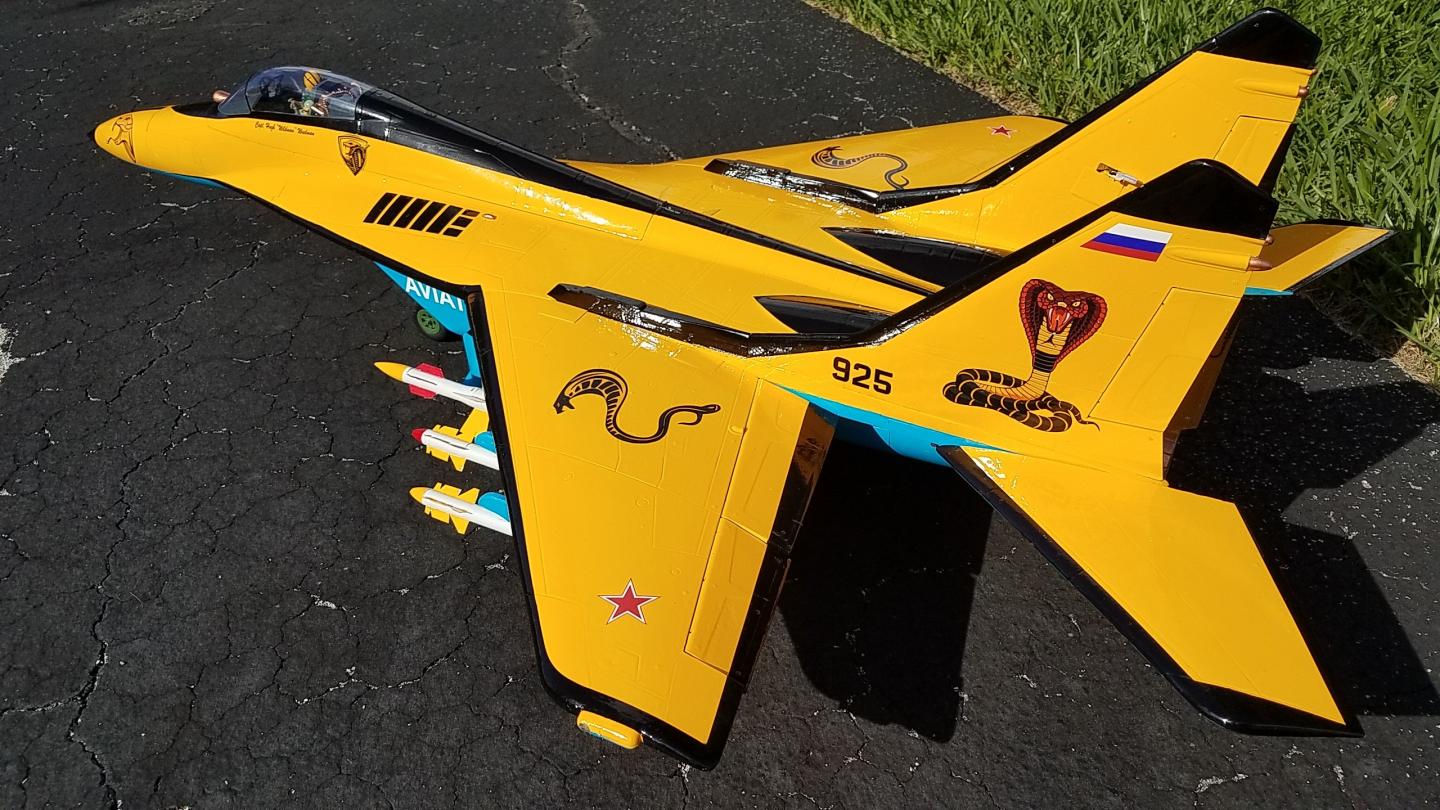

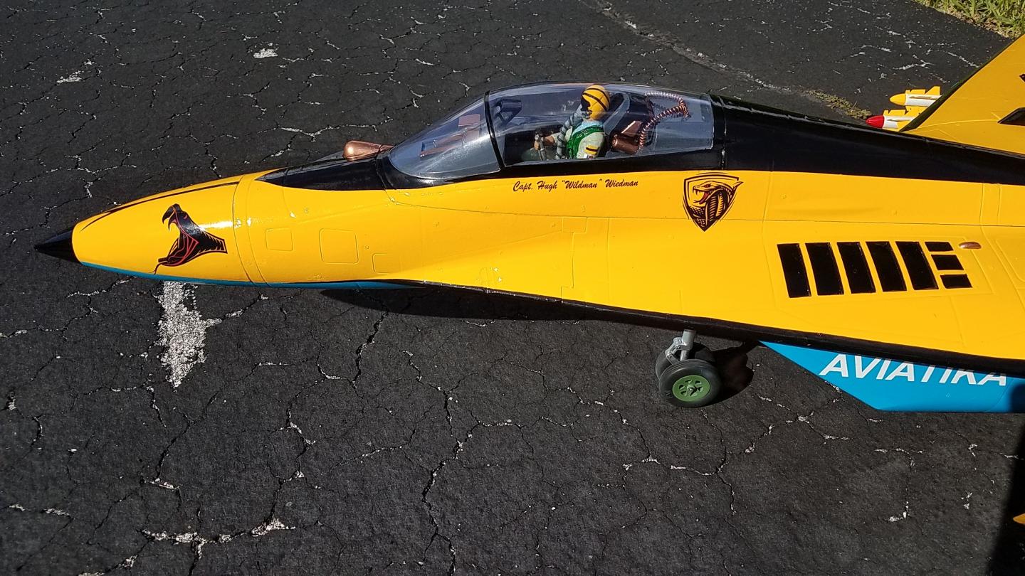

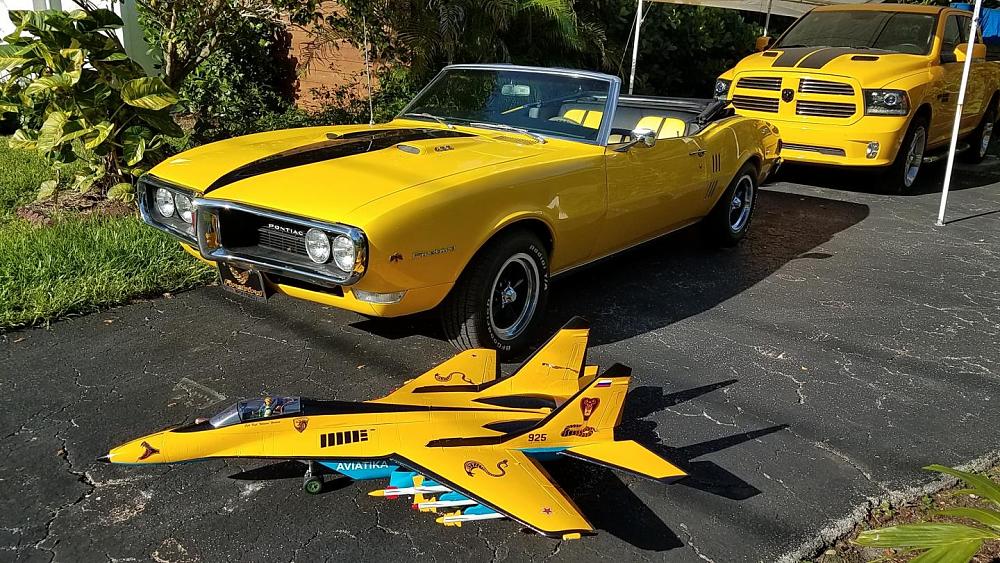

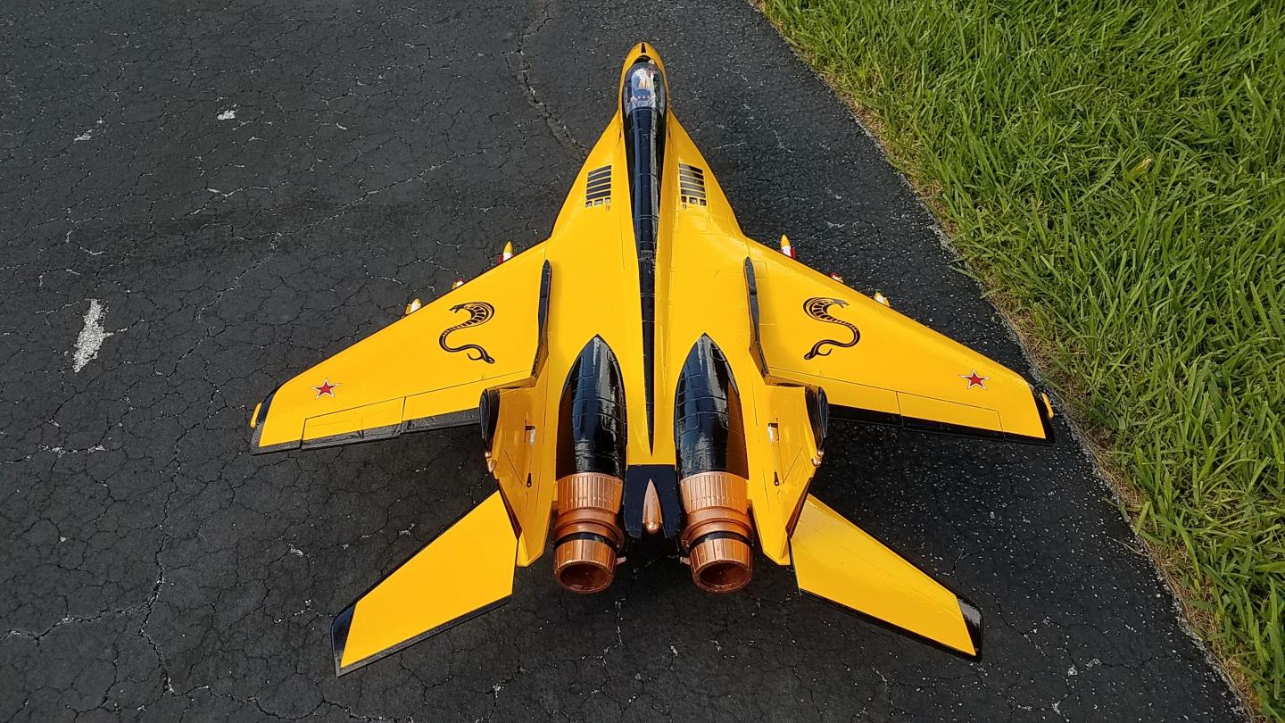

                          The Finished Product, now known as the Mig-29 "Cobra". A vicious and lethal squadron, fortunately made up of only 1!
                          Click image for larger version  Name:	H Wiedman-Mig29 Cobra.jpg Views:	0 Size:	279.1 KB ID:	318532Click image for larger version  Name:	20210711_174139.jpg Views:	0 Size:	209.8 KB ID:	318533Click image for larger version  Name:	20210711_173957.jpg Views:	0 Size:	258.2 KB ID:	318534Click image for larger version  Name:	20210711_173436.jpg Views:	0 Size:	323.9 KB ID:	318535
                          Made several different "snake head" nose cones.

                          • I'm completely stunned, that is one of the coolest custom paint jobs I've seen here. The workmanship is out-of-the-park. Super! OUTSTANDING! (sorry William!)
                            • Ditto Hugh! I can't wait for the videos and still fly-by photos to post. Lots of creativity, love and care put into this MiG. Kudos to Callie, as well.
                              • Thanks themudduck and GliderGuy, really appreciate it! It's mostly about visibility in the air for me, especially with the blinding Florida sun, and yellows/black or red seem to stand out the best, but aren't exactly conducive to "Military Liveries"! And of course I tend to gravitate towards the "strange and unusual", as I myself am "strange and unusual'! Can't wait for the maiden of this and my F-18 Tiger Meet. A good friend at our club is one of the best turbine (or any kind) of jet pilots around, is a "Top Gun" winner, BVM rep, and serves as the Air Boss at most out of state Jet events and he's planning on doing the maiden for both. (and that's not even another of our members, Pablo Fernandez, the number 1 turbine 3D pilot, designer of the Havok, and owner of Elite AeroSports-man am I lucky to see these guys fly for free) Currently he's at Jet's over Kentucky, but hopefully back next week. Turns out he's also one of the best video/still/drone photographer I've seen as well, with thousands of posts on youtube under his handle, MarvinF14. He wanted to shoot some of these aircrafts as well, but I have to figure out how he can be the pilot, shoot stills, shoot ground video and drone video all at the same time. Looks like he's going to have his hands full! My occasional phone video posted on my channel is kinda crappy, but better than nuttin!
