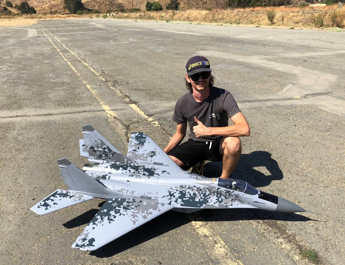

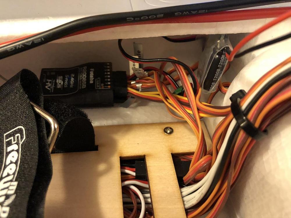

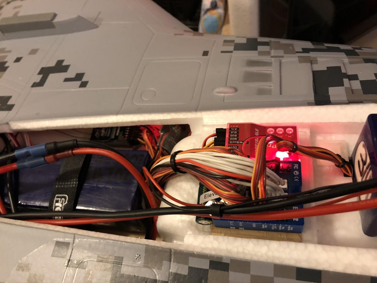

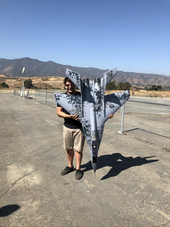

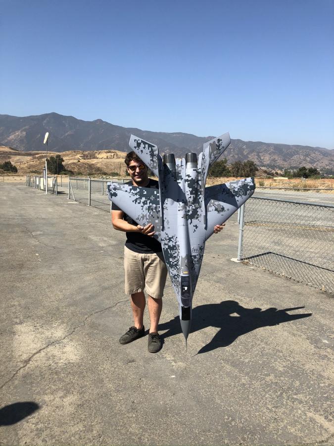

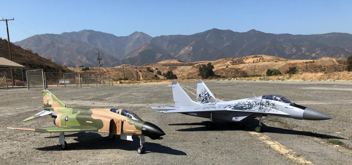

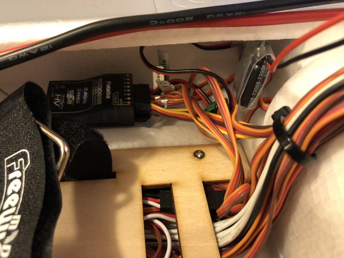

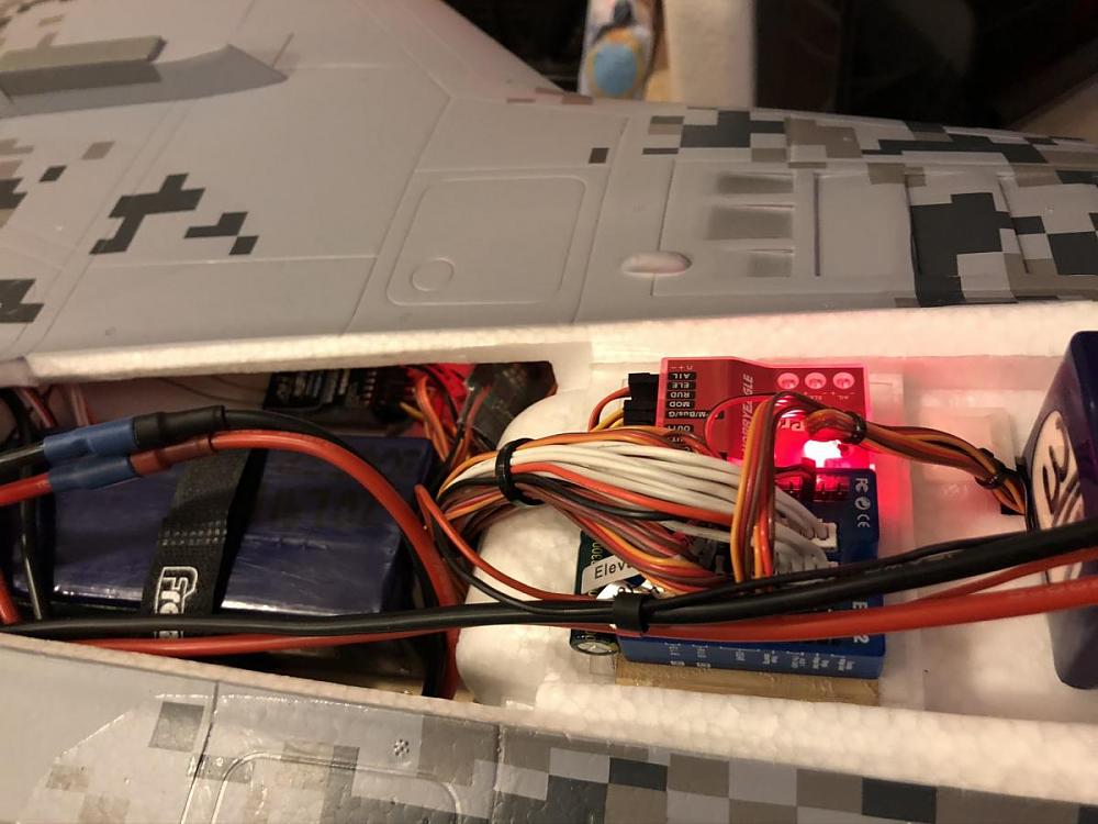

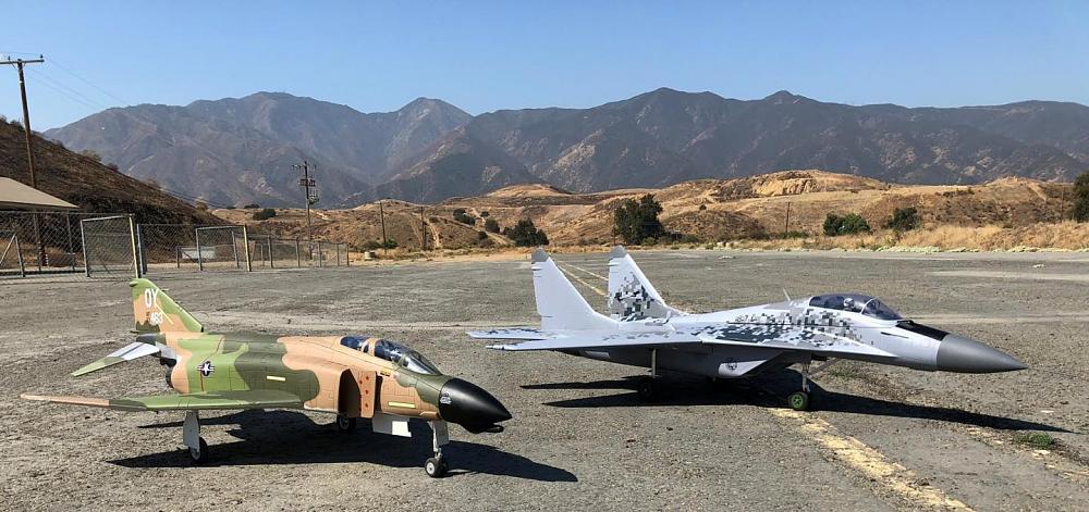

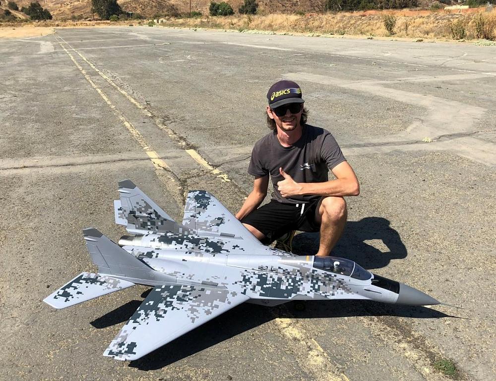

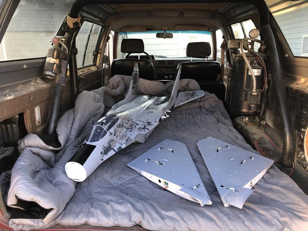

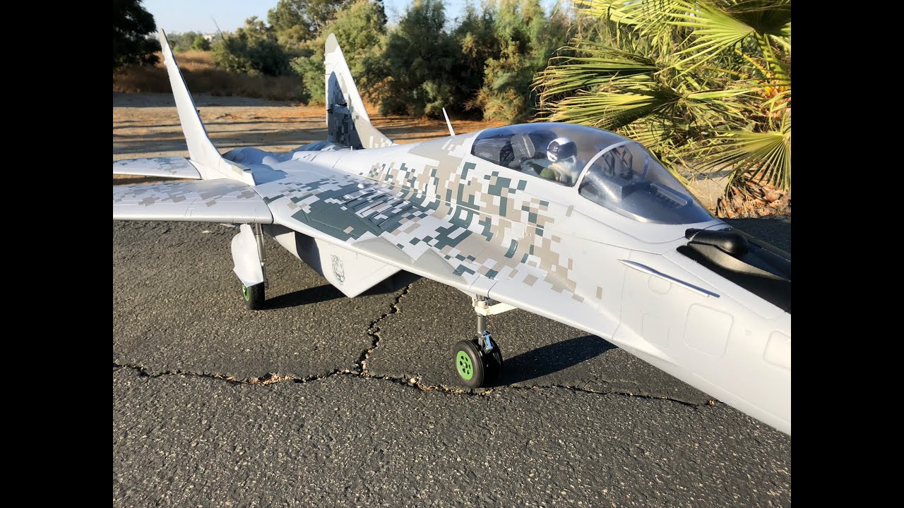

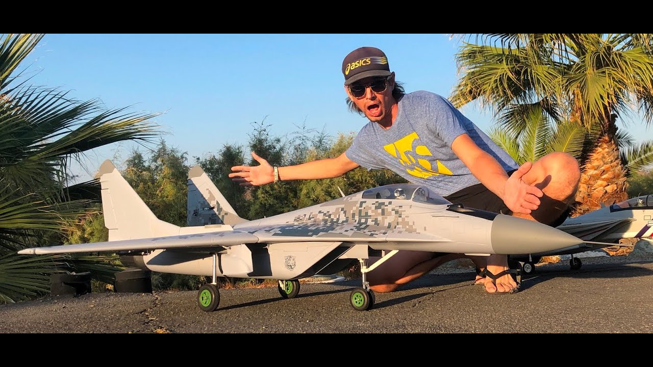

                            Hey pilots! I wanted to share my setup and maiden flight experience from Friday with the new MiG-29. I have mine setup with a Futaba T18SZ radio and HobbyEagle Pro gyro set to gyro off/gyro on/trainer mode. I put the receiver in one of the side caverns and the gyro on top next to the MCB. I made a plastic plate, Foam-Tac'ed it in place, and used 3M tape to stick down the MCB (sideways) and the gyro. With the gryo on top I have easy access to make any changes to it. There's a lot of wiring but it can be tucked away clean once sorted. The build takes 45min but I spent a good 6hrs sorting electronics, setting the gyro, setting throws, checking CG, and double checking it all. James said book rates are fine so... I used book rates and set 30% expo on ailerons/elevator. I set the CG a little nose heavy using 5,000mah CNHL 70C 6S bricks that weigh 1lb 14oz apiece. I added elevator to flap mix for some nose-up trim with flaps deployed. I also added dual-stage main gear doors so they close with gear deployed. It takes a y-harness to do it. More on that with a video later. 😉 Transport of this very large model is easier than the OV-10 Bronco. The wings are small and can be safely stored for transport.
                            Maiden day is always nerve racking. It doesn't matter what plane it is but the giant MiG-29 had me a tad more intimidated. I kept telling myself it's just a giant T-33. 😂 I always take another plane to relax with before I maiden a new jet. I maidened a Night Timber for a pack before the MiG-29 which helped the nerves some. I checked over the MiG's controls, gyro, looked at the control surfaces to make sure they were even across the wing, and did high speed taxi tests. She was hooking bad to the right but after some fiddling I got her tracking straight. I had a friend help with a range check before checking over everything with me especially the gyro even though I flew with it off. I always fly maidens with NO gyro at first to feel the plane better. With fresh packs loaded and the timer set to 4min there was only one thing left to do: send it! I had good confidence in my setup. I now had to put my faith in the plane itself.
                            I stuck it way back on the runway and didn't use any juice to get it there because I wanted to save all the power for the air. No flap takeoff with gyro off and high rates. I throttled up to my usual 30%, got her tracking straight, then gave it the beans. It's a lot of jet to get moving but once it's moving it accelerates very quickly. I left a dust trail behind the plane and used a good portion of pavement but she peeled off the runway nicely, predictably, and I was off climbing into the pattern. It sounded awesome going down the runway! I could tell I needed nose up trim and had my spotter dial it in. The jet tracks very true much like the T-33. The nose does not fall hardly at all with high bank angles. Not wanting to chance any type of stall situation I mostly flew at 50%-75% throttle and WOW was I covering airspace. I could see it just fine and found myself flying much further out than I normally fly my jets. I was gaining altitude very quickly on the throttle. I flew mostly a figure-8 pattern and with a minute to go dropped the gear to start getting a feel for a landing. The plane flies fine with the gear down and with the dual stage door mod looked cleaner with gear down. I told myself I'd take the first approach that looked good and safe. On my second approach I was a bit high and hot but pulled the throttle, pushed the nose down, and pulled it back up over the threshold plopping it down carrying a lot of speed. I kept it out of the dirt with some s-turning bringing it to a stop. The gear on this plane is the beefiest yet on a Freewing model. The tires on both mains and front are very large. The next flight went smoothly after adjusting the top pack back and trimming accordingly. Flaps 1 helped reduce the takeoff roll. I threw some barrel rolls in and was impressed with how quickly this big jet can respond. I stuck the RunCam on and caught some good footage showing how much ground this jet is covering. My packs came off very warm but not dangerously warm. The leads were very warm. This plane is making some serious power. My packs were at 3.75V per cell at 4min of flight time.
                            Overall I am extremely impressed with this Freewing offering. I'm not an 'ace' pilot but found its flight characteristics and landing characteristics to be quite tame and manageable. With that said this is NOT a beginner EDF either. If you're very comfortable with a T-33 or L-39 than the MiG-29 will be very manageable. It's a massive jet and you're strapping 3-4lbs of lithium on board to bore some very large holes in the sky with. It sounds incredible doing a high speed pass. The vertical performance is awesome for a jet of this size. Take your time with the setup. Double and triple check all of it and use good packs. Remember.... it's just a giant T-33. 😆

                              Congrats! Looks brilliant!
                              I would never in a thousand years dare to maiden a freewing jet with a cg more nose heavy than the manual already calls for though, but glad it worked out.

                                Here's the info on the dual stage gear door mod. Cheap and easy. The MCB (blue box) has a port for dual stage doors. All I did was disconnect the main gear door servos from the wing boards, use a y-harness, and run them to the dual stage door port on the MCB. As a result when I lower my gear the doors shut once it's extended. When I retract the gear they open before the struts retract and then close after gear retraction. This is a simple mod that will only cost you a y-harness. It may not be scale but I like the way it works.

                                  Can you show your antenna routing? I’ll be using the same receiver. Actually a 7008SB, but basically the same.

                                    Standing over this massive jet with my fingers on the CG marks it was tipping nose down a little not a lot. The rear most pack can't move hardly at all but the upper pack has some room to adjust the CG. I had set the manuals recommended 1mm of nose up trim. I didn't have to trim a ton and had plenty of elevator authority.

                                      Nice tip on the asynchronous door sequencing, I find the fewer dangly bits the better when flying off grass.

                                          That double stage door setup looks nice. I'm going to have to do that.
