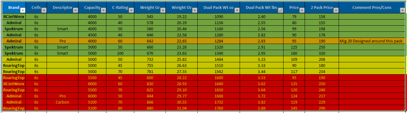

                                • Like to Classic Rock song by Styx - To Much Time on my hands.
                                  How about we discuss Pros/Cons of battery selections for this bird.
                                  (dual battery setup)
                                  Green - Less than 1340 grams / under 3 pounds
                                  Orange - Designated design pack
                                  Yellow - 1464gr - 1562gr range (3 to 3-1/2 lbs)
                                  Red - over 1600gr (3-1/2 lbs +)
                                  Price listed are street price US$
                                  • I'm going with either RoaringTop 5800 or 6250 35C. I fly the 6250 in my T-33 and it works fantastic. I also fly a pair of the 5800s in my A-10 and F-14, 4 mins of flight time, batts always come down fairly cool with 25% left.
                                    RT 5800 35C weight is 780g, 2 packs are 1560g, 2-pack price is $174
                                    RT 6250 35C weight is 803g, 2 packs are 1606g, 2-pack price is $186
                                    • Everyone has their thoughts on batteries but I like the Hobby Star 5200 45C. I have 13 of them in 6S configuration and I think 8 in 2S. Other than using them in my 8S birds, a few 90mm EDFs, my 80mm Avanti, and Top Flight P-47 I use them 12S in planes and helos and regular old 6S in about 25 70, 80, and 90mm EDFs, a ton of airplanes and my 550 helo. They are very light and have good dimensions, very close in size and weight to the Admiral 4000 Pro, some would say exactly the same. And at about half the price of the Admiral when RC Juice has them on sale they are a good value. Down side is they are not the best quality, but value wise I like them and love the flight time. A 6S is 620-640g and add a 2S plus connector adapter and you are still under 880g.
                                      I am thinking about pulling my 8S JF set up from my Avanti and buying a duplicate for the MiG but after the performance of the FW inrunner in my T-33 I'll try it stock first.
                                      Edit, the RT 5800 I have are 765g. My HS 6200 50C are 822g and my E Speed 6200, also from RC Juice, is 760g. I'm planning flying with the 5200...
                                          3 setups that are mentally intriguing are a pair of Admiral 4500 40c's and the Spektrum Smart 5000 50c or 100c. All three under 3 lbs and the nearest to the 4000 Admiral Alpha designed around.
                                          Maybe James will throw in a pair of Admiral 4500's for comparisons while we await aircraft.
                                          Im inclined to go minimum 40c. My mind is all a venn diagram of weight/capacity/C/performance/price
