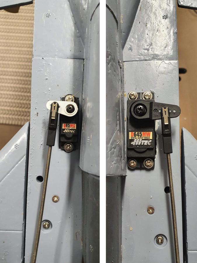

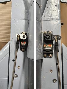

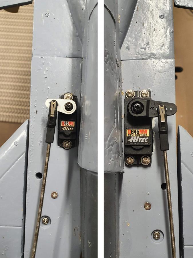

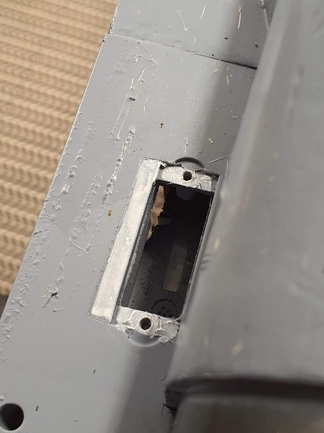

                        Honestly I'd just put a proper sized servo in there. The modification isnt exactly radical (see photo). I've carved more foam from a 3S warbird. Similar torque without running at the ragged edge of what the servo can handle and powered from the BEC like a normal plane should be. Beefy servo horn included. And almost half the price of a botique mini...

                          I already have a set of 160 so will be using those. 11.5 kg/cm @ 8.4
