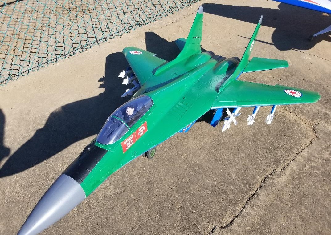

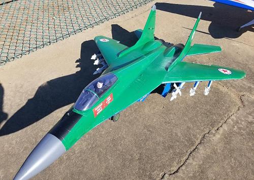

                            I finally got decals on the ordnance, and so Laughing Kim Jong Un went in search of enemies today (my flights up until now had been without missiles). However, when I got to the field, a friend told me that when he added missiles, the plane experienced a huge upward change in trim, and took off dangerously steeply. He had an adventure clicking in enough down trim to stabilize it. So I chickened out and removed the ordnance before flight. But I'm curious, did anybody else have this experience? I had not seen it mentioned on this forum, but maybe missed it.
                            I think I have flown the A-10 with and without missiles and didn't notice a difference. But I also notice, some of the foam missiles can be a little warped. So I wonder if it depends on the particular set you have. If there is a missile with a large tail surface and it curves upward or downward at the back end, perhaps that could change the plane trim...? I don't know. Another possibility is that he just did something different that particular flight (like battery placement inadvertently off) and the missiles had nothing do to with it. Anyway, maybe next time I'll try adding missiles 2 at a time on each flight. Today I didn't fly with them at all.

                            • GliderGuy
                              • 1408
                              #3614
                              Originally posted by Gringotuerto
                              I But I'm curious, did anybody else have this experience? I had not seen it mentioned on this forum, but maybe missed it.
                              I've always flown with all the missiles. I suggest checking the CG with and without the missiles and anticipate any trim changes accordingly. With a full missile loadout plus reflex flaps...and some small amount of weight added to the underside of the rear fuselage area, I balance 15 mm aft of the CG mark (gear down) and carry about 1 to 2 mm of trim below the fuselage line vs the manual 4 mm below.

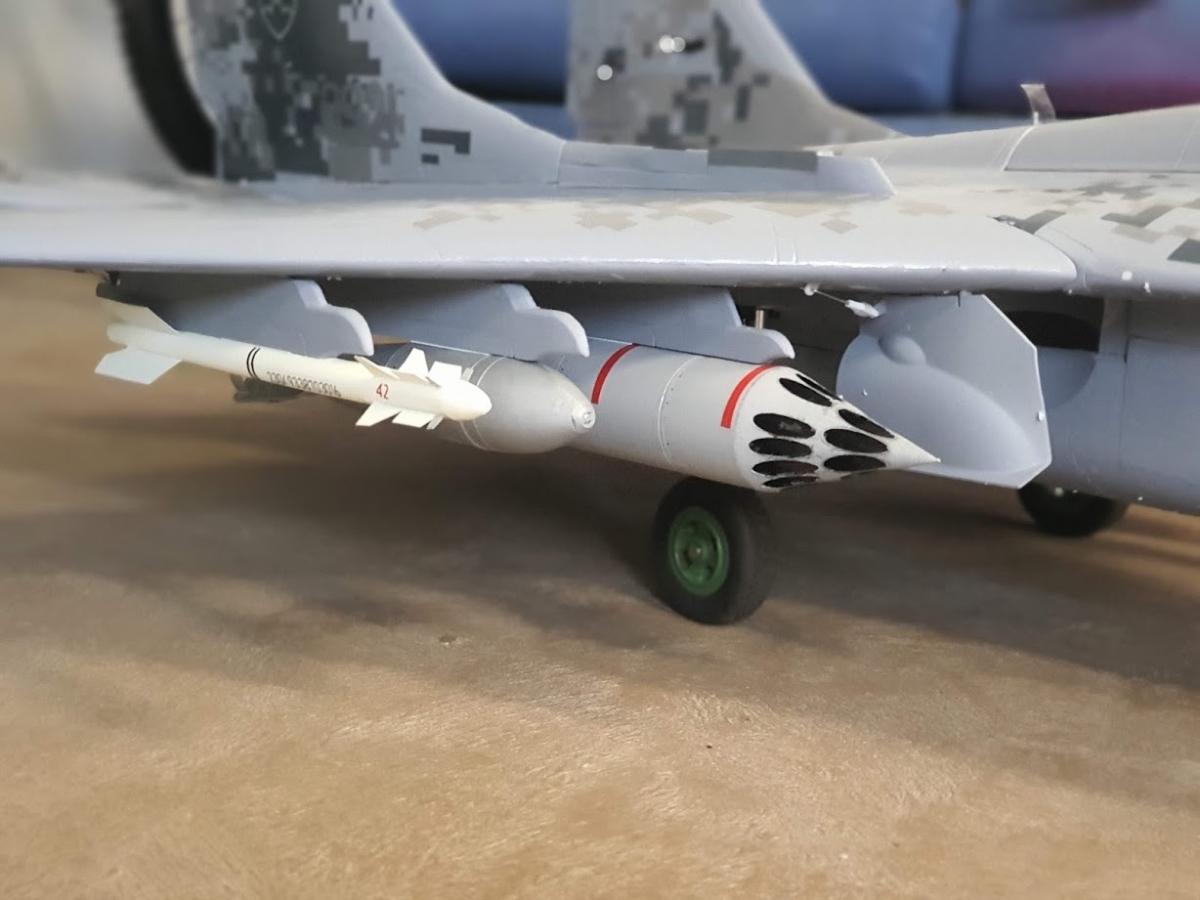

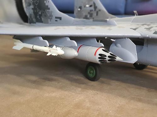

                                  #3616
                                  I dont notice any perceivable impact on trim but the air to ground loadout sure puts the brakes on. Perhaps your colleague experienced a higher takeoff distance than usual and horsed it off the ground? Once this thing gets its nose pointed up it stays there on climb out.
