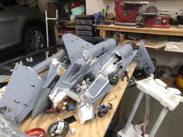

              I have had about 30+ flights on my Mig 29 and yesterday was my last. I have done Humpty Bump turnarounds on almost all my flights with the Mig. Yesterday the plane lost elevator authority on the downward portion of the maneuver and just spiraled to the ground. It looked like a stall however the nose was pointing down and the throttle was only 10-20 percent, if that. Pulling the elevator resulted in no change in the pitch. Both servos for the stabs were working when I put it through post mortem. I have never stalled coming out of a Humpty Bump with any plane. I suspect there is something with the Mig 29 design that makes the stab control not functional in certain conditions based on all the reports from flyers. This a wonderful jet to fly and I will probably replace it if we get any information about design changes or fixes for the horizontal stabilizer.

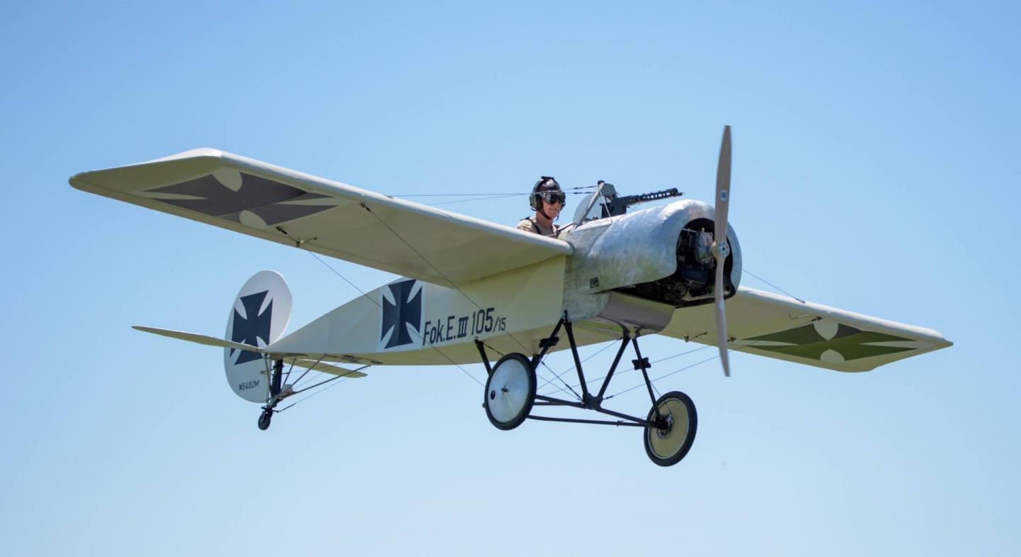

                          Knowing this saved my life.....literally! I got into a wind shear induced stall at 500 ft AGL and the plane I was flying in went into a spin. Only by moving the stick immediately to the forward position to unstall the wing (holding opposite rudder, too) allowed the spin to stop and I recovered with about 10 ft of altitude. Whew!
                          -GG
                          Same here. My replica Fokker E-III stalled and started into a spin at 500 AGL. I managed to recover above 100 feet. Click image for larger version
