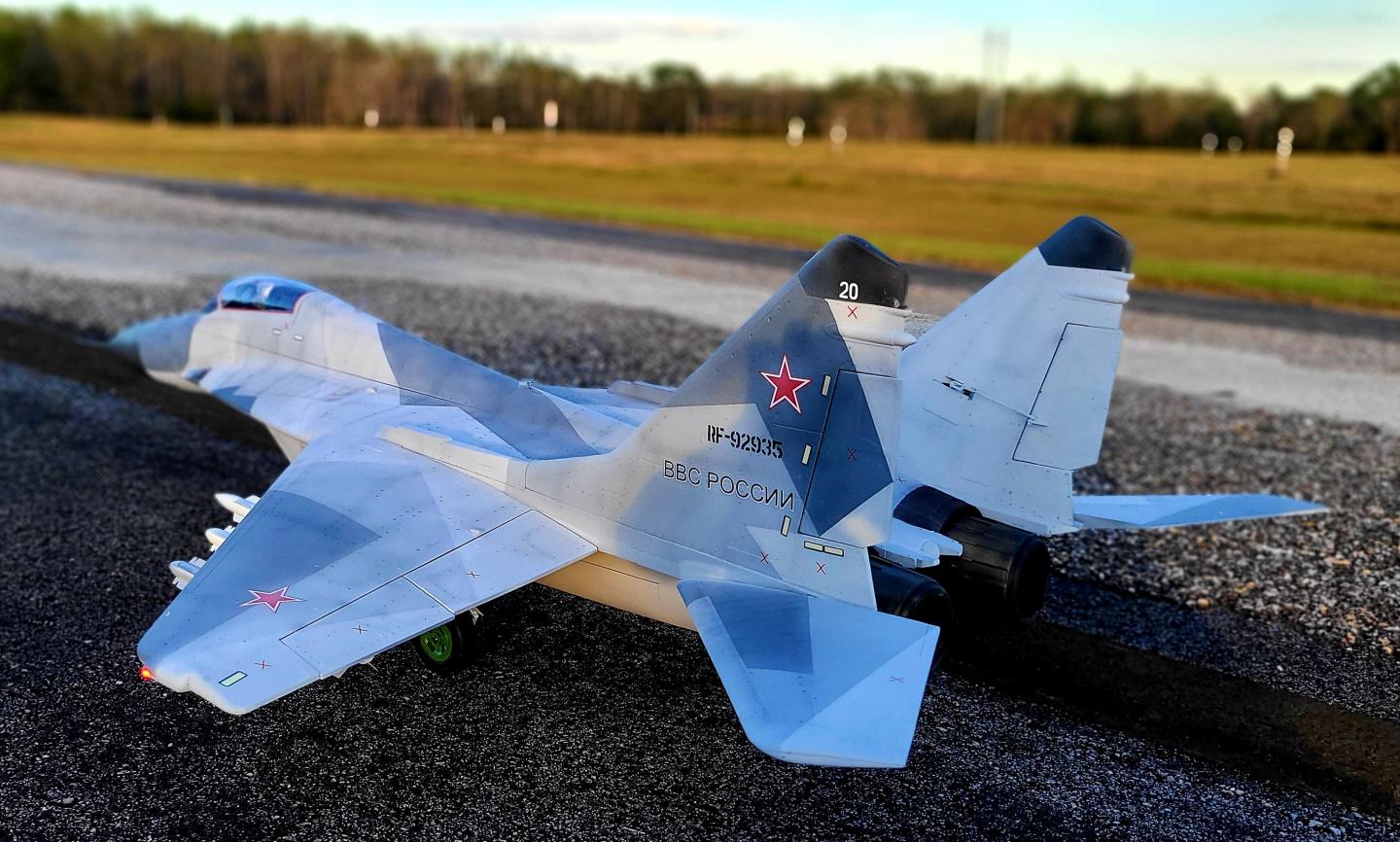

                            Re-maidened mine over the weekend after my re-paint. Moved the CG back to 165mm and I won't be looking back.

                              Congratz, that's a sick & really nice scheme :ok_hand:

                                  Love that scheme!

                                    Superb, you're a real artist! :clap:
