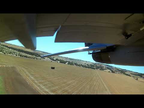

    Thanks. A clear correlation of elevators bending downwards when the flaps are deployed, easily spottable by tracking the outer tip of the elevator. It doesn't look too bad, though.
    I still wonder how to best reinforce the fuselage tail that carries the elevator (thanks to the other posters who showed their improvements), and if the elevator itself should get a bit of reinforcement with thin carbon fibre strips. The other improvements, namely better servos, better pushrods, shorter and thicker servo wires, bypassing of the blue box for the tail surfaces and a slightly higher voltage are all done.

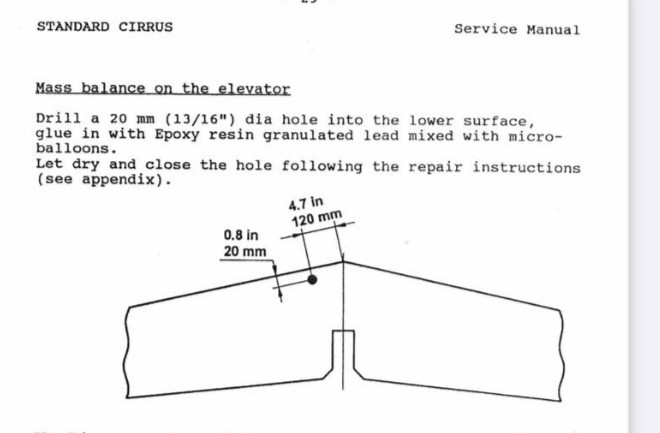

        Mass balance of a FFS is critical in determining flutter chacteristics of a FFS. Unless you know what you are doing, CAUTION CAUTION. A fluttering FFS is much worse than the small amount of flex shown in the video.
        Youtube has several FFS flutter videos, and the planes eat dirt thereafter. Flutter = loss of control and/or parts leaving the aircraft!
        If you are experienced with FFS flutter and know how to mass balance after adding material to the FFS, would you share how to do it?

                        Edit: Adding a snip from a Standard Cirrus POH about how and where to add weight after a repair and repainting of the FFS to ensure mass balance is maintained....to avoid changing the flutter characteristics.

                                Check this video by Mshagg again. Minute 1:00
                                Watch carefully and replay a few times if need be. When flaps are lowered not only stabs deform, the whole fuselage / vertical stabs bloc is shifting down. From this angle you don't really appreciate it as torsion... but it is mostly torsion of the entire thing. Some flex too, but mostly torsion IMO.
                                And that's the reaction to stabs that are deformed (thus they produce less force than if they were keeping shape) plus being flown at low speeds. Add stab rigidity and speed and picture that deformation again, but increased tenfold.
