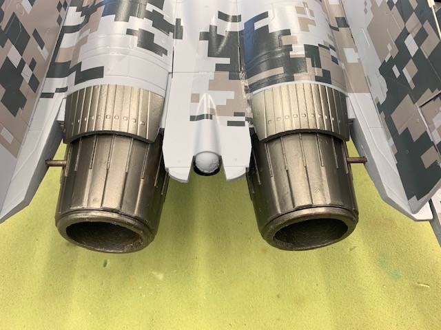

                          For the exhaust nozzle touch ups, I got a close match by mixing the following in the approx ratios. You will need to eyeball it:
                          TIMIYA TS-29 / 90% / semi gloss black
                          TIMIYA TS-30 / 15% / silver leaf
                          TIMIYA AS-14 / 5% / olive green (USAF)
                          If anyone has an exact match, please post.
                          -GG
                          I’ve touched up my nozzles (they came missing some spots of paint out of the box) with Tamiya Gunmetal X-10 which was recommended by Alpha and I’ve found it to be an exact match.

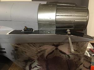

                              Looking at the base of the vertical stabs and tips of the rudder photo published later by Fred....not seeing much housing / structure deformation. Mainly FFS deformation. That’s why I added CF only to the bottom to stave off rectangular box / foam glue joint separation.

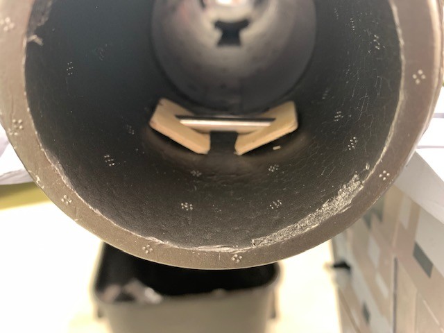

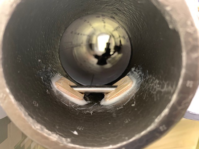

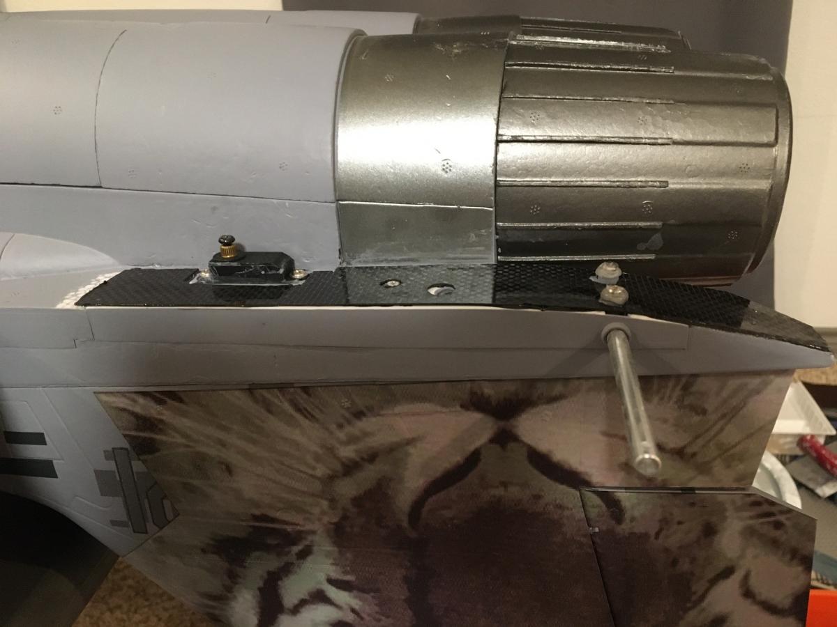

                                My buddy Keith (Yellowbird911) and I working on K-45 turbine conversion have upgraded out stab mounts using this method and it stops the flexing and twisting of the stab mounts. Used 6mm aluminum rods 190mm long to anchor the stab pivot rod into the nozzle using E6000 glue. I found the RustO spray dark bronz metalic to be a close match for the nozzle color. The Tamiya X-10 Gunmetal matches the silver covers forward of the nozzles.

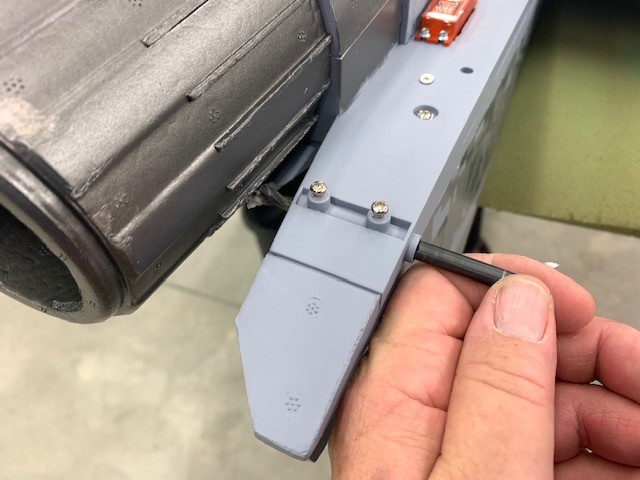

                                  Reinforced the elevator mounting area on my mig. Used 1/32 ply on the inner and out sides and also the bottom. Sanded and used 30 min epoxy. Also upgraded the servos to promodeler 150 oz. torque servos, yes servos are a little pricey but better for my piece of mind.

                                    Looks good Jet Jocky. Watch the FFS root to support clearance with the 1/32 ply being there. You may consider adding a flat washer spacer.
                                    As the FFS bends down under high loads (especially flaps down high speed) that gap may close and jam any servo motion.

                                        Thanks for sharing the pictures. How happy are you with the result? Do you get a significant reduction in bending / torsion? I'd sure hope so.
