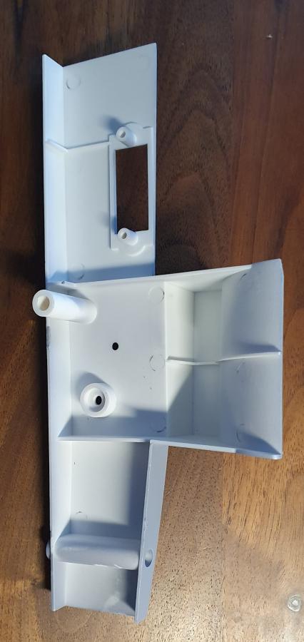

          This is your MiG's tail, and it is not what it should be
          Hello there,
          I bought some spare parts. This video shows what they call a structural part.
          Nice flex! As you can see, the mount for the elevator axis lies in a U-shaped plastic piece. The piece is made of very thin and weak plastic, the wall thickness is maybe 1mm. In the section with the axis mount, it contains no structural reinforcements such as ribs. It can be easily bent with a little pressure of the hand. An axis put into it can easily be deflected by 10+ degrees, in particularly down. It is resisting an upward angle of the axis a bit better than an downward angle.
          Yeah, in the full aircraft, the piece is filled with foam. But only a little bit of deformation of the piece already results in much changed position of the elevator axis and the elevator itself.
          In my opinion, this piece needs to be replaced or seriously strenghtened. Time for an upgrade, MotionRC!

              Before any conclusions can be drawn from your demonstration, I think you should do the same deflection of that part when it's on the plane. It's not a fair test to take that piece all by its lonesome and twist away at it. I've seen a few pieces in real life where it'll warp like wet timber but fill it with something and glue it in place and nothing's going to move. Besides, in this case, you might want it to bend a little bit. Like they say about a tree - better to bend than to break.
              But if we're going to go screaming through the streets, "The sky is falling", how about we demand Motion make retracts that can take a good smack? Or do we have to reinforce them like so many have done with nose retract struts and even main retracts by epoxy-ing support braces in the foam (eg. Freewing F-14)? But you know what? I think I can handle it before the price of the plane jumps by another $300.00.

                Your plane's price won't go up by $300 if that "structural" part would have actually been done right, with maybe 10 grams more of plastic and and a grid of reinforcement ribs so that it would actually do what it is intended for - *safely* holding the most important control surface of a 6kg 200km/h missile...
                  #3028
                  On my plane it is rock solid...

                              The video is a fooler. Study it closely. Watch the bottom of the vertical stab....no deformation of the tail structure.
                              I’m still gonna add some 0.5 mm sheet CF to the sides and bottom back there but only to harden it against fatigue and/or glue joint separation.
                              What is shown in the video is the FFS bending down.

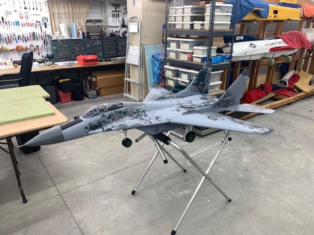

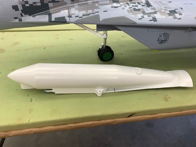

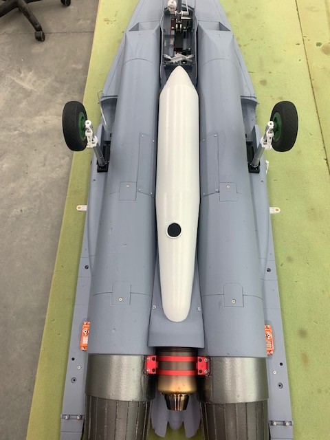

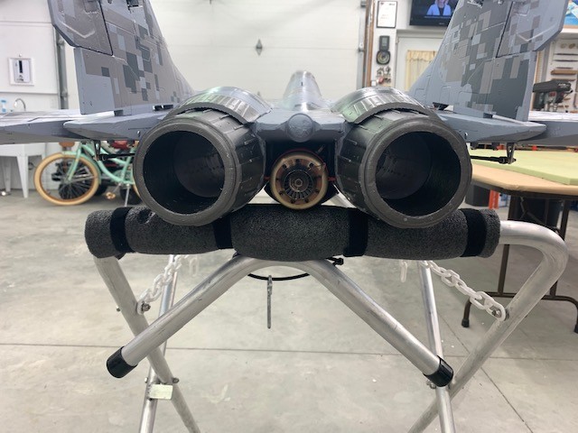

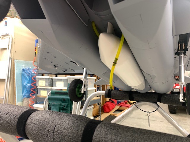

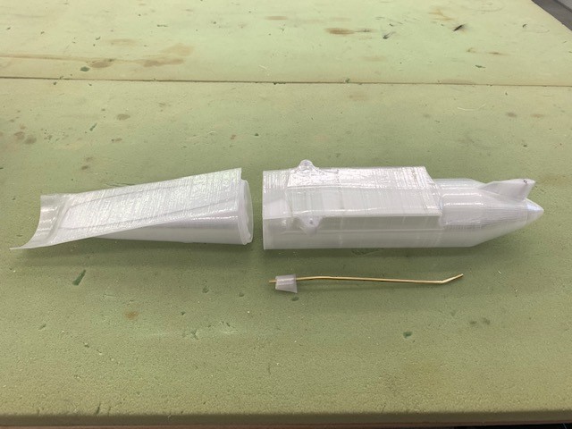

                                    Getting close to finishing the turbine conversion with K-45 and 3D printed CL tank. Initial calculations look good for weight and CG of about 13.5lbs TO weight and -15mm from factory. Here are a few happy snaps of the tank and turbine mounting so far.

                                      Anyway Im designing a brace people can print if the combination of fred's crash video and HK's manipulation of the plastic in question concerns them. I'll post it up on thingiverse when done.

                                          I'm with Double G, the elevator is twisting and, if I had to guess, the vertical fins are being pulled outward by a change in air pressure due to flaps being deployed beyond VFE Granted the plastic U channel is allowing some flexing in the fuselage. The Chinese CAD operators haven't learned that an equaleteral triangle is is the simplest and strongest structure. They design some drone frames this way. If your not an engineer using a rectangle shape instead of a triangle shape probably looks just fine on a monitor.
