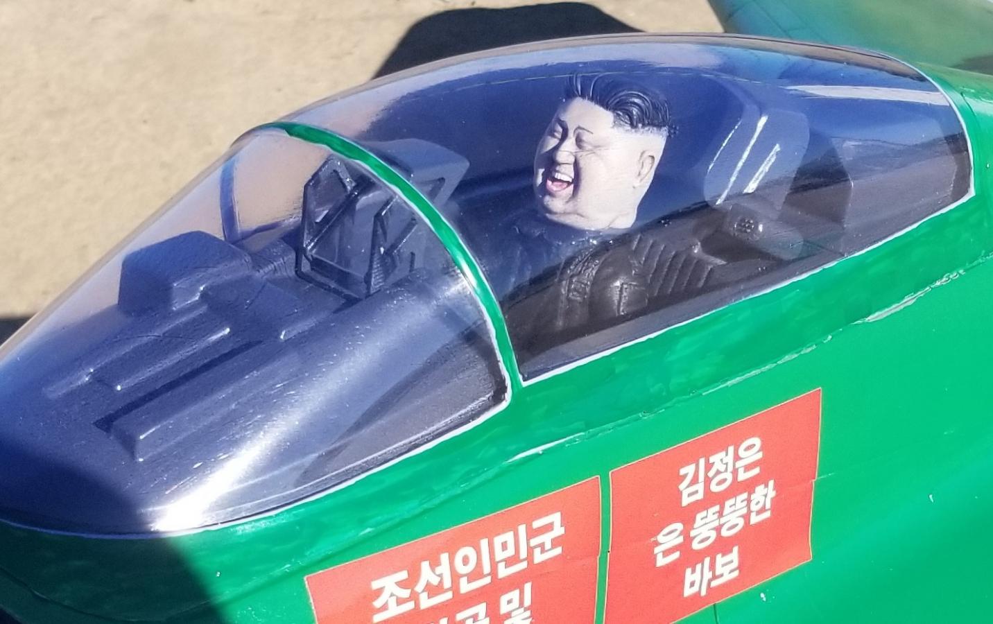

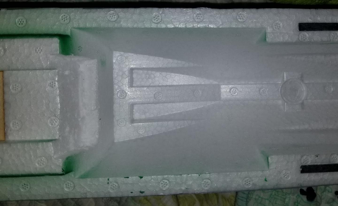

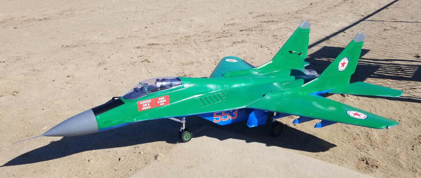

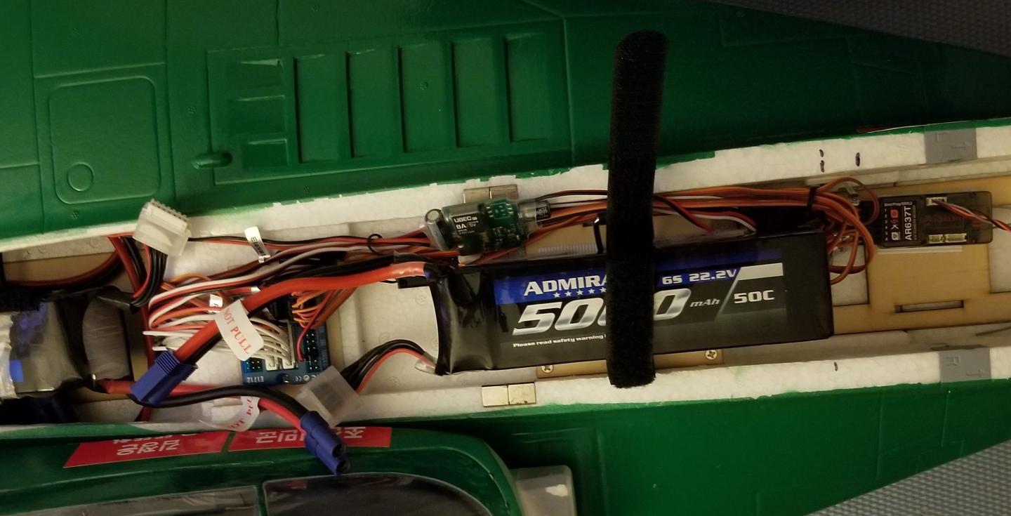

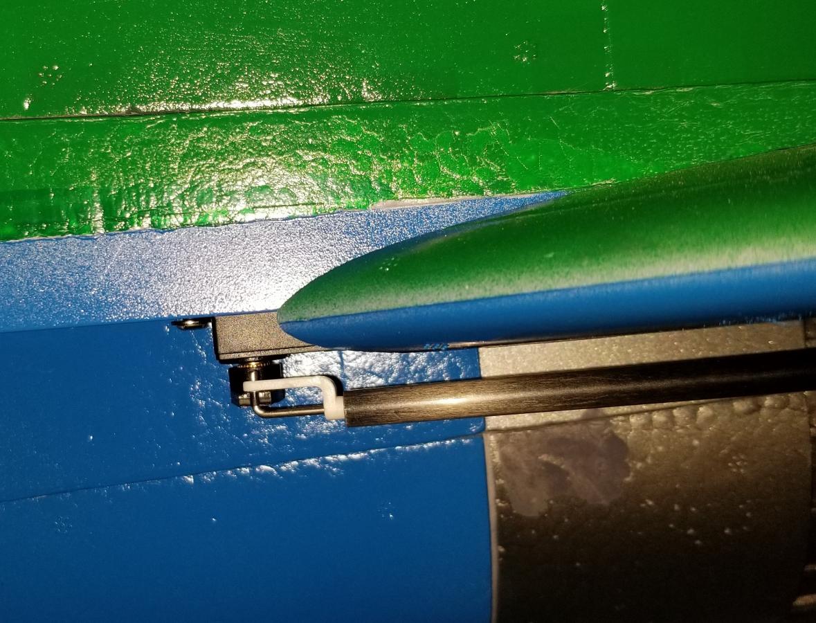

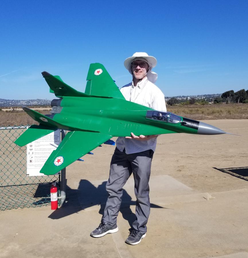

        Our Dear Leader “Laughing Kim” finally took to the skies! The battery position and ending elevator trim are shown in the photos. Elevator “up” is similar to that shown in the manual, even though CG was 5-10mm aft of the mark. Batteries were Admiral 6S 5000mAh, 732g each. Canopy interior was carved out as shown to make room for the front battery.
        Throws on A,E,R,F were similar to the first row in the manual (low-rates), except my aileron throw was even lower, at 32.5mm vs. the manual’s 38mm. This was sufficient to do a lazy roll. Expo was 32% on everything.
        Overall the flights were uneventful. It flies and lands very easily. This is my first delta-wing, and I did notice that it “slides” a bit in turns. And the low moment of inertial about the roll axis is noticeable, although with my low aileron throws it was far from being “twitchy.” I guess it could be quite a corkscrew at high speeds and high throws.
        I did not notice trim change with flap, but only used mid-flap (about 22mm). It floated a lot more than I expected on landing. Anyway, maybe next time I’ll get a little crazier, but today I was happy to just get it trimmed out and back home with my man Kim still smiling .
        Oh, and of course the Dear Leader shot down 387 enemy planes. Then he landed, and after lunch designed a bridge, then attended the performance of an opera he composed. Long live Laughing Kim!

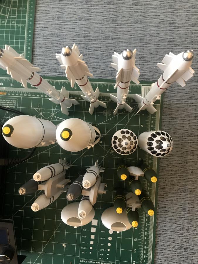

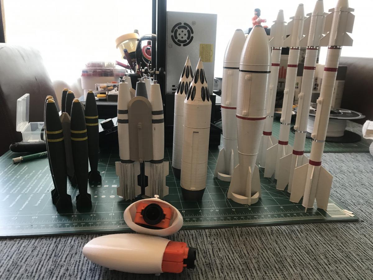

                                    I’m getting ready for it , 3D printer spitting out ordinance one after one, much to choose ... paint ready,decals ready,afterburners ready ,i’m ready too!

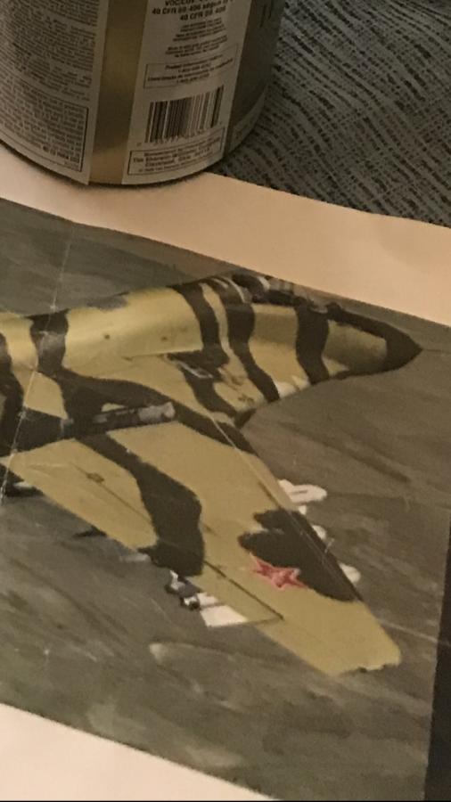

                                        Thanks guy’s for liking the post, here a little pic of what will be . I think will be look ok , going russian scheme ..
