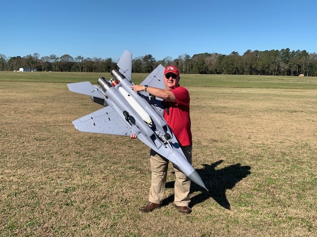

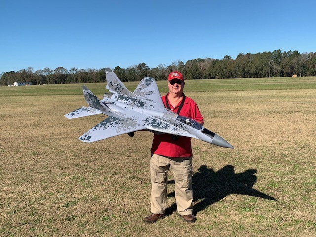

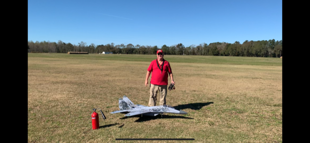

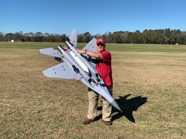

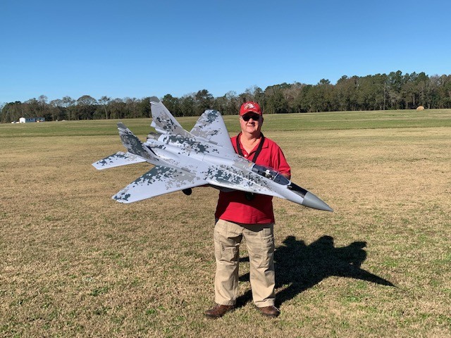

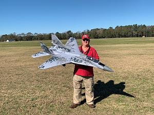

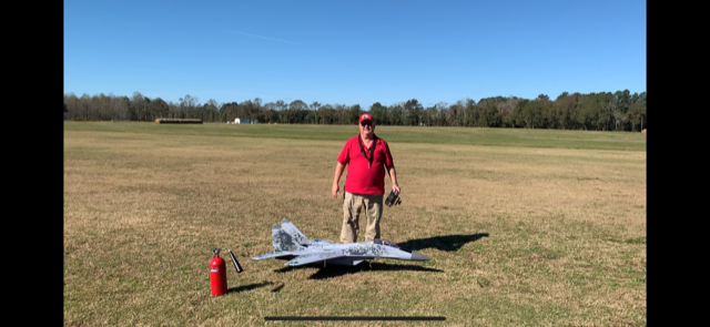

                  I flew my Mig-29 again today. It flies great. I think is the best FW jet I have flown, I think is is better than the Avanti for me. Its really a blast to fly. I like it better because it is bigger and presents well when flying.
                  I moved the CG back to 160mm and have 3mm reflex on flaps and ailerons. With the CG back to 160mm it flies even better now. Take off rotation is very smooth and the airborne CG check with 45 degree upline and roll to inverted showed a very gentle pitch to the canopy, much better than before. Landings are very easy and I can get a very long full flare with touchdown on the mains with nose wheel in the air. I really think the trick is to get the CG back far enough plus the reflex really helps get the trim setting more near the stab neutral. My trim setting is shown with the LE of the stab about 3/8" above the bottom of the fuse edge. Also I think the stock and replacement stab servos are no where near strong enough and need to be upgraded.
                  Its really a great airframe.

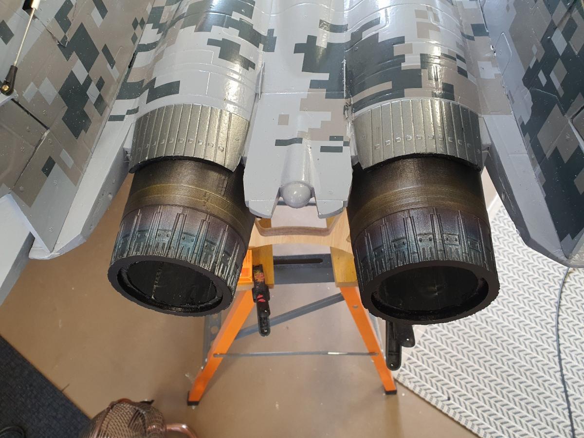

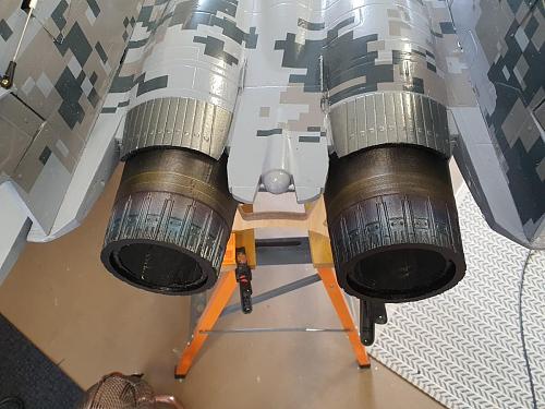

                              Someone on RCG posted some 3DP nozzles. Clever design that fits over the stock foam so no chance of disrupting the thrust line. A welcome modification as mine were looking a little worse for wear after an unplanned belly landing and tail sitting between flights.

                                xviper, mine is a turbine converson and I moved everything. However, that doesn't matter. The CG needs to be 15-20mm aft of the marks to make this thing fly correctly. I first flew it at 15 mm aft of the mark and it was ok but still nose heavy and now I have moved the CG back to 160 mm. If I was flying it as an EDF I would put weight under the speed brake or nozzles till I got it right. The jet will fly just fine and the extra weight needed to get the CG correct will not be noticed. In fact, I bet it will feel lighter and fly much better.
                                I don't really know how the reflex works, but it does improve the trim setting on the stab. I assume it de-cambers the wing and makes less drag. That along with the CG closer to the neutral point makes this a really fun plane to fly and land. My landings were much easier to flare and touch down on the mains than before. I can't even image how poor it would land if the CG was at 140-150 mm. I didn't even try there based on all the reports in the forums. IMO is really a good airframe and properly balanced it flies great. I have a pitot tube for indicated airspeed. My normal speeds are 60-80 mph and rarely exceed 100 in a dive with reduced thrust. I use flight modes trimmed for half flaps and full flaps and normally am flying final approach around 40-45mph. Touch down is 30-35mph. I have not flown fast with flaps extended and don't plan to.
                                Get it balanced right and you will love the way it flies.

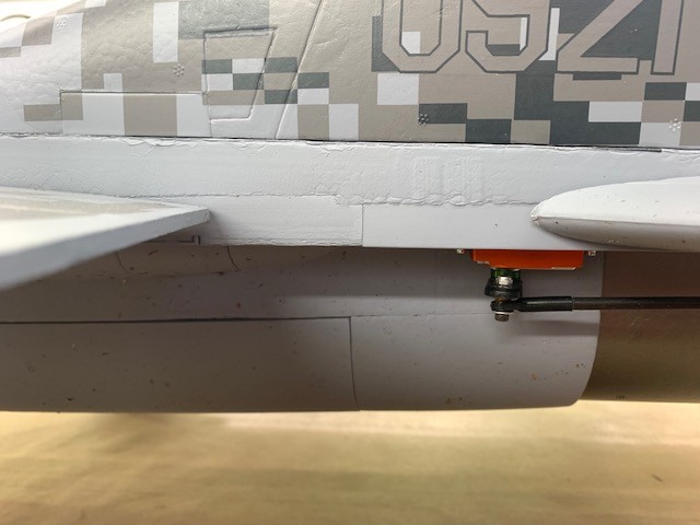

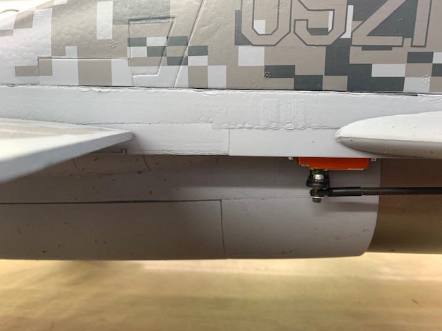

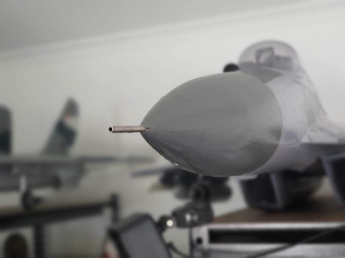

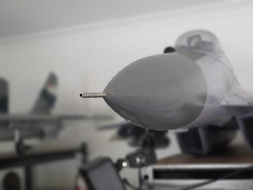

                                      Hey gg - just installed a pitot tube for this exact purpose, also to try and get a sense of 'safe' airspeeds for flap deployment. Hoping to get out to the field on Wednesday PM to give it a try.

                                        Excellent!!

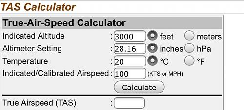

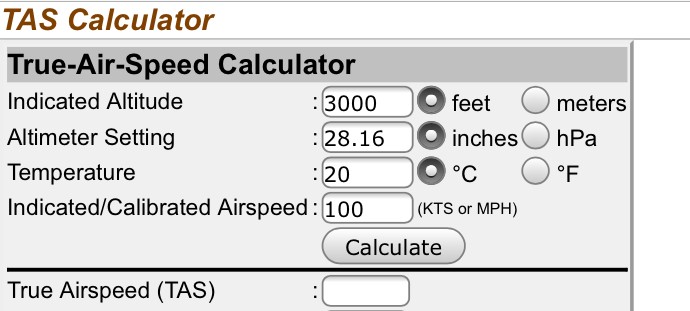

                                        Can you call a local airport or station (or check via Internet) and obtain the data needed to calculate TAS when you fly? Thanks!

                                          There is a RAAF base and bureau of meteorology weather site in the area so that shouldnt be a problem.
