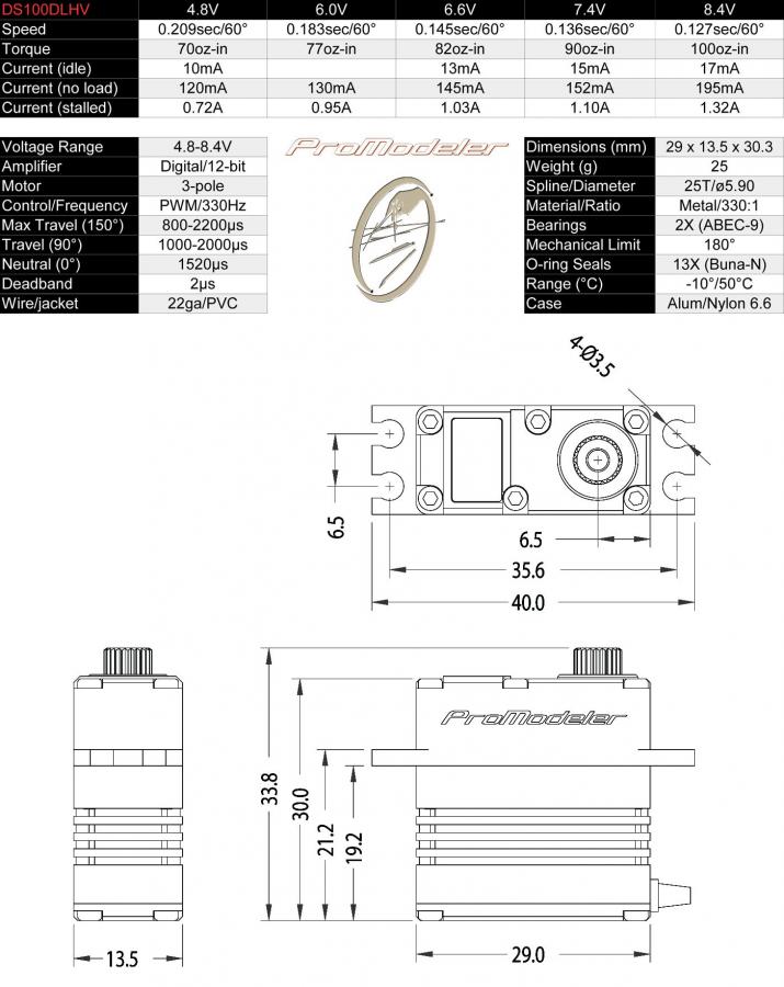

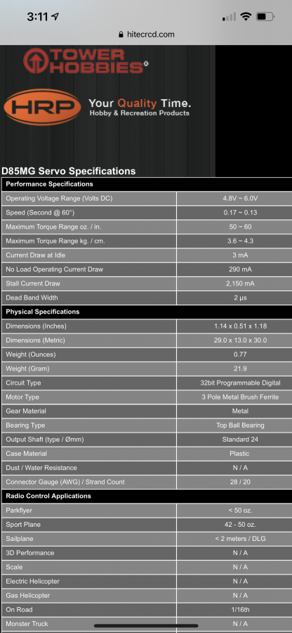

                            That’s interesting as the promodeler claims higher torque (70oz@4.8v) than the hitec d85mg(50oz@4.8v). 🤔
                                Who knows.... I don't know why and all I can say is that there are many variables.
