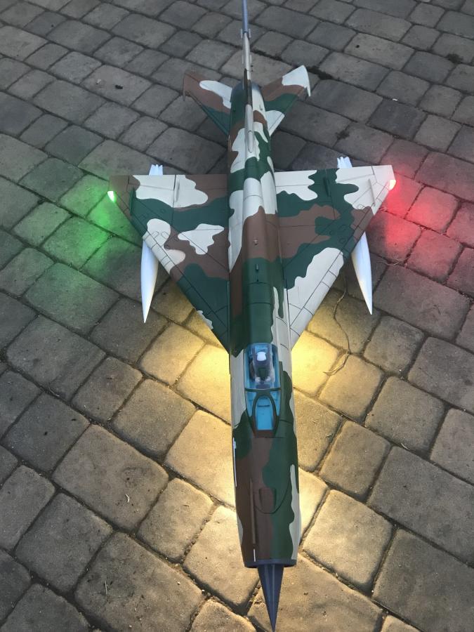

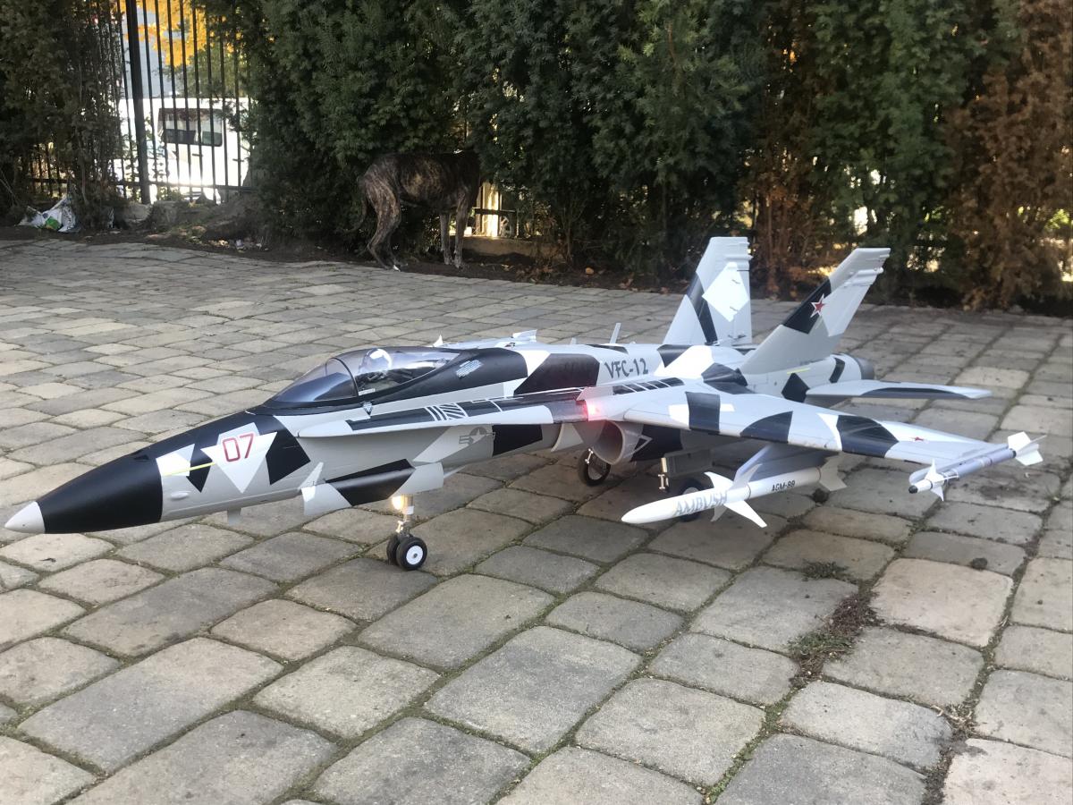

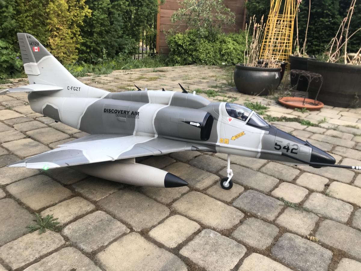

      FOR WHAT SO EVER REASON I WANT TO UNSUBSCRIBE FOR THE HOBBYSQUAWK... i send 3 email to them and no one replay back ...
      really guy’s ???
      Anyone out there know how to unsubscribe from this channel , please?
      Apologies in advance to disturbing you folks.
      I’m still flying and loving the rc more then ever.
      Ps: i try so hard to be part of motion but eventually i must have salame slices on my eyes thinking my planes looks good .. obviously not , which i’ll work harder to make it better , need little time and more experience. Hey , i try it , can’t get mad on it right?
      Wish to all of you a better new year , lot of new planes and more fun then ever .
      And here just few ... don’t get me wrong , i really love motion and always i will ( that’s why i’m not fly HH ) !

                                          Don't leave, you have some awesome looking planes there. Sorry if you are having issues. You can always PM me if you need anything. Tim
