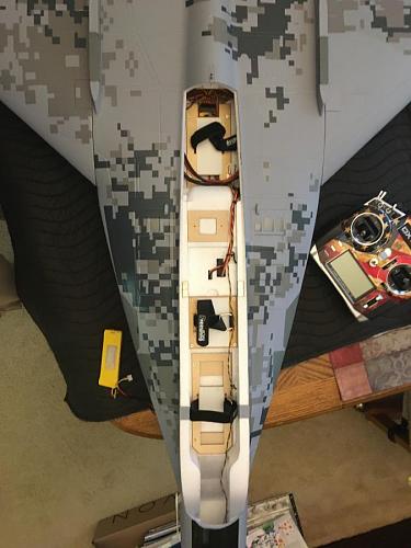

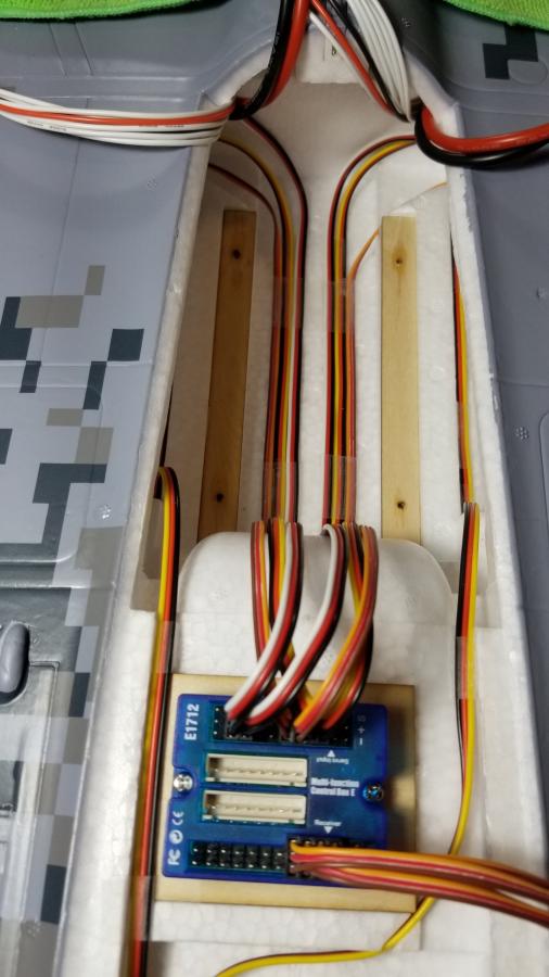

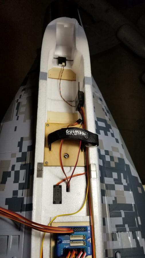

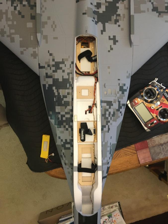

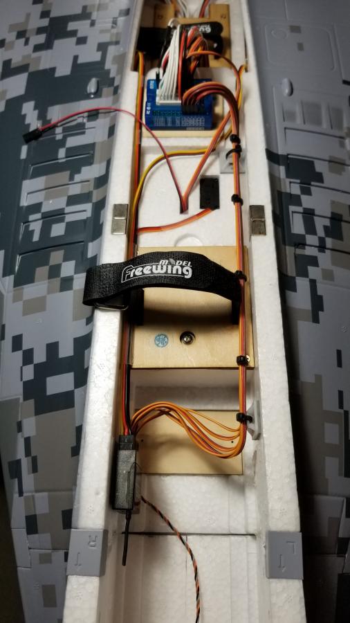

                            My crazy OCD wiring is getting close to being finalized. For the guys running the Admiral Carbon 5100's, where are you finding battery placement for CG? Seems I'm having to hog out some foam from the canopy for the forward battery just to get it to close. Any tips would be greatly appreciated.
                              • 5387
                              #3214
                              At 866g each you'll need them both as far back as possible and need to add weight to the rear. I see you have the MCBe and receiver forward, Move them back. Shorten the battery wires. Do as much as you can to remove weight forward.
                              And clean up that battery area!
                                I had to carve out about 1/2 in of the canopy (i.e. right behind the pilot) to make CG with my 5000's, but those are only 732g. Yours are 866g, so you shouldn't be hitting the back of the canopy (unless you added weight around the elevator area). Do you mean the battery is so wide that it is hitting the sides? I can see how that could happen, I feel like my 5000's barely fit, and they are significantly smaller in profile:
                                Admiral 6000 – WxH = 53 x 45mm; 844g
                                Admiral 5100 - WxH = 55.5 x 50mm; 866g
                                Admiral 5000 – WxH = 46 x 44mm; 732g
                                I notice the 5100's are even wider than the 6000's. Make sure you try it both ways (WxH and HxW). I found mine closes better if I align them one way vs the other. Also the way my wires are set up the BEC is next to the battery, so that is taking up some space. With 5100s seems like your BEC has to be in front or or behind the battery, it can't fit next to the battery - I assume you are aleady doing that, or it wouldn't fit at all.
                                Your wires look very well organized!

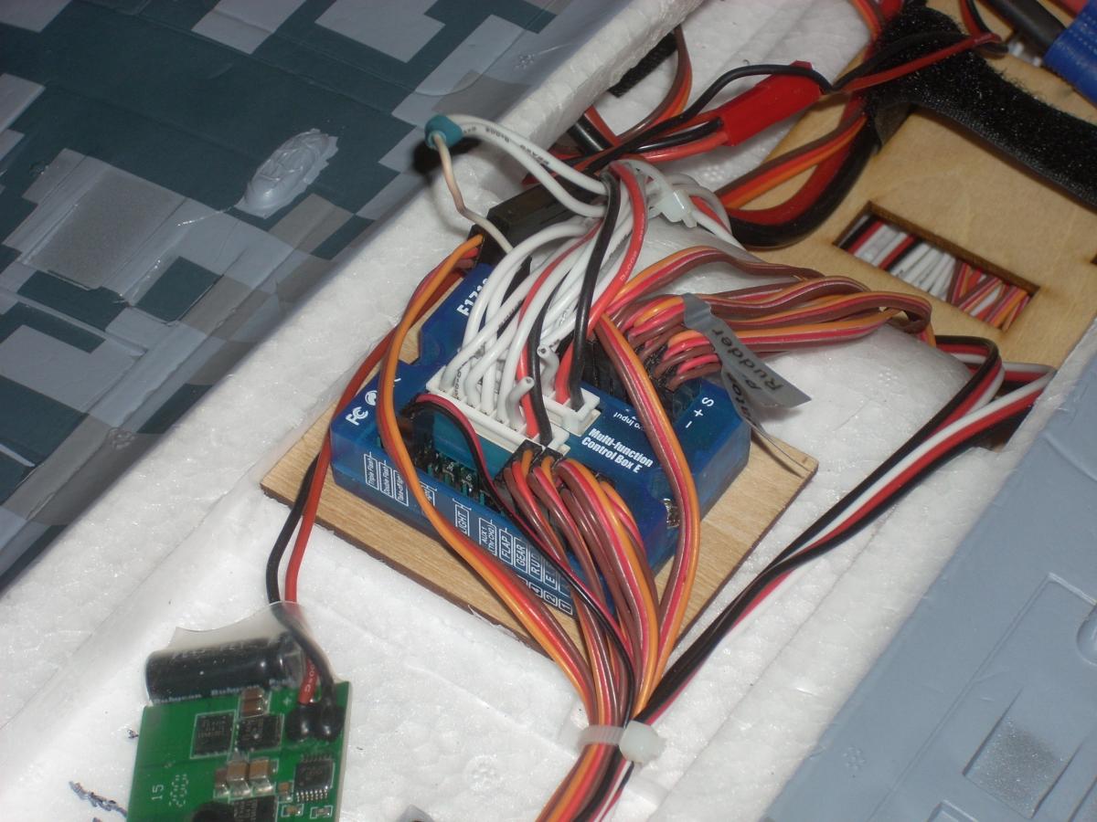

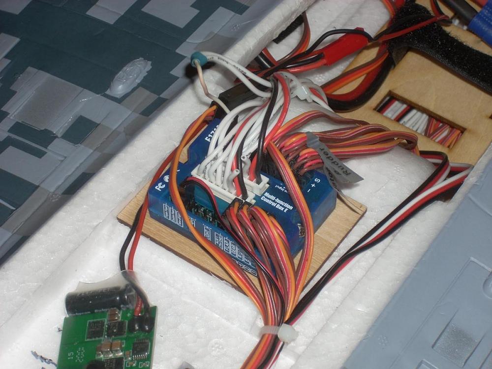

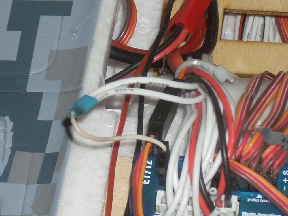

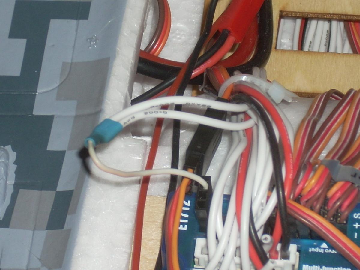

                                  For those trying to put your gear doors on the dual stage plug so they close after deploying the gear, here's how I did mine. Cut the first white wire on the ribbon cables next to the red and black wires, then solder them together on a spare servo connector. Then plug the connector into the dual stage door slot on the blue box. Make sure you use one of the outer wires on the servo plug so that you have signal going to signal. The red and black wires on the ribbon cable still provide power to the door servos, so you only need to reroute the signal wires.
                                  Cut the first white wires on the ribbon cable next to the red/black wires.
                                  Solder the two white wires to a spare servo plug and plug into the dual stage door slot on the BB.

                                    Why do you have to cut and solder any wires? All you should have to do is move the door servo connector from single stage to double stage on the back side of the wing control board. The MCB controls double stage function to that set of pins just like it does for single stage. Nobody is having to cut and solder wires to make SS work... Granted, you are accomplishing the same end result but in an unnecessary way.
                                      #3218
                                      Steve,
                                      Had I known it was as simple as moving the plug on the back of the wing connector board, I would have done that instead. Do we know for sure that this works?
                                        • 5387
                                        #3219
                                        Since the MiG door servos are in the wings the connection is through the ribbon cables. There is no plug in the single action to move on this plane.
                                        • John Bergsmith
                                          • Mar 2019
                                          • 189
                                          • Concord, NC
                                          #3220
                                          Steve,
                                          That’s how Brent got it done.
