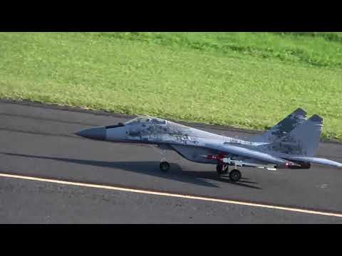

    Today was maiden day for my MiG, video coming soon, did 3 flights in less than perfect conditions, cross wind @ 15mph.
    First thing to mention is the CG, I decided to go further back than recommended, about one finger width back from the marks. Checked the CG in the air with gear up and down, inverted flight required a fair amount of down elevator.
    Also did a stall test, full up elevator until almost zero forward speed, finally the nose just drop straight down, kept the elevator at full up and added some throttle and it kept flying. Loops can be tight, it almost loop at length of the fuselage.
    The MiG is set up with tailerons and ailerons and slow rolls looked great. Landing were a bit tough because of the cross wind but the MiG handled it like a champ.
    For the next flights I will be moving the CG further back.

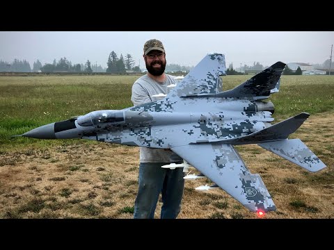

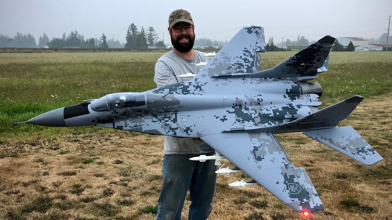

                    Check out my Mig29 Maiden!
                    Your take off roll was like a "wandering minstrel" but yours is not the only one I've seen do that. High rates on rudder? No expo?
                      High rates, TOOOOO much expo! Second flight was flawless

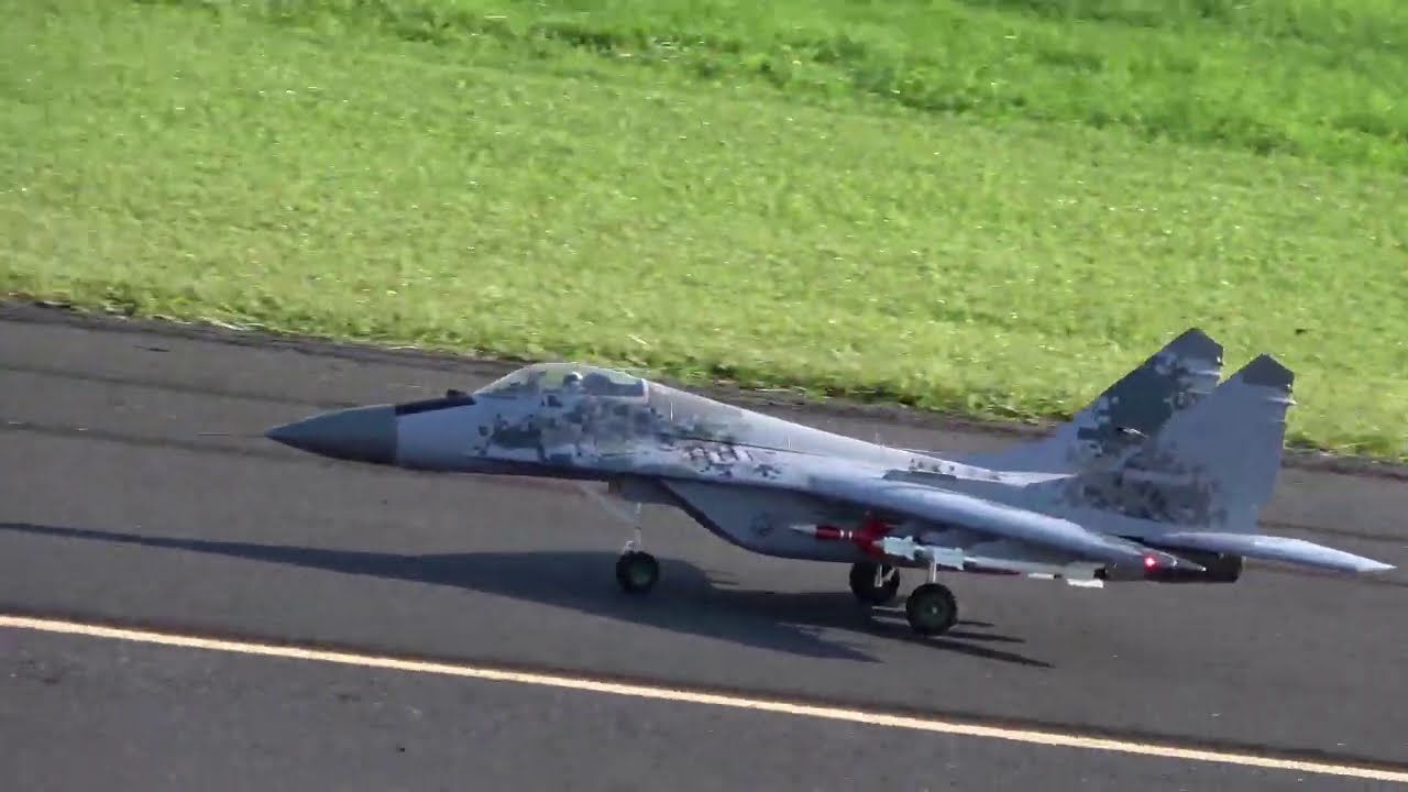

                                        • Here is my maiden flight, around 2:30 you can see how much the MiG pulls towards the canopy when inverted, 3:45 is the stall test. Wind was blowing pretty good. Enjoy!!
