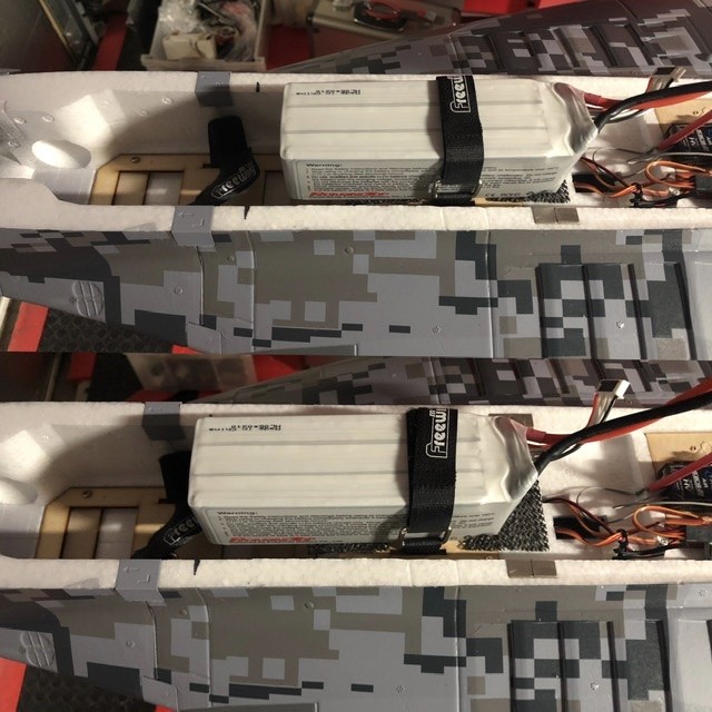

    For those wondering. You can get her to CG 1/2” aft of the CG markings with 4400mah Roaring Tops right here, using the middle and aft bays. My jet has a sound system just slightly forward of the CG and RC Geek centerburners well aft of it. Moving the middle position battery aft allowed me to fly it with a CG around 1” aft of the markings.

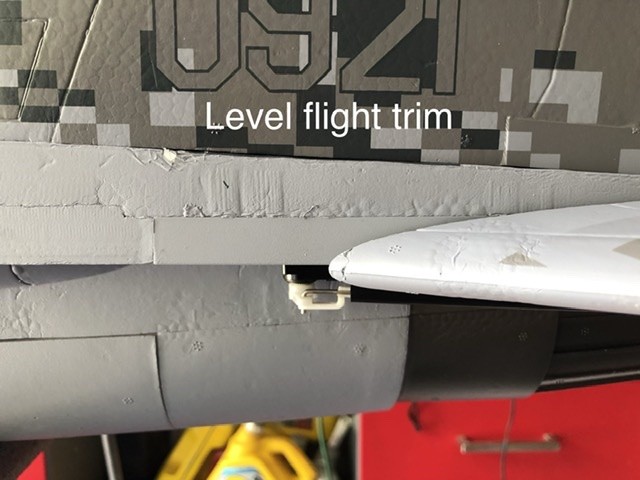

              My last flights I adjusted the CG and now elevator trim is almost flush with the bottom of the fuse. CG checked with gear down. The manual actually mentions that.
              The difference in trim was done by moving the top battery @25mm. Still required some down elevator to maintain level flight when inverted, but better than before.

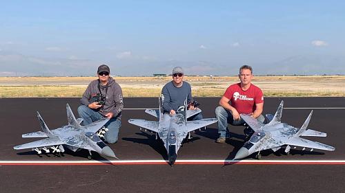

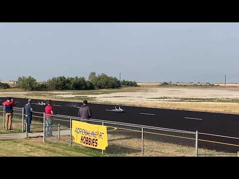

                    Click image for larger version  Name:	70E90D2C-AD52-401B-A9F8-8F81BBA620C2.jpeg Views:	0 Size:	118.8 KB ID:	275765 Jeremys video of our 3 jet formation. First time all 3 of us have flown together. More than 50 flights between the 3 jets on the stock 17g servos.

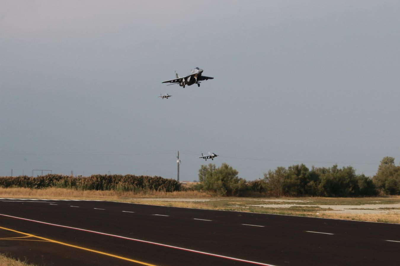

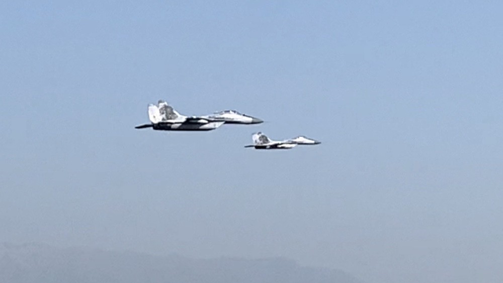

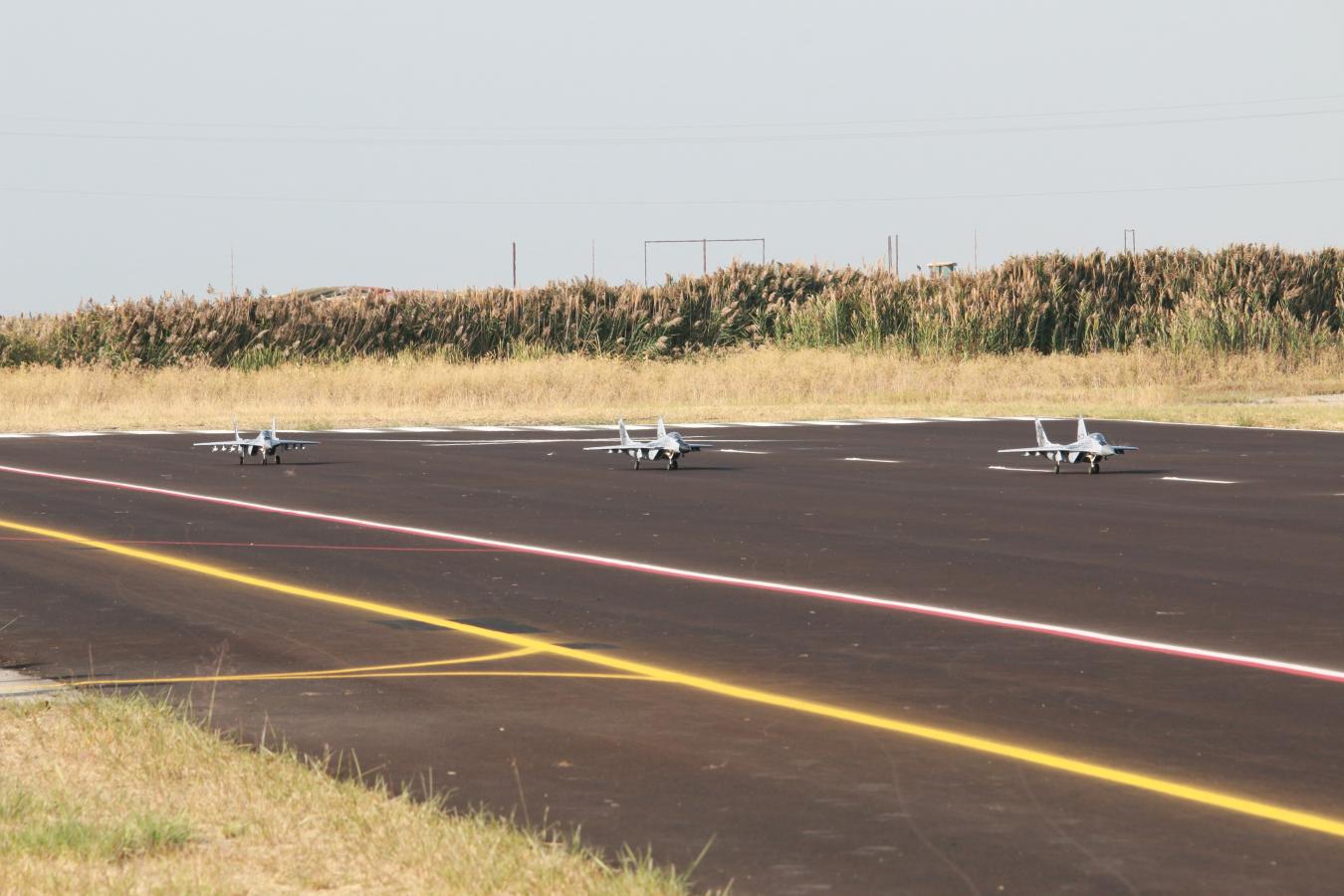

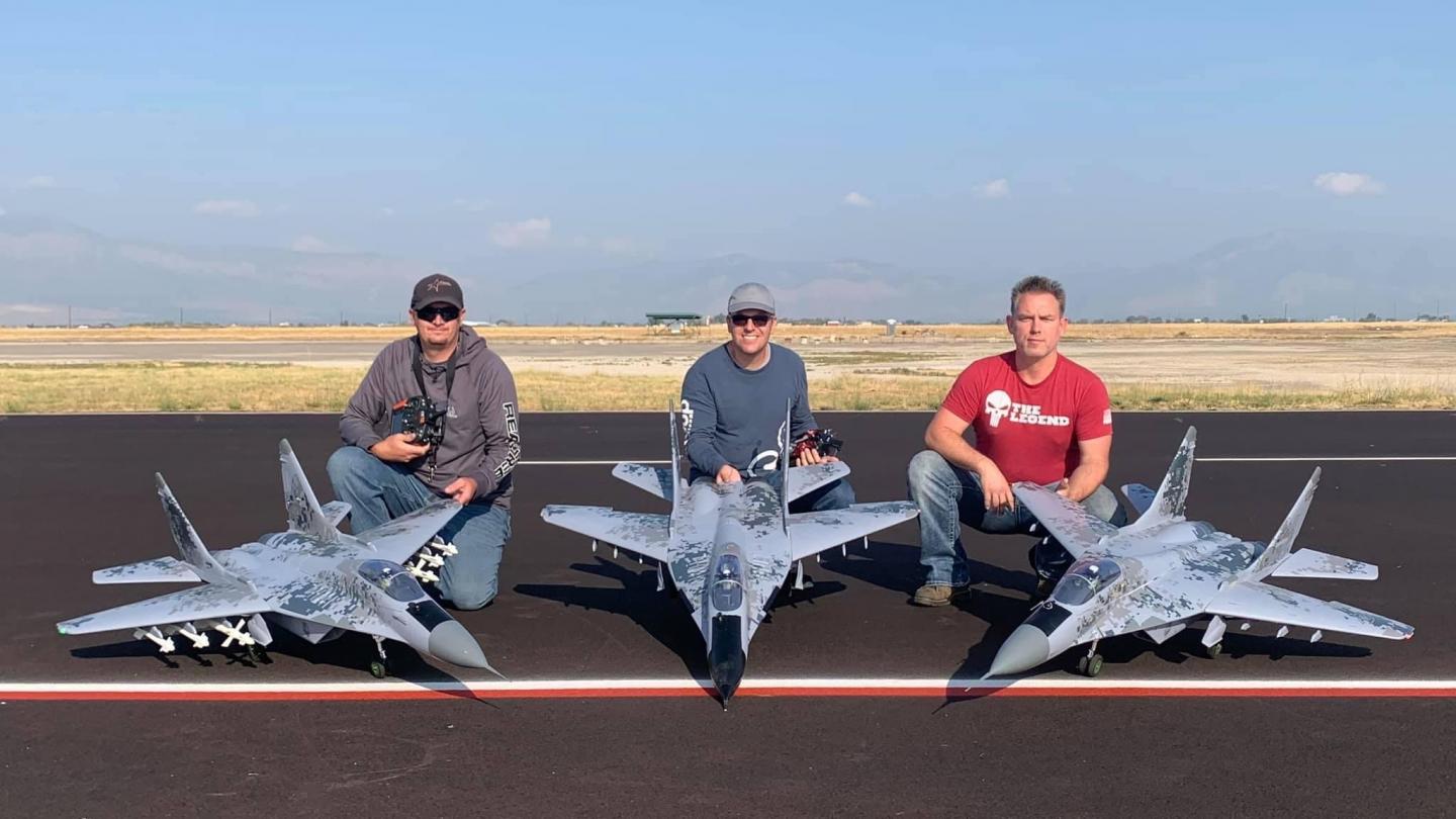

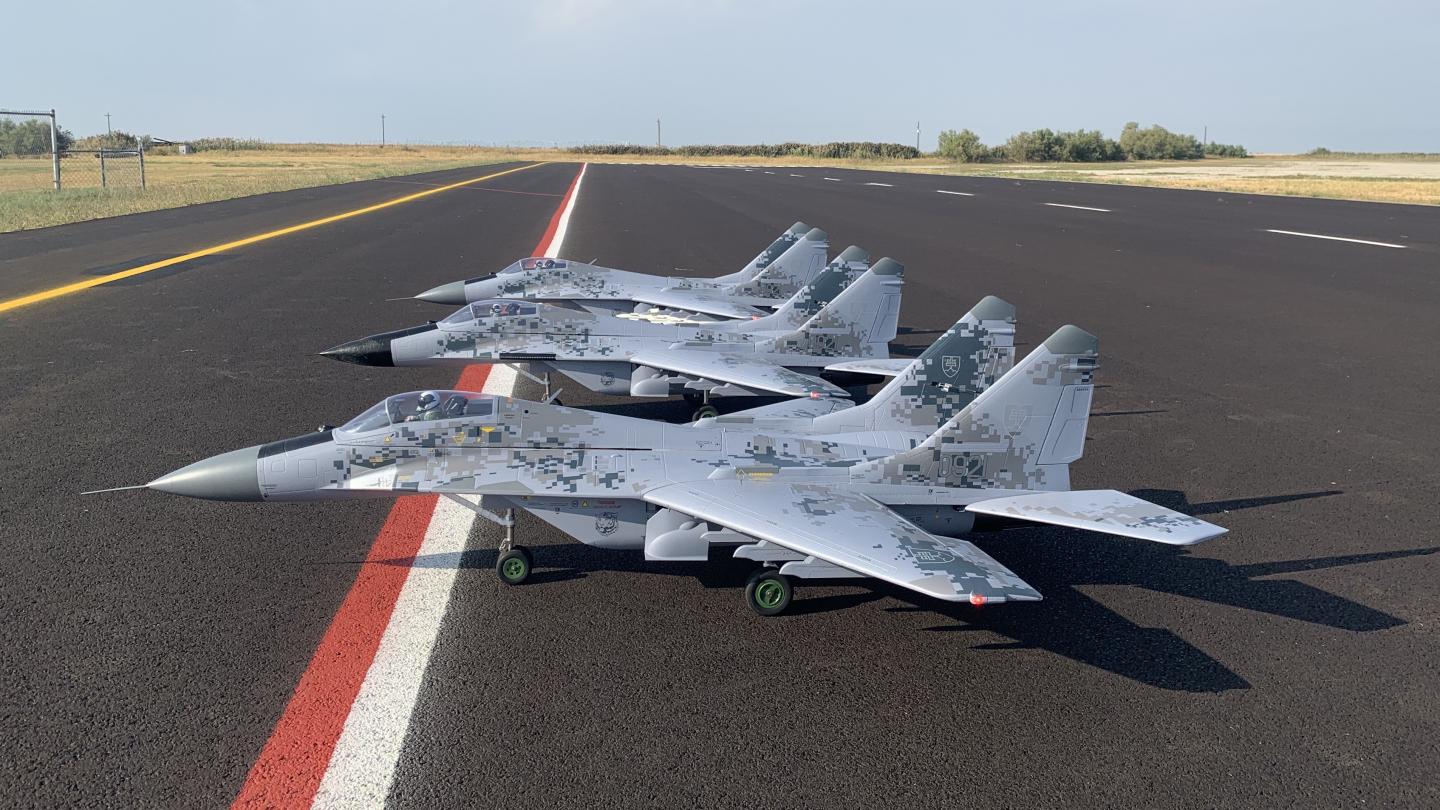

                      Pics because Everyone loves Pics!!!!

                        Awesome pictures!
                            The 3-Mig video is awesome! At least I thought so. My man KJU is not happy though, because it exceeds the number of working Mig-29's that he owns.

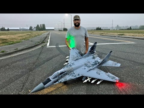

                                Flight two on mine, dusk flight, with full afterburners lighting up the sky!!!
