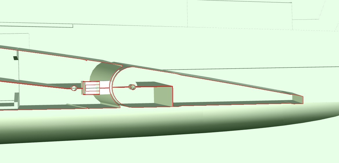

      James, during the intro video it looked like the flaps were able to deflect up as well as down. Can you verify this and the amount please. I plan on full span ailerons.
      You are so astute, Evan. Since you have such impressive observational skills, here is a screenshot I took for you showing a cutaway of the MiG-29 flap hinge. For the record, I recommend flying the aircraft as delivered (i.e. Flaps are used only as Flaps). Beyond that... you can make your decisions based on this photo.

        Thanks Alpha! I hate to disappoint you but it will be built with the wing surfaces and horizontal stabs going direct to a 12ch rcvr and with selectable full span flaps, full span ailerons and tailerons all on a mode switch. I’m hoping to have some type of TV for the maiden too...
        I guess I’ll probably have a “as delivered” configuration for the first 20 seconds of the maiden though... :)
                        Is full span ailerons scale for this bird? (asking, not criticizing)
                        I'm definitely prioritizing tailerons for my part, but obviously nice to do both if it is correct for scaleness :)

                              I don’t know, sorry. In my Arrows the ailerons are so tiny I had to add tailerons to get a decent roll. Full span may be the answer in this bird.
                                    The quick answer is no, but depending on the model the flaps could “flex” very slightly up to help with “aerodynamic advantage”. Very few if any models with “flex” ever made it to operational status.
                                    Flaperons on the other hand may have made an appearance in some later models.
