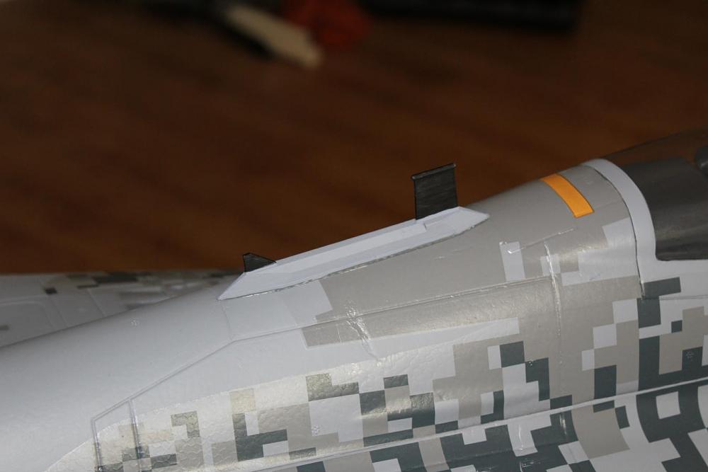

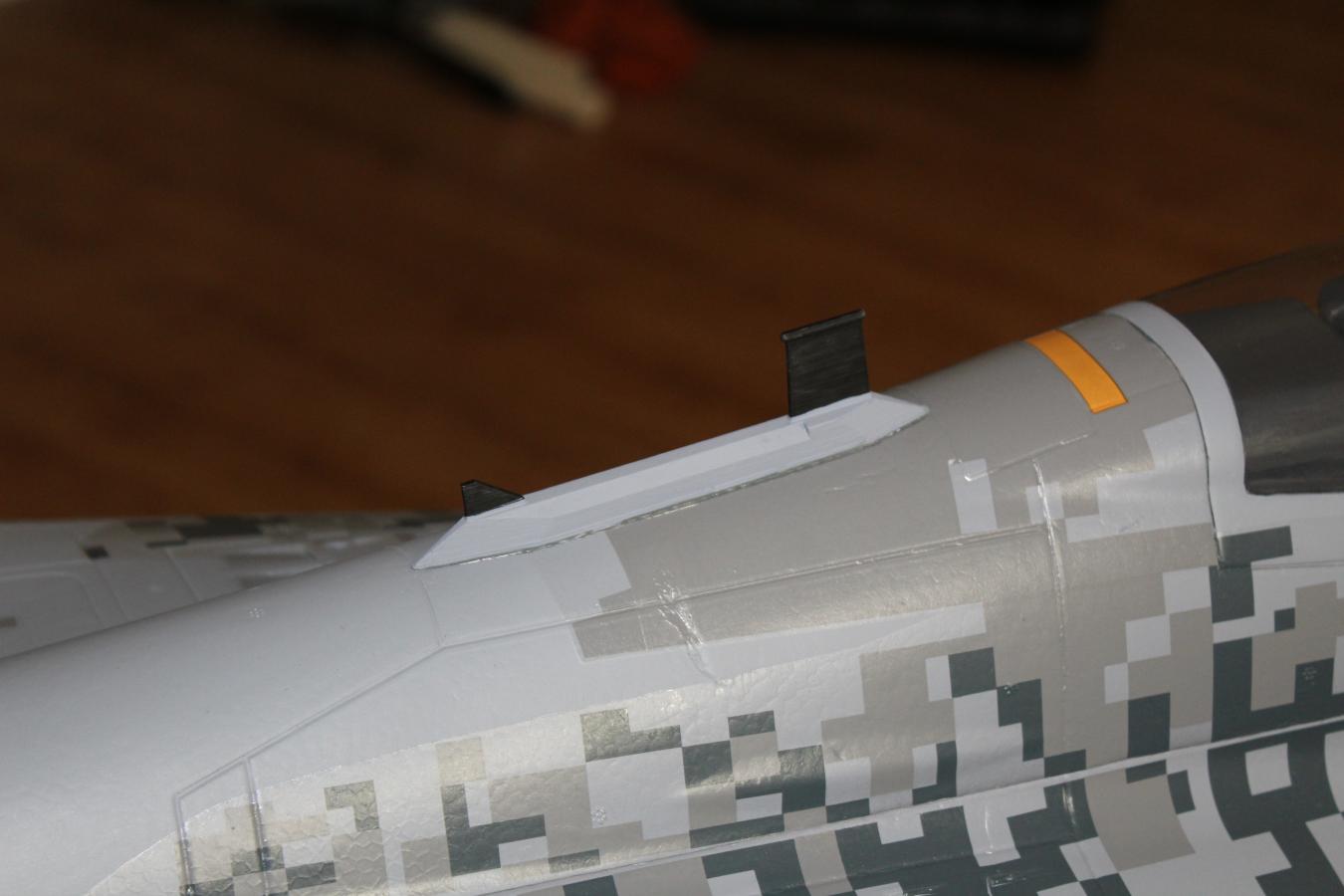

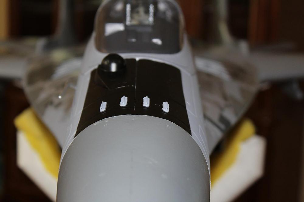

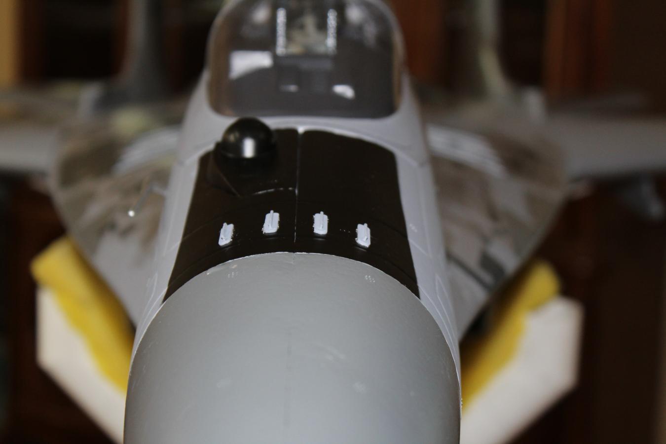

                          • Finally went down to Home Depot and got some color match paint for the base gray, and it came out perfect! So with that I got some detailing done on the Mig today. I painted and glued on the antenna array and the bird slicers, and then I masked out and painted the false canopy on the bottom (I used Apple Barrel Country Grey for this). Attached is the paint mask I drew up in CAD and used. I also cut the signal wires for the main doors (first white wire from the pos/neg wires on the ribbon cable) and soldered them together to an old servo plug. I removed the pos/neg wires from the servo plug so all that was left was signal (the door servos still get power through the ribbon cable). This saved having to run servo extensions from the wing to the blue box. Now my doors close after the main gear extends. Tomorrow she gets packed up for the trip to St George.

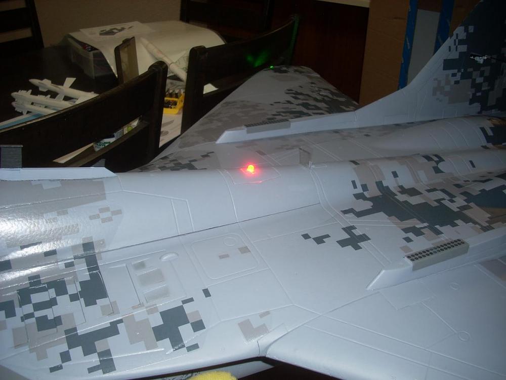

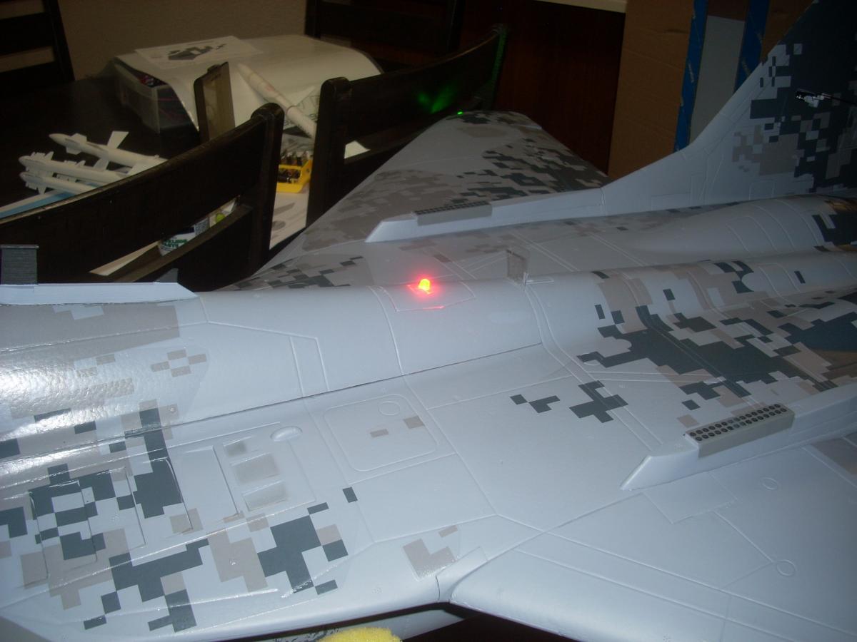

                                    • Oops, almost forgot to install the ACL! I have it on a strobe port. Used a light housing and light from a crashed 90mm F-16. There's also an ACL on the bottom of the left engine duct, right about where the EDF hatch cover is. Not sure yet whether or not I'm going to do that one, or the white marker on the left vertical.
