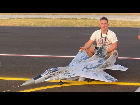

              #1146
              Travis Elbert and his new MiG-29

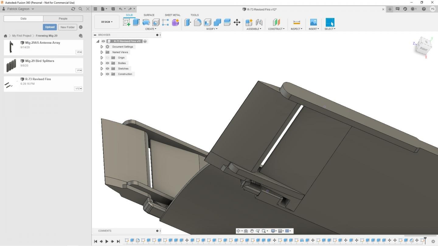

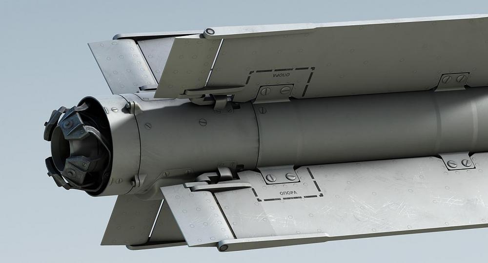

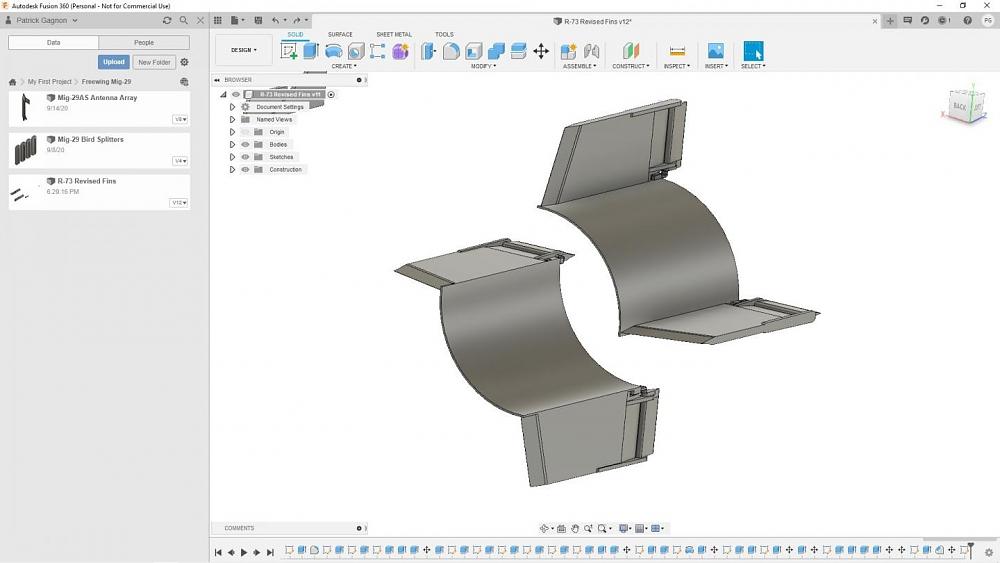

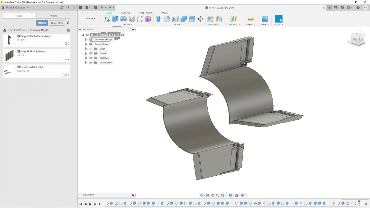

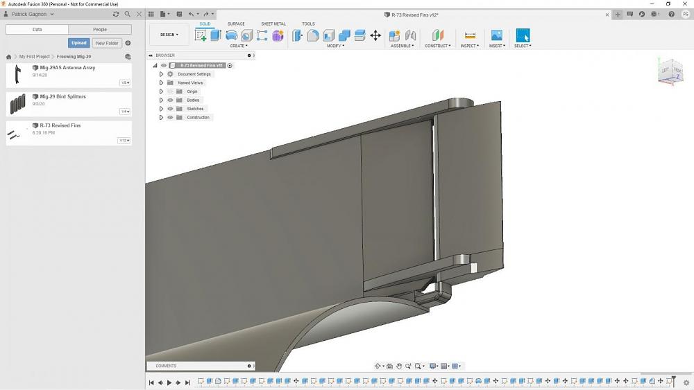

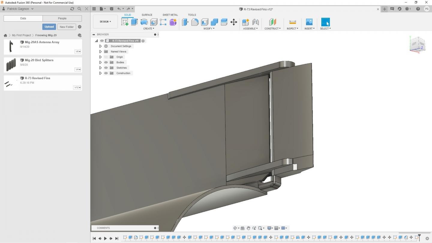

                Last night on the Discord chat Alpha was talking about doing a 3D design to replace the flimsy fins on the missiles as an on-board video showed how much they were flapping in the breeze, which of course means added drag. I have some very detailed pics from turbosquid where others have done some really nice 3D designs of the R-73 and R-27 missiles, and used them as a guide to make these. All you have to do is peel off the current fins and then glue these in place.
                Almost done with the front fins, then will get a set printed to check fit and scale.
                Click image for larger version  Name:	R-73 Rear Fins.jpg Views:	0 Size:	72.5 KB ID:	275007
                Click image for larger version  Name:	R-73 Rear Fins Detail.jpg Views:	0 Size:	71.2 KB ID:	275006
                Click image for larger version  Name:	R-73 Rear Fins Detail 2.jpg Views:	0 Size:	79.0 KB ID:	275005
                Here's a pic I downloaded from turbosquid showing the fine details.
                Click image for larger version  Name:	07x.pngDA956783-64F7-4D3E-B616-01B5BB193B46DefaultHQ.jpg Views:	0 Size:	73.1 KB ID:	275008
                • GliderGuy
                  • 1408
                  #1148
                  Pat - Excellent! You guys with 3D capability!!!!
                  I took the old school approach and cut 8 lengths from a wire puller (another MRC bird left-over) and bent each of them to follow the perimeter outline of the flappy fins. Glued the wire to the bottom of each fin and painted it. You cannot see it, and the fins are rock-solid stiff. Took me about an hour.
                  -GG
                    #1149
                    This picture makes me so happy, thanks for sharing Rod Musgjerd of Travis' MiG.
                    crxmanpat I completely forgot yesterday to draw those, thanks for doing them instead, they look great.
