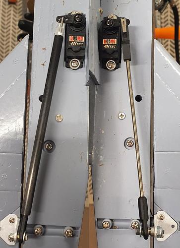

      • Some rambling thoughts (was out flying all day today and too many posts to quote, so bear with me).
        On the flap servo issue, seems to me that the flap servo in question may be bad. I don't think it had anything to do with the blue box. What I think happened is the servo overheated and stopped working and went to full up setting on approach. Then later when it cooled off, it started working again. Hopefully Motion can look at it and determine whether or not it is bad and should be covered under warranty.
        Here's my take on the whole "bad elevator servo" issue. I personally don't think the servos are bad, I think there is a combination of factors contributing to crashes, which are:
        1. The geometry of the pushrod is not ideal. If you look at the F-22, the servo arm to control horn is at almost a perfect 90° angle. On the Mig, the pushrod is off that angle by about 10°. Having the control rod in the middle hole increases that angle. The reason I bring up the F-22 is that it has the same 17g MG servos on the elevators as the Mig. I fly my F-22 on 12S, and the servos handle the load just fine. But the F-22 has that ideal pushrod geometry.
        2. People did not read the manual and put the control rod in the outer hole as indicated.
        3. I think the initial crashes were also nose heavy. The manual states to install the forward battery tray and I think guys were just automatically assuming that you install the forward battery there. I don't know this for sure, but seems likely based on the videos I've seen.
        I flew my first two flights with the original servos. It flew just fine as I had it set up properly. I now have the new servos in and flew it one flight this morning.

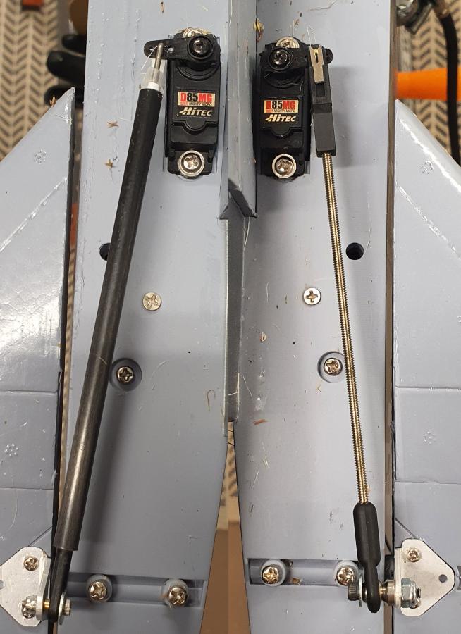

        Brent Hecht showed up at the event today with his Mig. He did a couple things that I will now be doing as his seems faster than mine. First he opened up the cheater holes some. Seemed to him like the fans were getting slightly stalled. Opening up the cheater seemed to solve this. He also made the exhaust smaller by a couple mm. Need to find out tomorrow by how much.

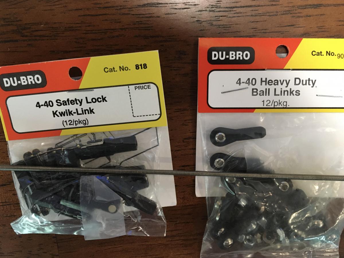

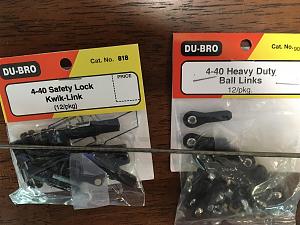

        • I knocked up some beefier servo rods based on 4-40 allthread as the stock ones still had some flex in them in the parts not captured by the carbon tube. Whether that has an impact on flight performance I am not qualified to say, but the weather has been miserable so what else are ya gonna do lol (have since installed the dubro heavy duty servo horns so its all very solid now). May go back and fit some carbon tube just for aesthetics as I really like the appearance of the factory setup.
          The dubro heavy duty ball link (Part #899) comes with a spacer, I am guessing for surface vehicle tie rods which need to accomodate the ball link swivelling throughout suspension travel. But it straightened up the geometry of the pushrod somewhat.

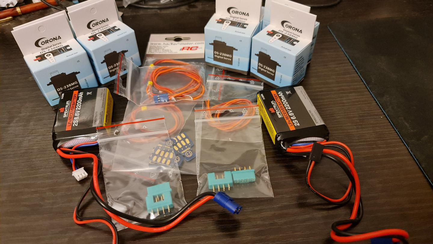

                            • Replacement servos - ready
                              Wing connectors - ready (well, need some soldering)
                              Power receiver LiFe - ready
                              Plane - MotionRC?

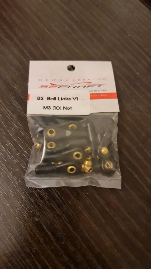

                                • Oh, sure!
