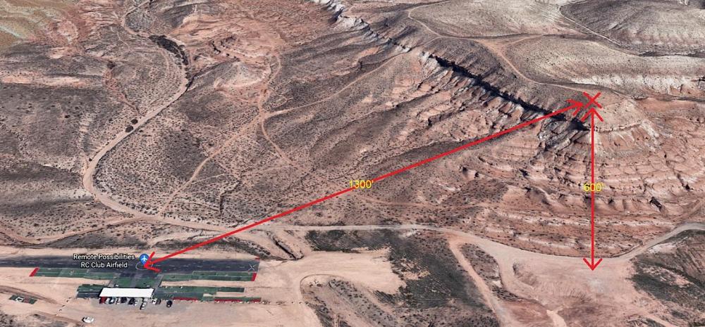

    JLamb flying his Mig in St George yesterday from a unique perspective. I was standing at the top of a hill while filming (1300" away and 600' above). See the attached pic for a view of where I was standing in relation to the runway. The red X was my position on the hill. Be sure to watch in HD!

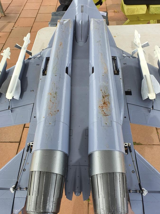

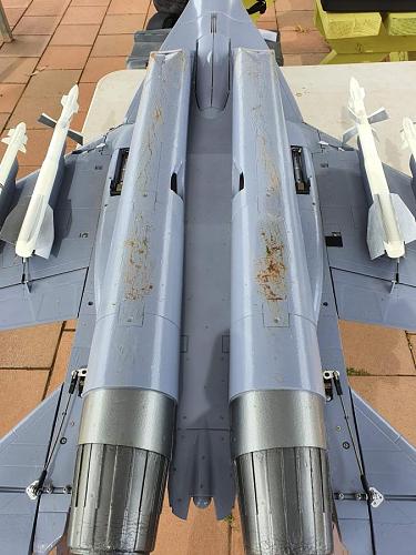

          Yeah im not sure when the uncontrolled roll you describe occurs, is it at 11 seconds as the plane levels out from the slight left roll at 9 seconds? The entire clip looks like pretty low airspeed to be climbing at, although there isnt much in frame to get a proper reference.
          I actually binned mine yesterday, current diagnosis (pending further inspection) is a weak pack leading to reduced thrust from one motor shortly after turning onto downwind after takeoff (i hadnt tried these packs in the mig before, nor will i again lol). She was wallowing around in a similar fashion to the one in that video as it approached stall, but started behaving after cutting the throttle and had enough altitiude and *just* enough control authotiy to get the nose pointed down for a semi-controlled belly flop. Still more inspection work to do but so far the damage is cosmetic, save for the bent elevator horn (went full up elevator at around head height to soften the blow).
          I doubt those intakes will take another hit but they're good for one emergency landing lol.

            Oh wow, that was awesome, but that gear delay needs to go......
              #1586
              He actually waited to put up the gear. Normally he takes off and immediately does a dirty roll, then sucks up the gear on the downwind. The delay has to be there in case you have something with dual stage doors (like I did with mine). But it would be nice to be able to program the gear on the blue box based on single or dual stage doors.
              On all mine with the blue box, I tend to hit the gear switch about halfway through my takeoff run, that way when I'm off the ground and climbing the gear are coming up.
                That kind of reminds me of something I saw.
                I do the boring slow takeoff lift and retract after climbing a few feet before doing a steeper ascent. Looks scale, so I've been told ...

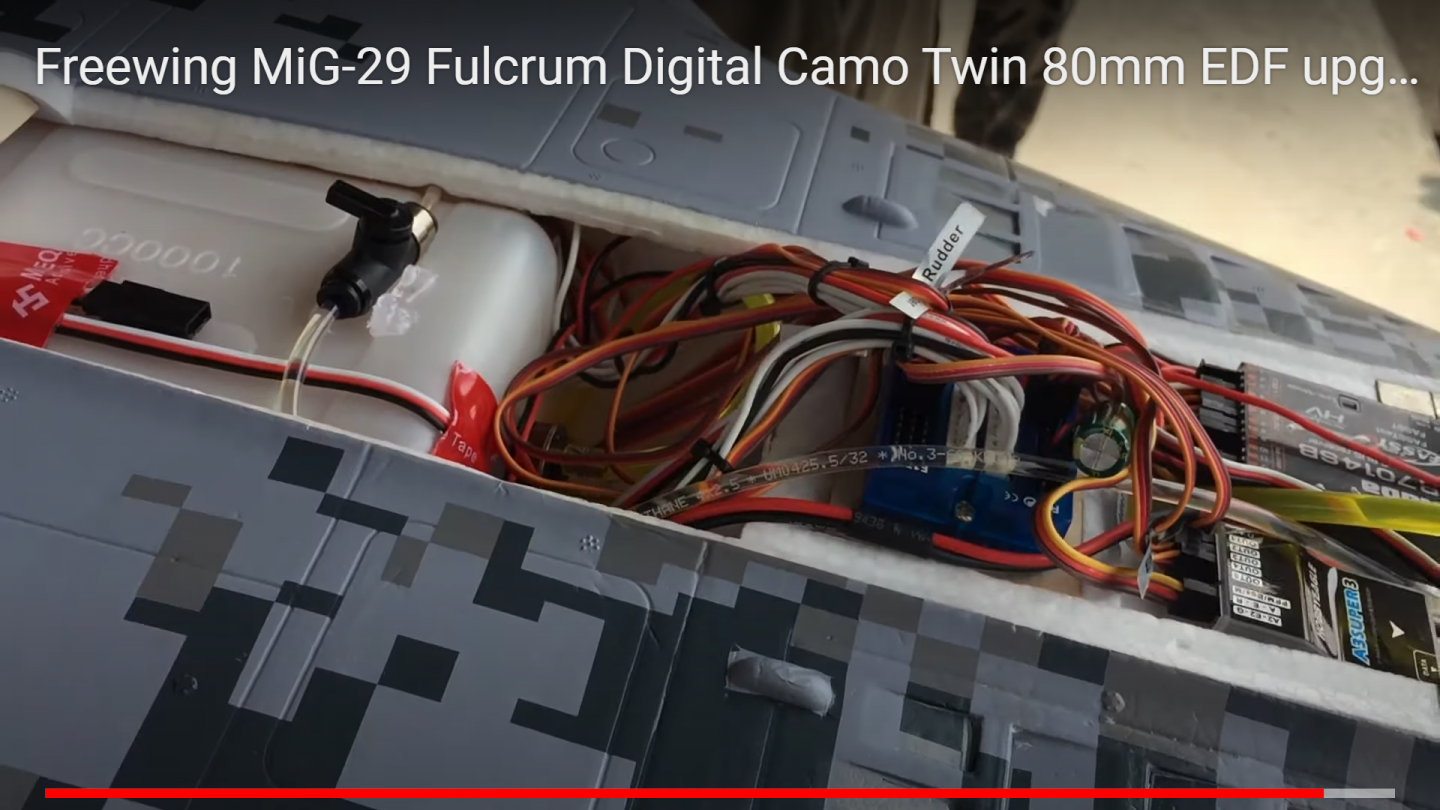

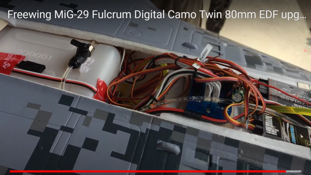

                  Click image for larger version  Name:	MIG29 tank2.png Views:	0 Size:	1.25 MB ID:	277286
                  Originally posted by janmb
                  Have looked at baggies too, just something new to get into - like you, never tried that before.
                  Definitely would require running a decent size UAT in addition though - almost impossible to avoid some air in that bag when filling, and absolutely no way to purge it.
                  Should never have doubted myself, studied the K45g3 video once again and got a screenshot of the tank installed clearly showing the tank size markings on the top and it is the same 1000ml tank I have and for the space available looks to be a optimal use of the space right infront of CG. So its decided the original 1000ml for me plus a 2 oz UAT right up front.
                  I promise not to harp on anymore about this untill I actually have a model to tinker with lol.
                    I do that too but I don't like having to do that to get the cool gear retracting look just after takeoff. I'm paranoid that the plane won't rotate quick enough and I'll end up sliding down the runway. I bypassed the blue box with the gear on one of my planes that I fly a lot, just to avoid having to do that. It would be nice if there were a way to select the gear door stages....

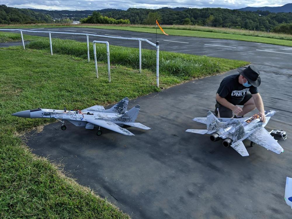

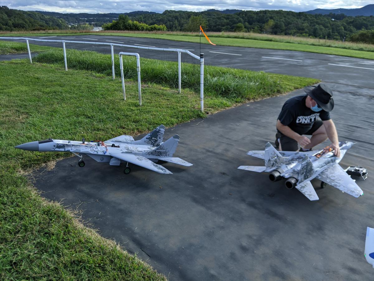

                      Maiden report - She flies amazing! RCjetdude helped me get her buttoned up as usual and is really helping me learn. Remember, just 1 month ago I tried to fly the 80mm a-10 as my first EDF and that ended in the dreaded bounce. Since then, I have somewhere over 100 flights on the eflite f-4 and su-30 to try and get up to speed. It's been a... process but finally feeling way more comfortable and capable.
                      I flew the HRB 6000mAh 50c batteries at the rear and middle location. RX is up front. CG was DEAD on which some are reporting as a bit conservative or nose heavier. I have to report that i required absolutely ZERO trim at the recommended CG location. Even with flight modes to mix in elevator trim to flap I didn't need it. At both half and full flaps, it maintained attitude without any adjustment. I did add about 2-3mm more elevator trim at default than the book recommended. I haven't tried my much lighter Spektrum 5000 bats yet. High AoA landings were smooth and easier than the SU-30. She's fast, but doesn't seem like it because of how large it is. I used the inner most elevator servo hole per RCjetdude's standard practice/advice, even though I had the upgraded servos. I still got my throws so it's good. She lands in a much shorter amount of space than the f-4 or su-30.
                      Our maidens were pretty uneventful and I'm thankful for that. Steve flew first and it was good to watch it's characteristics. I can't wait to get back out and fly it again!
                      One of the guys at the field tried to chase us around with a GoPro strapped Timber which was pretty funny. He captured some pretty cool video though and did a quick edit. Alpha : This thing is PERFECTION! Congrats!
                      Quick chase video from the Timber:

                          Cool video from the hill-top!
                          Could do with a bit of post-processing stabilization though but it was amazing nonetheless! :D
