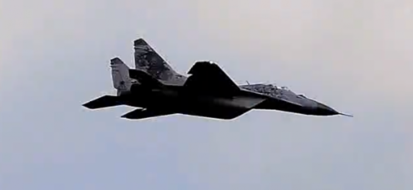

                            Then why didn't the ailerons also go down? They are in the same "plane" (the other plane) as the flaps and should have been subjected to the same forces. "No one does", at least not on purpose. I've done my fair share of flying around with take off flaps deployed because I forgot to suck them up, just like some people fly around with the gear hanging down the whole flight because they just didn't think to flip the switch and they don't even see them down (mental block). Oh well, we will never know for sure. The guessing continues.
                            He was definitely flying around with (full) flaps during his whole flight.
                            This is an enlarged screen shot at 2:55 minutes in his flight.
                            Could happen to all of us (at least I know it from myself) ;-)
                            Worthwhile to investigate further the effects of (full) flaps on a high speed dive!

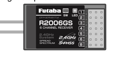

                                    Futaba receiver in my bird and 3 added ferrite RF filters and the green ring.
                                    Using the stock UBEC which barely gets warm even if checked after multiple back to back flights. So it’s not working very hard IMO. And I have it hot glued to the foam, so one side only gets air flow for cooling. I may consider a remounting to improve cooling before summer comes. 8 amps is a good amount of muscle. UBEC wire extended...sits in the wing root by the rear battery.
                                    About 500 flights no issues with flaps deployment at 1/2 throttle to slow for landing. Then gear down. Pretty much always. So lots of maneuvering at various speeds and attitudes with flaps down while in the pattern and setting up for landings. Flaps go down 30 mm every time.
                                    Admiral 6000s / CG on the mark / Y bypass used with MRC upgraded servos / Du-Bro beefed up elevator rods and connectors / holes - throws are book other than flaps are a bit more than book / about 2 mm negative flaps / 3-4 mm of elevator trim
                                    Flight style is a mix of 3/4 throttle cruise, full throttle passes and acro plus slowing to 1/2 throttle at the end for flap and gear deployment. 4:00 min / about 3.7 V post and typically 4000 mAh consumed.
                                    25% power on down wind then 15% on final...so lots of speed/bank change-ups with flaps down. Gut feeling is....not an aerodynamic issue at least not with this set-up.
                                        But are you flying around with flaps down (making the flap servos work hard) for an entire flight that includes several high speed passes?
