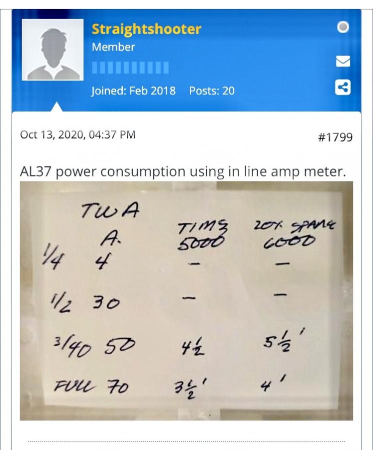

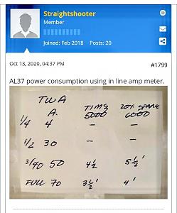

    Congrats! PieterO this was posted on the AL37 forum. A good goal is 3.7 V minimum after a flight.
    The chart is not for the MiG, but provides a visual for current flow vs throttle vs impact on flight time.
    You may want to read post #1879, too.
    -GG

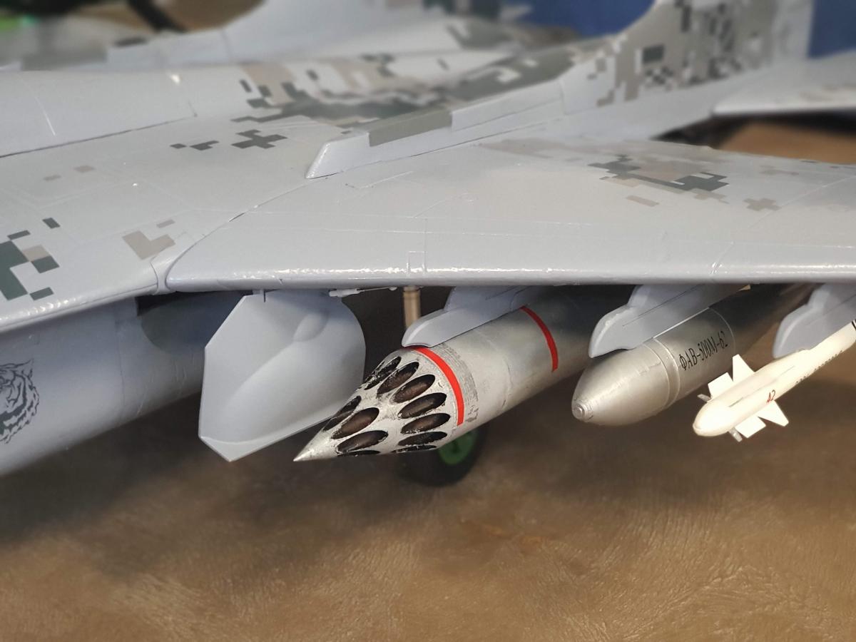

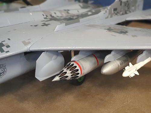

                Absolutely love these rocket pods from dirtydee. It was already an intimidating looking plane but the unguided weapons just look brutal under there.
                Ive published the FAB 500 pound bomb on thingiverse as well. Nothing fancy but it's pretty close to scale.
                A 1:9 scale high explosives bomb to fit the Freewing Mig-29 dual 80mm EDF.Print parts, glue parts, paint parts. Accepts the standard freewing weapons mount (https://www.motionrc.com/products/freewing-f-16c-90mm-weapons-attachment-hardware) or print one of the ones available on here.Print with a single layer outline and 5% infill - it will be light and strong.

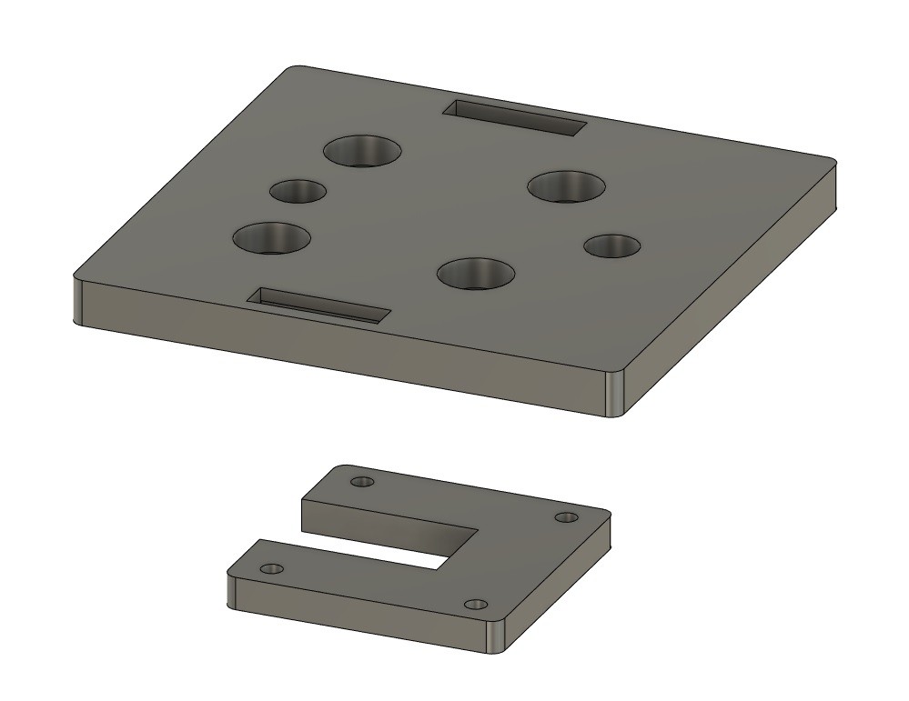

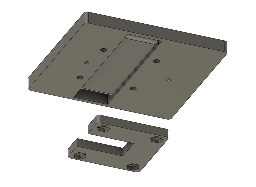

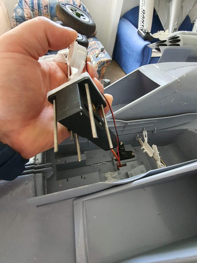

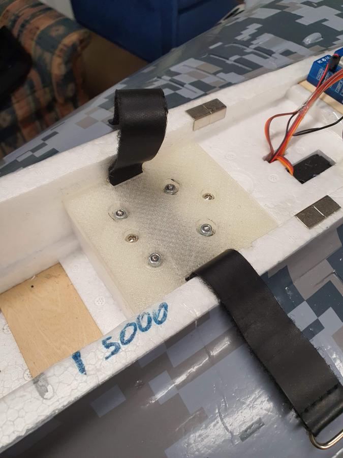

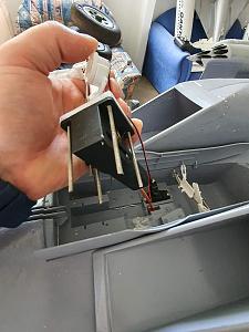

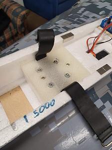

                                  I saw some of y'all breaking retracts and dislodging the factory retract mount. Our grass is far from perfect, so thought I'd get ahead of the progblem. Inspired by Brenden McCormack's mod for the F-14, came up with a solution that sandwiches the whole lot with 4-40 allthread between a couple of 3D printed plates.

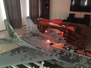

                                          Originally posted by meadowhay
                                          Simple add on anti collision beacon using a spare red LED salvaged from my broken Avanti and plugged into a strobe output on the MCB-E.
                                          Additional landing lights to follow (full size has 3)
                                          You Tube link
                                          Click image for larger version Name:	20201015_111703.jpg Views:	0 Size:	42.3 KB ID:	280558

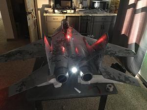

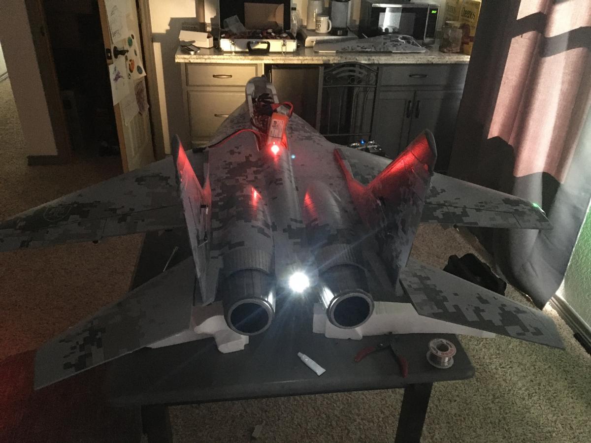

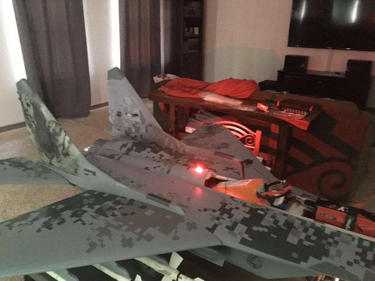

                                          Meadowhay - Liked your idea. I needed more orientation lighting for pre-dawn / post-sunset flights, so I also decided to add a white tail position light along with the red LED.
                                          None of this is scale, but the locations are fairly easy to run wires to. There’s a plate or rod in the tail about 3 inches forward from the rear end that was a challenge to get past.
                                          Early on, I added a second landing light. The bar coming forward from the nose strut was blocking the landing light on certain approaches. So, I added a second landing light on the other side of the strut....problem solved. I need the landing light to stay visible for pitch judgement on final in dim ambient light.
                                          Parts list from scavenged from crashed birds:
                                          - landing light (round - same size)
                                          - white LED
                                          - red LED
                                          - Wire + connectors
                                          The red LED butts up against the rear of the latch. This keeps it ahead of the rear wall of the rear battery compartment.
                                          I selected the double flash from the control board for the red LED and the “light” for the white LED.
                                          Can’t wait to see how much this will help. Windy! UGH!!
