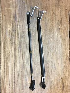

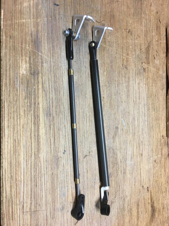

                  Like I said, "those other models" would be the SebArt MiG29, which uses the same design. In models such as the Radian, those sheaths are anchored on each end because the run is very long. In both the SebArt and this MiG, they aren't anchored because the run is not sufficiently long. However, the principle is still the same - to make the rod flex minimal and non-affectual. It is not a new concept and is not "an after thought".
                  If you look carefully at that video, the bulk of the flex is in the servo arm.
                  Let me put it to you like this. The rod shouldn't be flexing in the first place. The carbon tube needs to be fixed to the pushrod. Like another guy did by filling the tube with glue.
                  If I didn't know a better way to do it, I would think the design is just fine also.
                    • 8835
                    #1949
                    Let me put it to you like this. I'm merely pointing something out to you that you seem to be dismissing. You do whatever you like. That's always been your option and right. No longer am I pointing anything out to you. Your blinkers are on way too close.

                          • 5426
                          #1952
                          Click image for larger version  Name:	DFE28990-135B-4765-965C-048482752202.jpeg Views:	0 Size:	123.6 KB ID:	279793Click image for larger version  Name:	1D752DEC-000A-41DD-8D3E-DC32305B1B03.jpeg Views:	0 Size:	117.6 KB ID:	279792 Mine...as I have said before it’s a good idea to consider changing the little screws holding the horn on too. And add a little glue to the servo horn screw. If you use carbon tubes remember the can split length wise unless they are spiral wound tubes.
                              That looks beefy. I have my pushrods in the inner holes like you and I still get the full travel for the stabs. I am not sure why guys were initially putting them in the outside holes unless they were trying to align them better at the expense of putting much more strain on the servo and creating a lot more slop from the servo gear play.

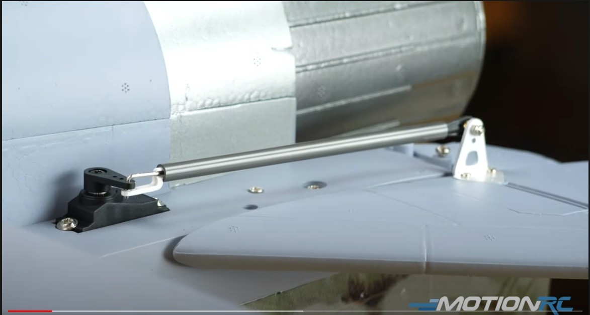

                                  #1956
                                  Of course I am guessing but I think they didn’t read the manual close enough. I also think some looked at the front and rear battery bays and since this is the first plane with a middle bay they assumed the batteries went in those spots making their planes very nose heavy compounding the need for a strong elevator.
                                  To be fair if they were following the initial build video before it was censored, and not listening to James who always stresses the importance of reading the manual, they may have gotten the wrong idea.
