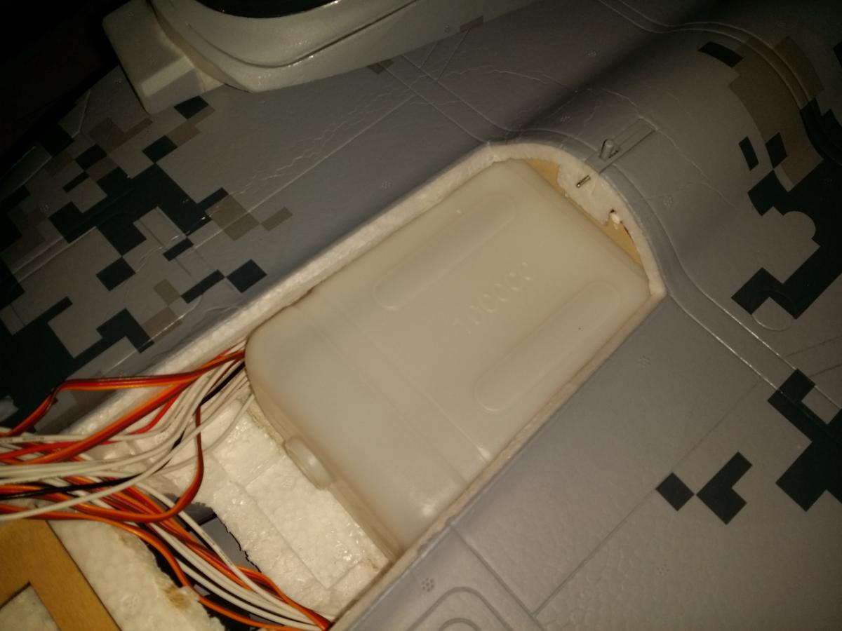

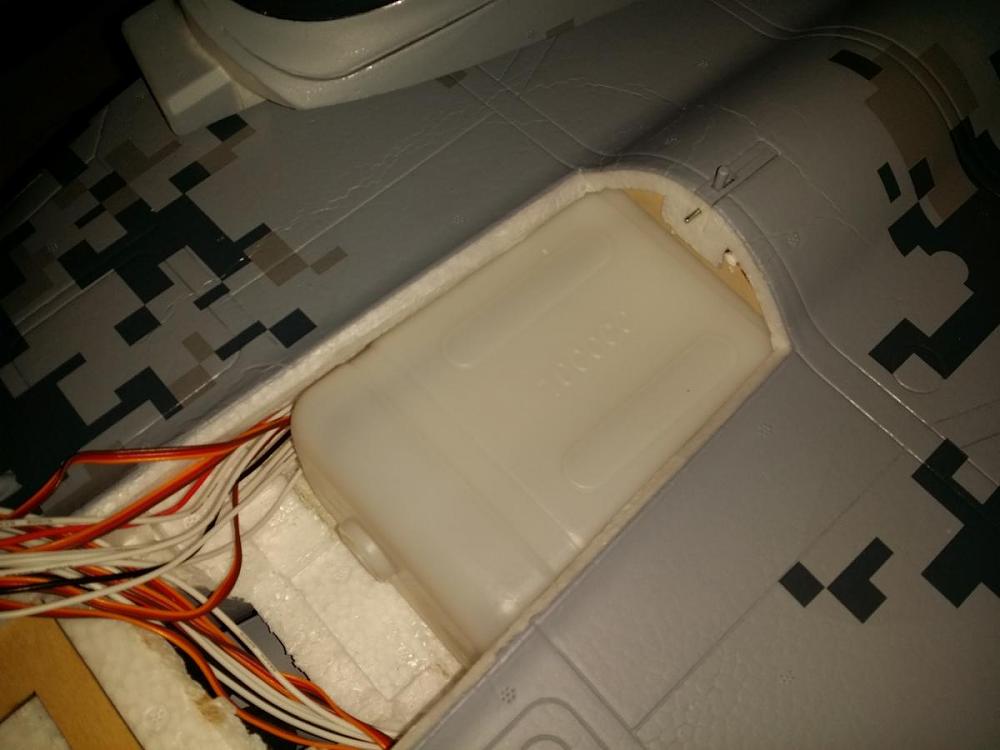

ID:	279981 I realised due to posting here and at rcgroups I never updated on my tank fitment, well it was a bitch and although it fits it can be a bit brutal making it work. Found a video today of a guy flying with x45 and mig-29 and what looks to be the sullivan 32oz V tank, it looks to be simpler fit with perhaps less foam hacking though more fuel will be slightly further forward as its longer. https://www.youtube.com/watch?v=XdNK...OOla8ha5vglZcI
            Mine is in though so job done.

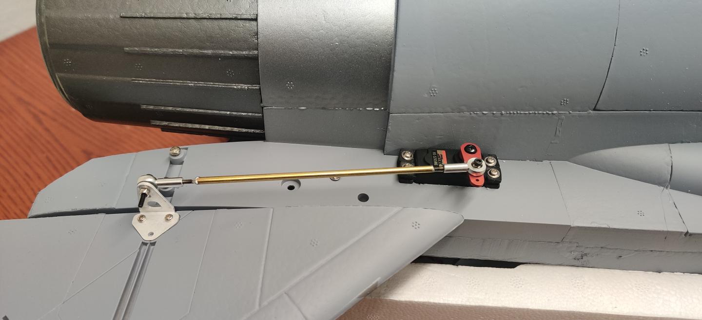

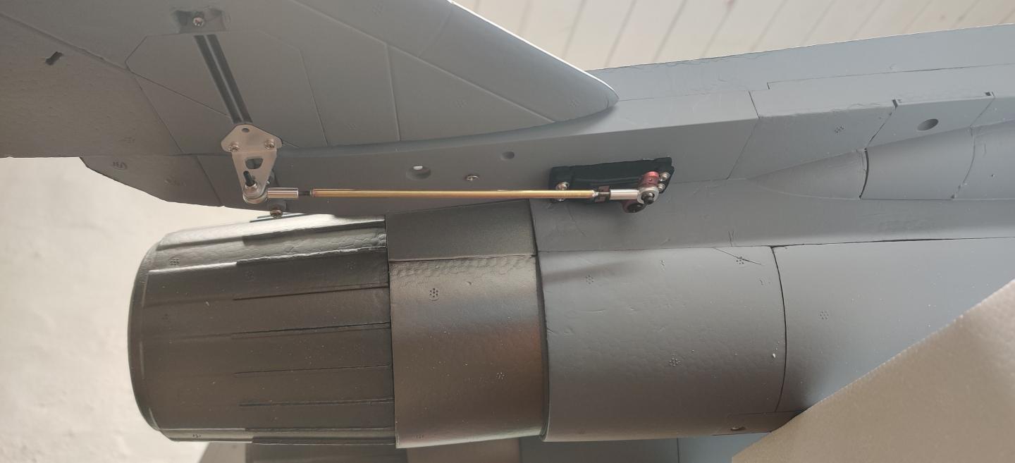

                Originally posted by janmb
                The problem is that the inner diameter is much too large, making the tube next to useless
                Sure, it will prevent the rod from bending double, but it is still allowing bending equalling about half an inch travel at the taileron leading edge
                Yep. All the tube does is prevent the rod from permanently bending and not returning to it's original shape, which is straight. Where I live we call that Tennesse engineeeing.
                • janmb
                  Slow and low
                  • 729
                  #1988

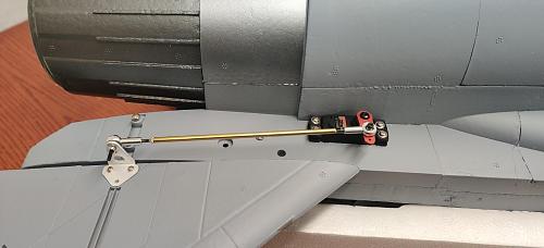

                  My solution below....
                  Also replaced flap servos with Hitec D85MG and adjusted geometry to gear it as low as possible.
                  Honestly not surprised about the elevator issues. Did some manual testing today, and the force required to stall the stock setup is next to nothing. Even my upgrades, tested at 6V, 5.5 kg/cm torque, with identical geometry as the stock setup, takes surprisingly little effort to stall. Those elevator surfaces have a huge leverage, even with decent geometry.
ID:	280013Click image for larger version
                  • mshagg
                    • 541
                    • South Australia
                    #1989
                    Is the D85 reference correct? I am using them but they only have one screw at each end.
                    Edit: disregard, I just saw you were referring to flap servos.
                    I'm eyeing off the D645MW for ~8.5kg @ 5v, which will require some carving to fit but is more than double the torque of the D85MG and only an extra $10AUD per side.
                    • janmb
                      Slow and low
                      • 729
                      #1990
                      As long as you can make it fit, there is absolutely no downside to overdoing it for sure. I would do some homework on depth first though - the elevator servos don't have a huge deal of excess foam to remove before punching through the topside. I managed to get my 5245 in without too much carving, but any much deeper (taller) than that might be a challenge.

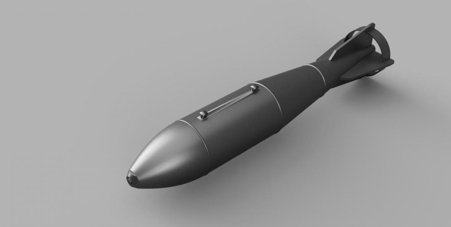

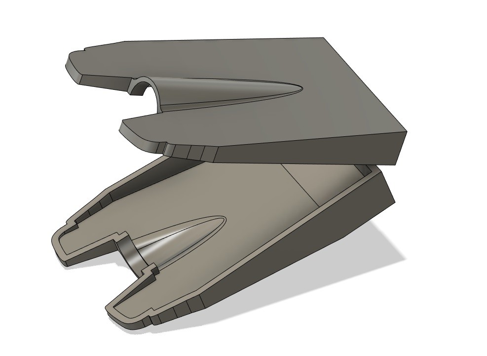

                                  Still need to seperate parts and try a test print (need to figure out the offset for hard point), but here's a WIP of a FAB M62 500lb bomb. Ill put it on thingiverse when it's done - not a lot of ordnance there for soviet jets
Name:	FAB 500M62.jpg
ID:	280312Click image for larger version
