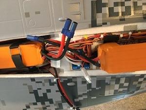

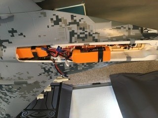

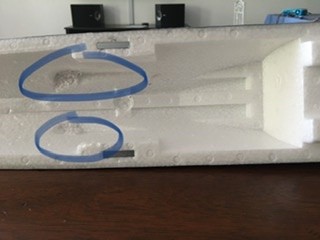

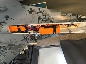

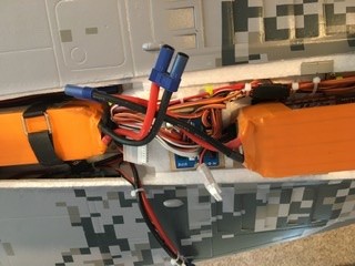

                                    Hello, can you send some photo of your Admiral 6000 Pro placement? I want to use same batteries into this plane. Its cut of cabin bottom foam required for good battery placement?
                                    • Originally posted by Airguardian View Post
                                      I'd swear the built-in thrustline on this model is pitch-up, not pitch down, as reported by many pilots (and from visual inspection of the nozzles). Nozzle thrustline will pitch the nose up (notice the jets flip over their back when attempted to hover!).
                                      That still doesn't rule out a throttle pitch down contribution at speed due to pressure modification in the intake area.
                                      its likely an optical illusion, as the profile of the aircraft has the cockpit riding high. or maybe its CG is nose heavy 🤣
                                      Either way, i suspect the Mig-29 thrust lines play a role. Even if its a minor one.
                                      • Originally posted by Jacckall View Post
                                        No problem. A very small amount of foam removal allows for a better fit. Dab on some oily make-up on the battery corners and put the lid on to see where to trim (lip stick, etc.).
                                        Suggest you use the RF chokes (search this forum for “ferrite”). Lots of discussion about these.
                                        -GG

                                          Thank you for tips and photos!
