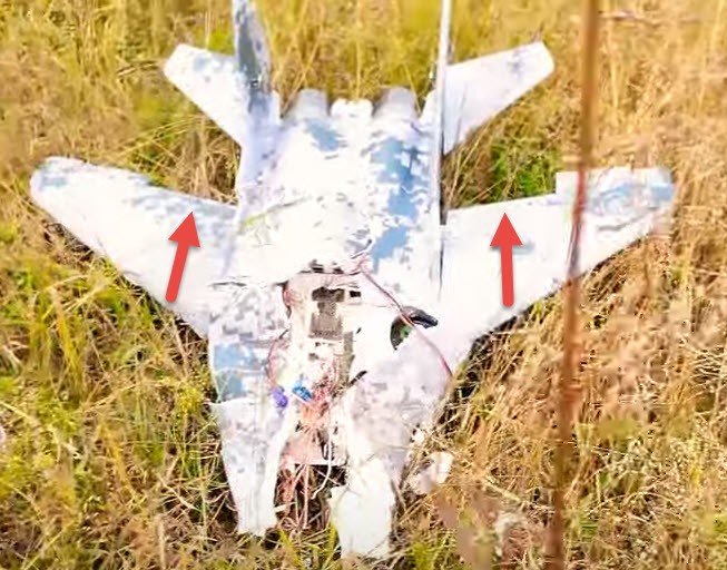

              This is another slightly better screen shot of the crash. Do those elevators not look to be in full up position all the way to the ground? The image is better than my screen shot if you look at the video frame by frame on YouTube.
              Flaps were also deployed at 4:01 in the video just prior to the crash. Not sure if he pulled flaps up prior to the high speed pass or not. I will test the effects of the flaps blanking out elevator control when I have someone that can film for me and the visibility improves. Need blue skies and some altitude. We're grey skies here right now.

                              The second picture is clear but the first one, it's too small and is really hard to see what the ailerons are doing, but if you are right about them being in the full UP position and if he's got flaps down, there may be something to this "flaps blanking out the elevator" deal. We may never know.

                                I just went back and looked at the video from the first reported crash and it is obvious the flaps were down. You can see it in the frame by frame before impact.
                                      You can also see clearly at the crash site what looks to be full flap deployment. As you stated xviper, I think this may be blanking out the horz stab in a nose down high speed condition.

                                        You can also see clearly at the crash site what looks to be full flap deployment. As you stated xviper, I think this may be blanking out the horz stab.
                                        That's very clear. However, I'm still trying to think of any circumstance whereby those flaps went that way on impact. I can't think of any at the moment.
