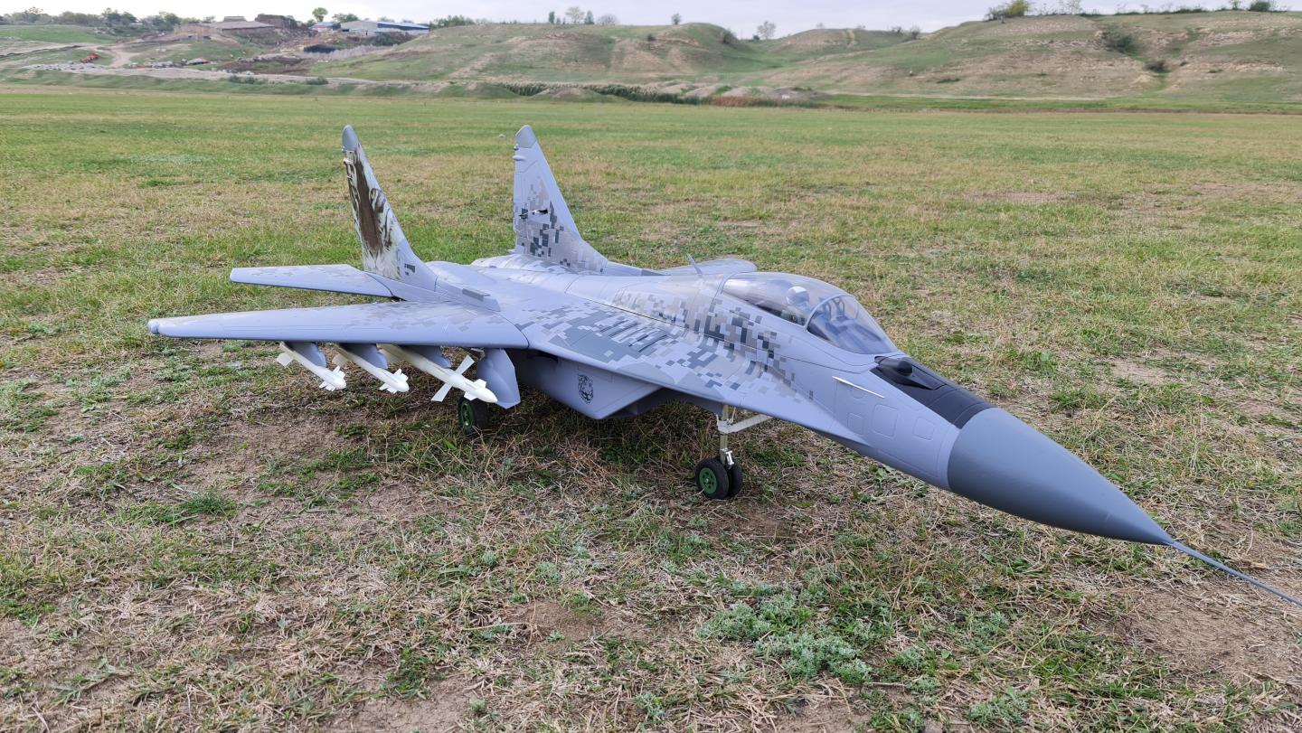

            • Let me start by saying, I have been out of this hobby for 3 years bc I've gotten into boating. Boy, I see the same folks from the Rcgroups and the same pride. I got this plane still in the box ready to be built after in finish installing a 383 stroker in one of my boats. I have read all the pages of this thread and have watched all the videos of the crashes. My take is that this plane is fine with the supplied servos and linkages. The box maybe questionable in quality but it is what it is made in China. The problem i observed is like what I have experienced in past that resulted in similar loss of one or more controll surfaces. Vibration from the motor causing the pin at the extension connection or at the blue box to temp disconnect or fail. Sometimes, the crimp with these thin wires maybe too tight causing a break at the connector. Check those and be happy.
              • In any of these cases of elevator non-responsiveness, has anyone tried letting the plane slow down (reducing or cutting the throttle) and seeing if elevators recover?
                • We will find out soon what is actually really going on with the signal strength and voltage at the elevator servos. I just ordered Hacker telemetrie servos which are sending telemetrie data about signal strength, voltage at the servo, torque load, temperatur, blockade and overload live to the TX where the data gets recorded.
                  • Maiden report
                    Made 3 flights yesterday and all went well.
                    My configuration:

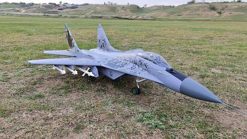

                    1. Changed elevators servos with Corona DS-238 MG. Stock pushrods.
                    2. Changed flaps servo with upgraded servos sent by MRC
                    3. Eliminated the blue box...., well not entirely, is still used for front landing light 🤣. Still needed a 5v Spektrum 2 channels voltage regualtor for the BB.
                    4. Every servo has it's own channel. Using a Spektrum power receiver on 2 LiFe 2200 mAh, so no UBEC needed. The receiver goes under the wood rear battery tray.
                    5. Chokes all around.
                    6. RC-Castle afterburner installed. The ones with the led strip.
                    7. CG 10 mm back from stock location.
                    Everybody here reported that the plane does not need elevator compensation when flaps are down, but mine needed. It had a violent pitch down when flaps were fully deployed. A 7% mix calm that down. Elevator worked very well even when flaps were at full deflection.
                    Unfortunately, the next flight will be when spring comes. Time for build here. Click image for larger version

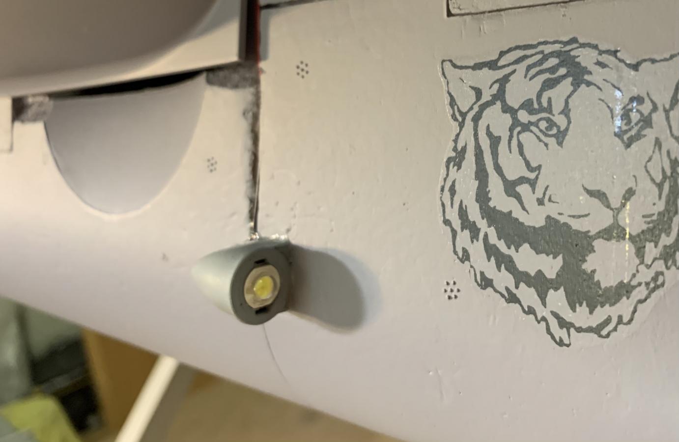

                                • Installed two more landing lights and changed to the “double stage door” setup, all by tapping the appropriate ribbon wires at the MCB.
