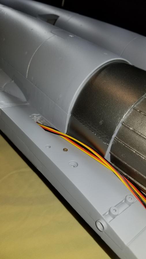

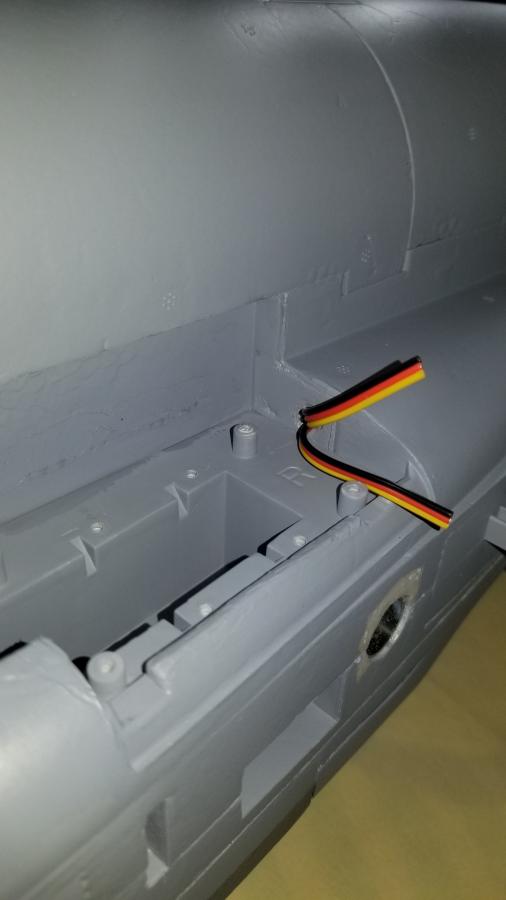

                    A follow up on an earlier post for two stage doors. Here are the pins to move from the wing wiring harness connectors at the blue box. Remove the 3rd wire (next to the red wire) and solder those together and install a connector to connect directly to the blue box two stage door output. Works great and as others pointed out, is not scale but looks cleaner and is cool!! I don't remember who posted the first note about the blue box having two stage door output but credit to them.
                    Click image for larger version  Name:	IMG_20200922_080655.jpg Views:	323 Size:	116.8 KB ID:	276167Click image for larger version  Name:	IMG_20200922_075731.jpg Views:	313 Size:	131.0 KB ID:	276168
                    Here is the post with the pics again for dual stage or double stage doors.
