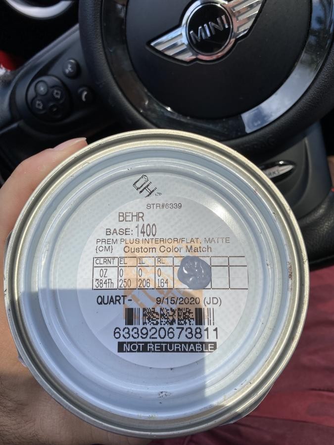

                Does anyone have a photo of the Home Depot touch up paint code for the stock Mig-29 grey color?

                  #2328
                  Here it is, posted by Rudy:
                  Originally posted by RudyD54
                  For anyone looking for a paint match, I got the fuselage done at Home Depot today and picked up Tamiya X10 Gunmetal which is basically an exact match for the exhaust nozzles.
