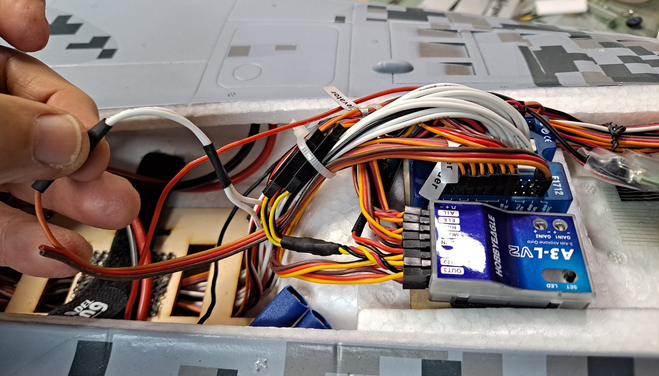

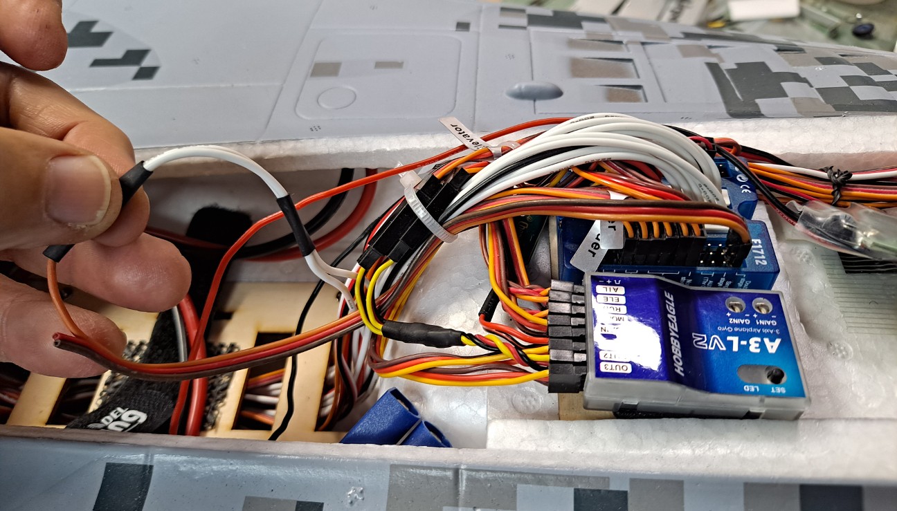

    I cut my wires and then soldered them together to a spare plug that goes into the dual stage slot on the blue box. Works perfect!
    This is just a backup to my previous post, what CRXMANPAT said is exactly what I did. Two white wires spliced together than into a 3-wire connector. But I think my picture is better than his!!! LOL

      Brent bypassed the ribbon cable with an extension...
        #3223
        Yeah, I thought the only two ways to do it were to bypass the wing board and run extensions to a Y to the dual stage door slot, or cut the wires like I described.
                I preferred to cut the wires on the ribbon cable at the board and join the two wires into a single servo connector. Using extensions just makes yet another connection when putting the wing on (X2).
                      I stand corrected. The wing connector board only has pins for the single stage doors so you do have to bypass it to go to the MCB-E double stage pins. I got confused and spoke without confirming first. My apologies.

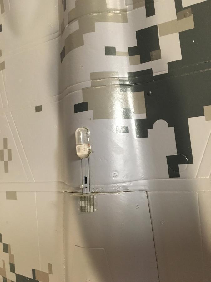

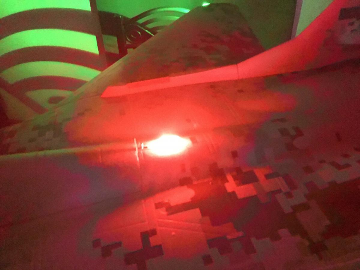

                          Select a BRIGHT one or you won’t see it at a distance when you need it to help with orientation.
                          I pulled one off the A-10 wing...nice lens, and it is a DayBrite LED. Pre-sunrise and post-sunset flights have proven its worth on many such flights.
                          Installed behind the hatch latch. Blue box light option of your choice.

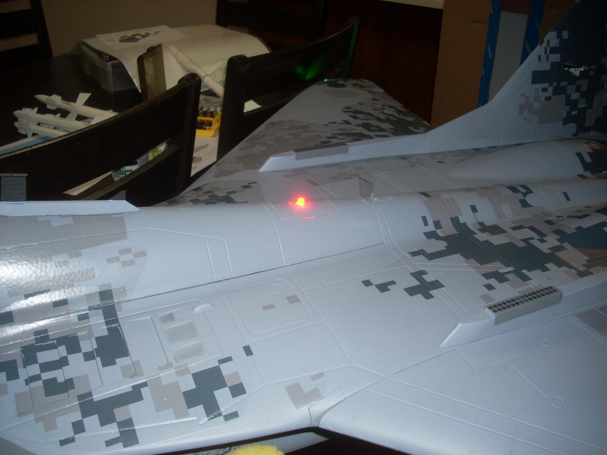

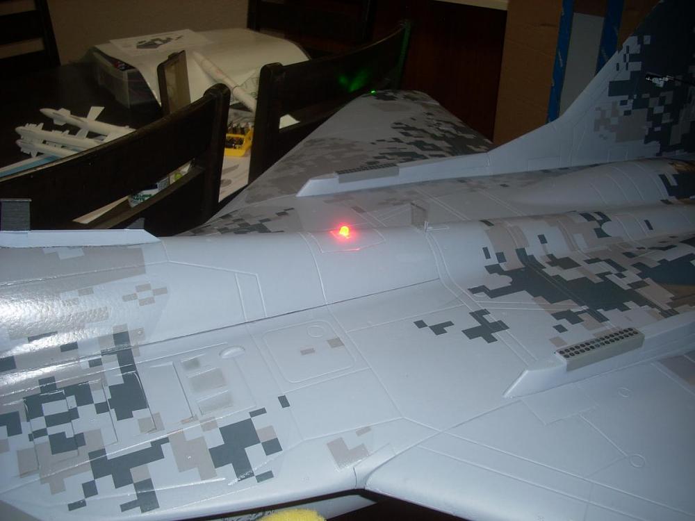

                              I did it as well. Just took a spare LED I had stripped out of a crashed plane and installed it in the canopy hatch. Just plug into the blue box and you're good to go! I have mine on the double flash port.
