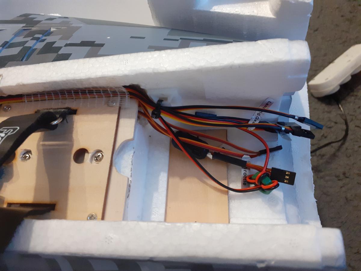

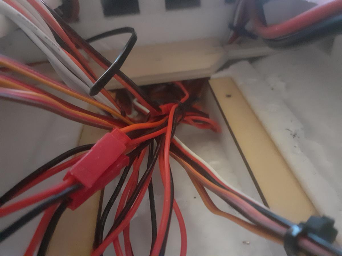

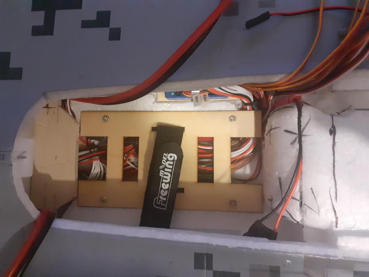

          I'm having an issue getting the canopy sitting tight there's a gap all the way down what a shame for a beautiful plane
            • 8835
            #5225
            I have a gap but only when some of the wiring running down the sides are too lumpy and prevent the canopy from closing all the way. There's a lot of wiring. Move the wiring a bit towards the interior and no more gap. The canopy has a ridge on each side that must be able to sit flush with the floor. If the wiring gets between the ridge and the floor, it can't go down enough.
              • 4878
              #5226
              RP, Welcome to Hobby Squawk, glad to have you onboard, Sir. What xviper wrote about the wiring is a good tip. Post pictures of the issue here if you can't resolve it. It is possible others have had a similar problem. Best, LB

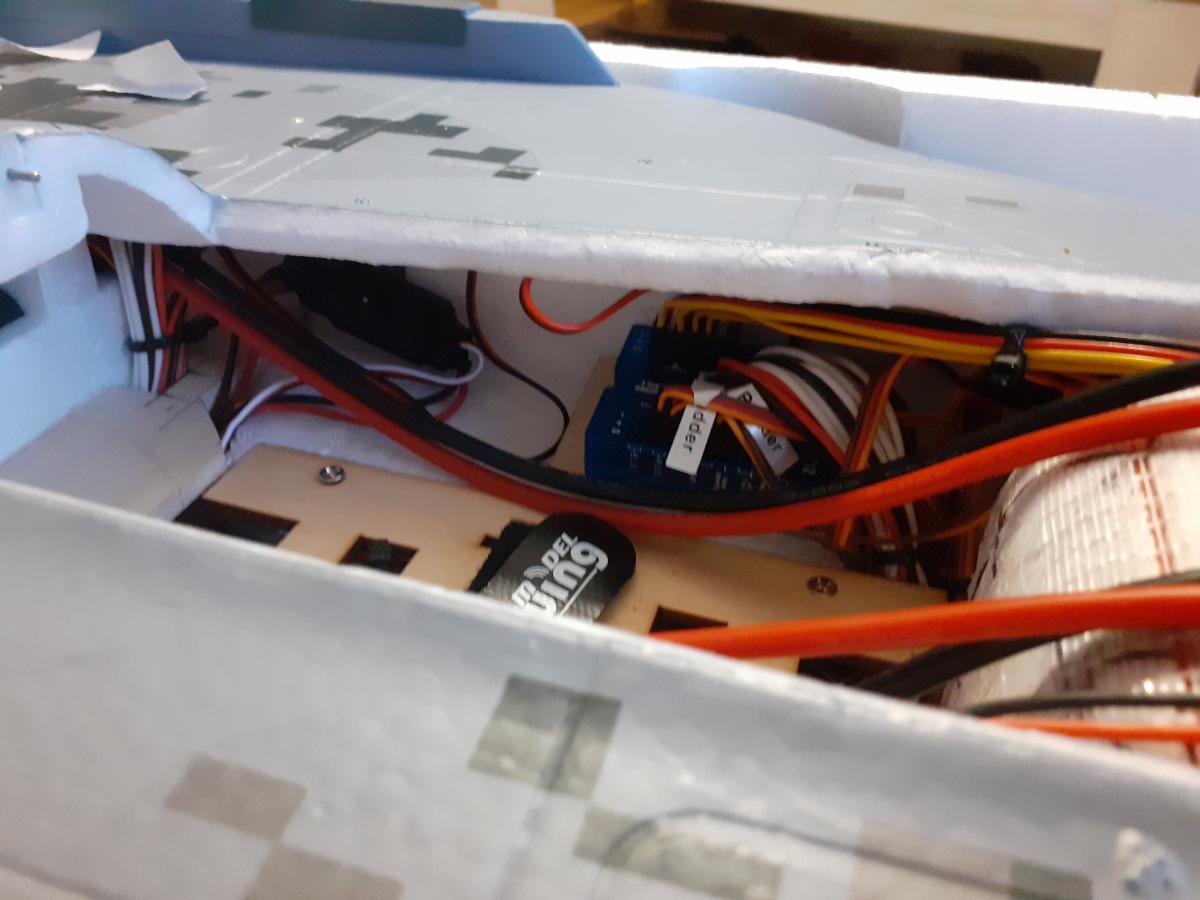

                #5227
                Welcome RP,

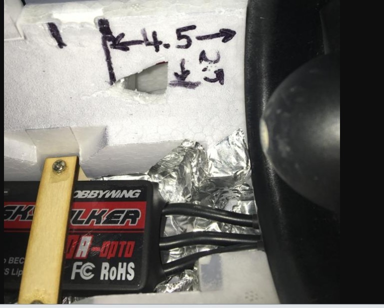

                Assuming you are using the middle battery tray (don’t use the front bay), many batteries will require a little foam removal from inside the top of the lid. Put some grease pencil or other soft tracer material on the top corners of the middle battery and set the lid on. Remove and inspect for marks on the foam. Remove a little foam then repeat until the battery no longer touches the foam.
                FYI...I fly in hot summer weather, so I cut a small hole ahead of each fan to the inside hollow of the fuselage and glued a thin shim under a part of the canopy to keep a small air gap open so the fans suck air from the battery/BEC compartment to keep things cooler up front. Photo below...shows measurements in centimeters from the fan cover cavity edge and fan front (4.5 and 2.5). The hole is made into the foam side that is nearest the fuselage center for each fan. The cavity beyond the hole goes all the way to the cockpit. The amount of airflow through the cockpit is now LARGE!
                Strongly suggest you take the time to read all the posts in this MiG forum before you maiden. You ‘ll learn a lot about needed mods and flight characteristics….to the point of helping you prevent a crash.
                -GG
                (aluminum tape was one of the "attempts" to add RF noise shielding so the FFS servo wires on the other side of the ESCs see less RF noise).
                Click image for larger version  Name:	Vent Cut for MiG-29.jpg Views:	0 Size:	89.2 KB ID:	334393

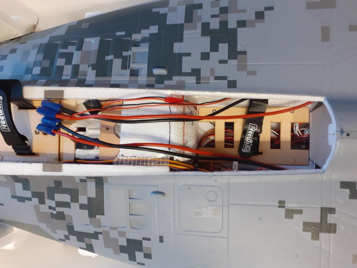

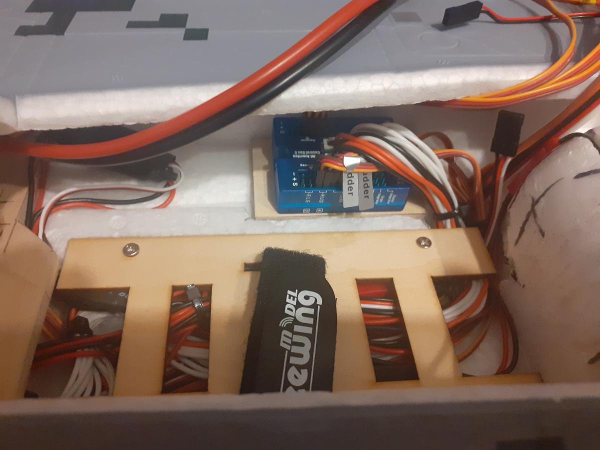

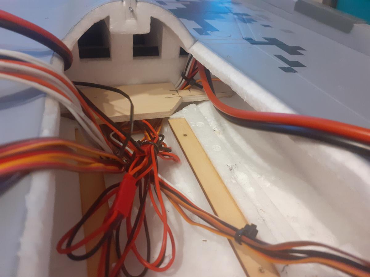

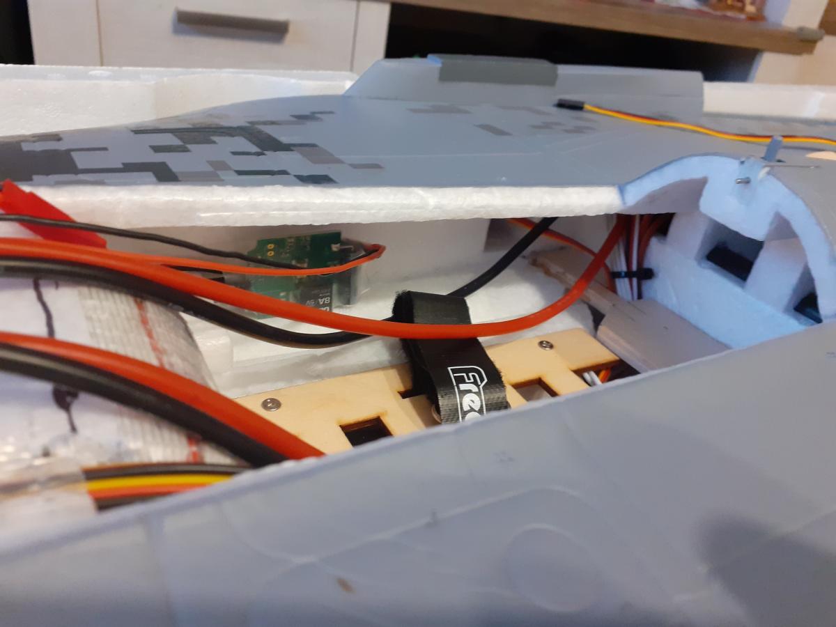

                    The location of the electronics in this model leaves a lot to be desired ... I started building my own by tidying up the electronics and slightly modifying the interior.
                      • 5426
                      #5230
                      There's so many places to put receiver, MCBe, satellites and run wires I think it's about the best... Every plane, to me, needs wire management.
                      • lusek_pl
                        • Sep 2020
                        • 49
                        • Polska

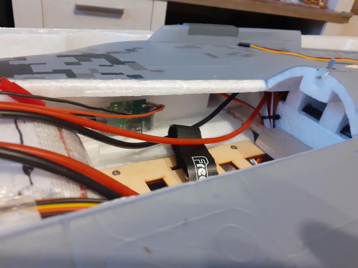

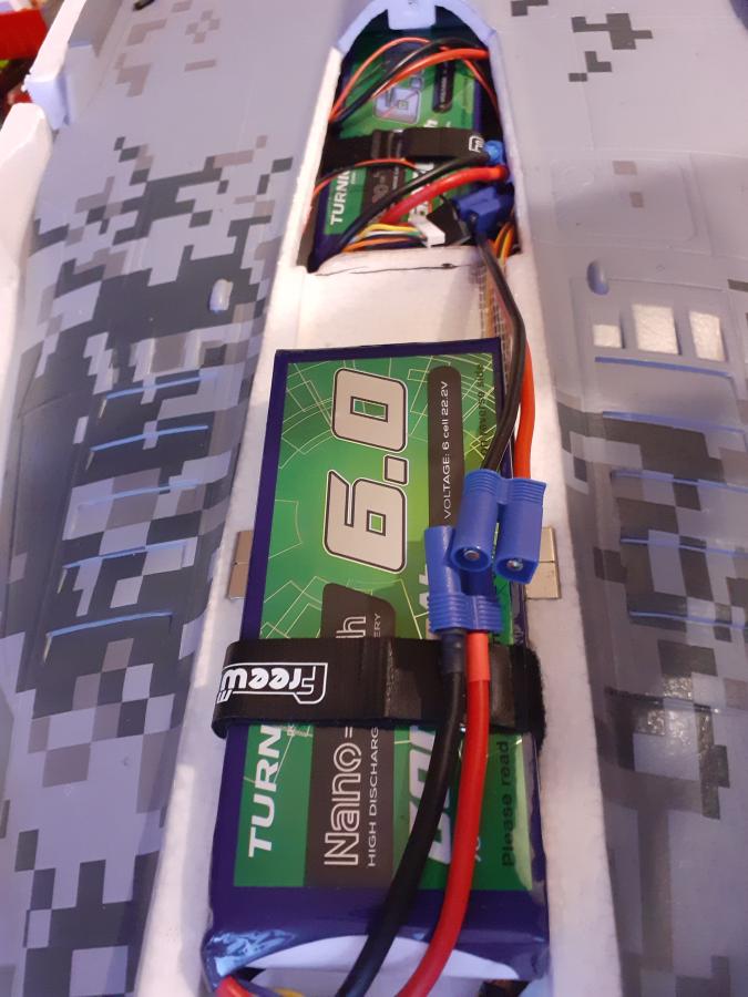

                        #5231
                        Cables tidy, I'm getting on with the rest of the modifications. I was able to fit probably the largest package that can fit in this model :) Click image for larger version  Name:	20220117_153848.jpg Views:	0 Size:	95.6 KB ID:	334911Click image for larger version  Name:	20220117_153925.jpg Views:	0 Size:	77.0 KB ID:	334912Click image for larger version  Name:	20220117_153925.jpg Views:	0 Size:	77.0 KB ID:	334917Click image for larger version  Name:	20220117_153914.jpg Views:	0 Size:	81.7 KB ID:	334914Click image for larger version  Name:	20220117_153901.jpg Views:	0 Size:	89.4 KB ID:	334915Click image for larger version  Name:	20220117_154247.jpg Views:	0 Size:	72.3 KB ID:	334913
