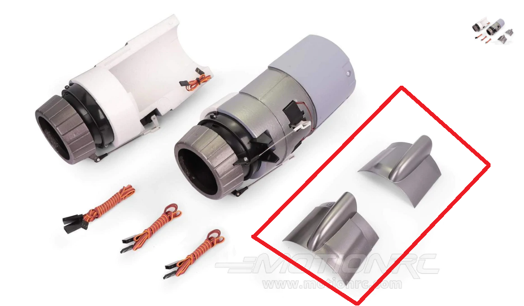

                                          Anyone have the ability to draw and print a couple of these "exhaust skids" for me? Looking to install a couple on my Mig. PM me if you willing to help me out.
Name:	Exhaust Skids.PNG
                                          Another option would be if someone has a set of the vectored thrust skids that they aren't using because of a crash or some other reason.
Name:	Thrust Vector Setup.PNG
