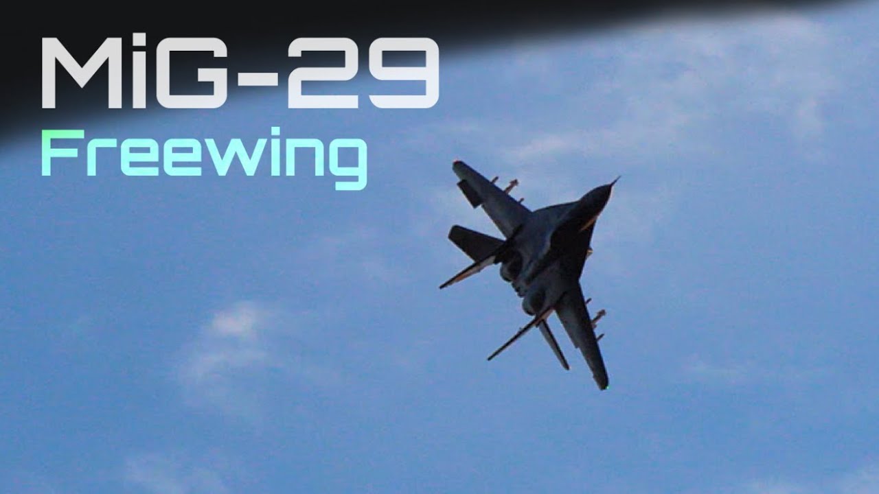

      • I posted back in post 5256 about my weird diving behaviour.
        I posted vid of it on YouTube as per the link below.
        I finally think i found the problem. I just test flew it today and the ac was on rails.
        I think it was a gyro issue. I was settting up another model (a FW F22) and spotted one elevator acting as an elevator in response to the gyro, and the other elevator acting as an elevon!
        Turns out my mig 29 is set up the same way and when i checked it, the exact same thing was happening.
        I’m using a powerbox igyro sat.
        For anyone not using one, it will be incredibly boring for you to continue reading…..
        Id set up each elevator to Elevator A and Elevator B.
        I set up one aileron channel to Aileron A
        Turns out if you want a delta mix with a igyro you assign one elevon to AILERON A and the other to ELEVATOR A.
        As a result one elevator (elevator B) receives a gyro input as an elevator, but the other acts as an elevon.
        To make it worse, the aileron A (the single aileron channel feeding both aileron servos) would have been acting as an elevon when the gyro was active.
        It’s basically an anomaly in the programming when you have two elevators and a single channel feeding both ailerons.
        Problem is solved by assigning Aileron B to any of the other 26 unused channels and it works.
        I had one flight today and it flew great. As the airframe is now “proven” i can start my X45 conversion.

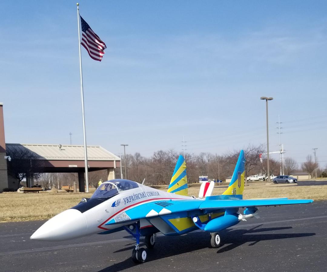

              • Mighty fine job there, Jet. Love the color scheme and your work!
                Fly low, fly fast, turn left
                • Originally posted by Airguardian View Post
                  Masterful….you’ve got the MiG dialed in.
