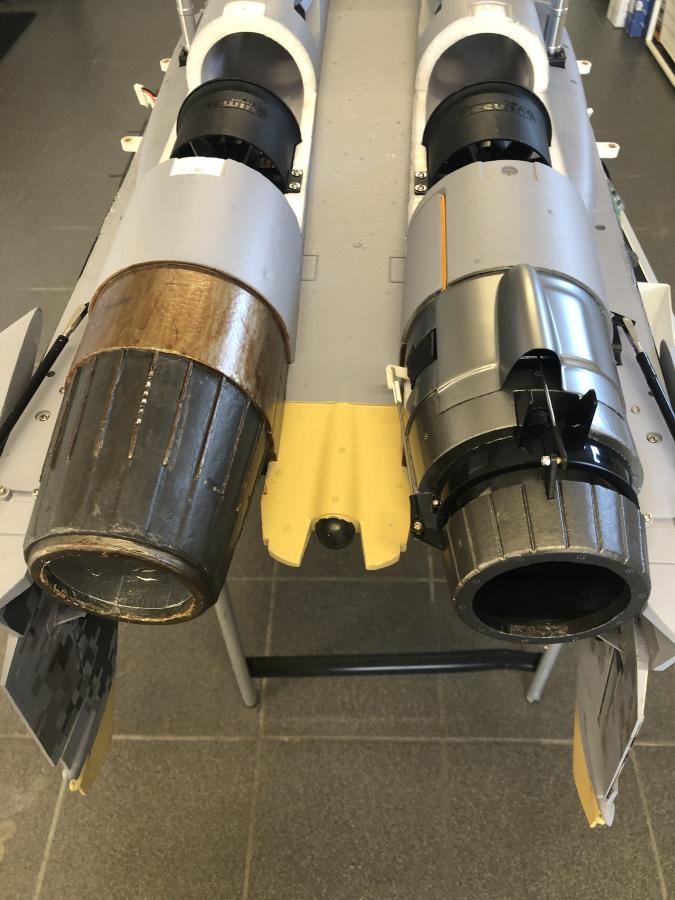

              Anyone planning on putting TVs on to remove the problem?

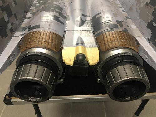

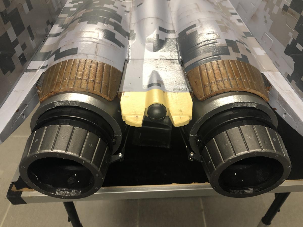

                I'm gonna go the thrust re-alignment route. The thought is to cut the exhausts off and shave an angle to them. I'll start conservative and dial them in after test flights.

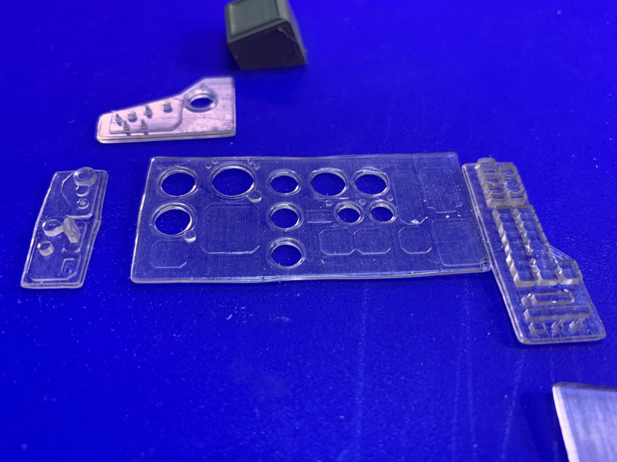

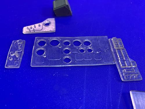

                  Finally done with the cockpit...
Name:	HS Cockpit 1.JPG
Name:	HS Cockpit 2.JPG
Name:	HS Cockpit 3.JPG

                    Done. Just waiting for winter to be over.

                      I put mine on so the elevators have a little assistance and aren't solely responsible for pitch changes. Figured with the falling leaf stall and possible elevator to flap issues it can't hurt. Having extra aerobatic capabilities is of course a nice bonus!

                        Nice touch with the afterburners.

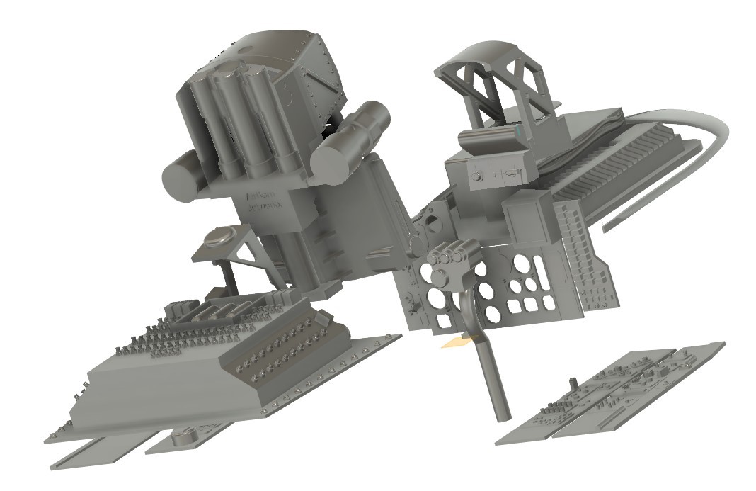

                            Radar-Guy: That cockpit detail is looking really awesome!
                            Do you plan to make the stl-files (commercially) available?

                              Thanks as well. The answer is (currently) no. I don't like to spend even more time on it, there are other projects to be finished. Most of the files will only look nice when printed with an SLA printer, I didn't try those on an FDM type.There are many individual parts, it would need some kind of "instructions" and it's still no simple 'paint and glue' job. Hence, it's not worth the effort for (at most) a handful of downloads.
                              Click image for larger version  Name:	Screenshot 2021-03-08 094929.jpg Views:	0 Size:	84.3 KB ID:	303016
                              Click image for larger version  Name:	Screenshot 2021-03-08 095059.jpg Views:	0 Size:	88.2 KB ID:	303017
                              Click image for larger version  Name:	Canopy Bow 1.jpg Views:	0 Size:	41.4 KB ID:	303018
                              Click image for larger version  Name:	IMG_4357.jpg Views:	0 Size:	102.9 KB ID:	303019

                                Click image for larger version  Name:	Mig  VT2.JPEG Views:	1 Size:	116.1 KB ID:	303045I
                                nstalled my Vector thrust, nice fit.
                                Didn’t find the correct way to have all 3 channels (rudder, Elevator, ailerons) on the VT with my 8 ch receiver, ordered a 9ch receiver and hope to find the correct proper wiring and mixing
                                Click image for larger version  Name:	Mig VT1.JPEG Views:	1 Size:	78.8 KB ID:	303044

                                  I have made some cosmetic improvements to the 3DP files for the VT nozzles.
                                  This is a nozzle to replace the stock foam one in the Freewing MiG29 with VT.The foam nozzle is just held on with tacky adhesive and can be removed without damage if you're careful.There are two versions, one with the inner petals extended beyond the outer ones, and one where they are not. Take your pick.Print with minimal infill if weight is a problem.
