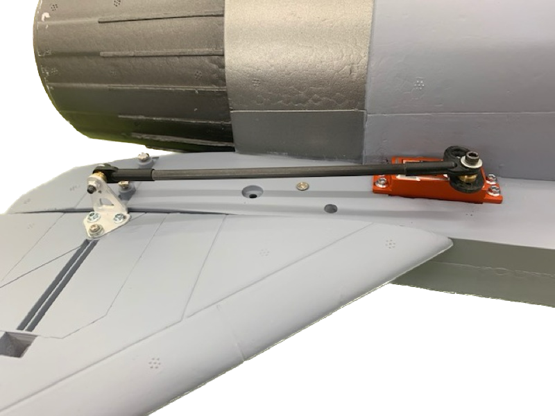

    Well I am every disappointed with the mig-29 my granddaughter fly twice and the 3 time the Elevator linkage bend so is there any linkage that will be strong
    I replaced the stock linkage with 4-40 threaded rod with carbon tube sleeve. It won't bend.
      • 5426
      #5962
      Even the original thin wire in carbon wouldn’t bend, I’m wondering if he’s talking the horn or what…
