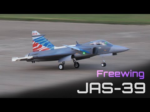

      100 pages of Gripen thread... gotta celebrate it right?
      There's some Gripen fun including crazy TV maneuvers, extreme high alpha, smoke cartridges and even an unfortunate crash (nothing serious, don't worry!).

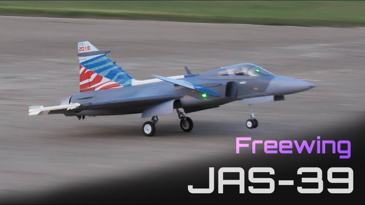

          Another Gripen video with crazy high alpha scenes and CG at 40mm :)
          + I may have exceeded myself a bit for the 'bonus flight', and you'll see what I mean by that when you get there...
