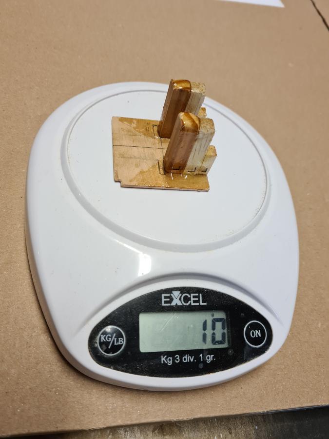

                              Tried it today. I managed to get to 40mm by moving the pack as far back as it would go.
                              Agree it flies better, and the flat spin exit was definitely improved.

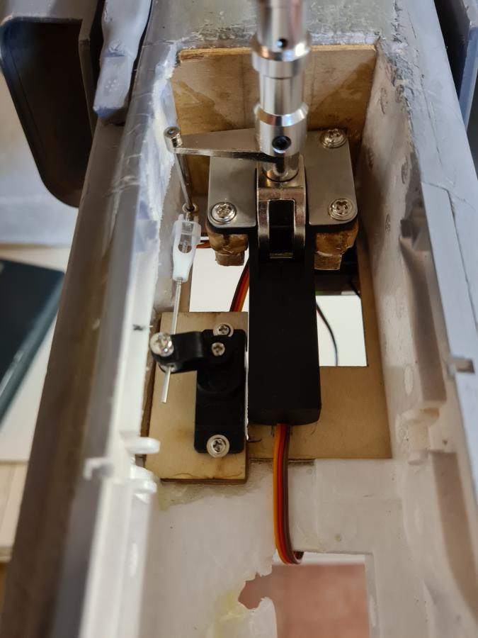

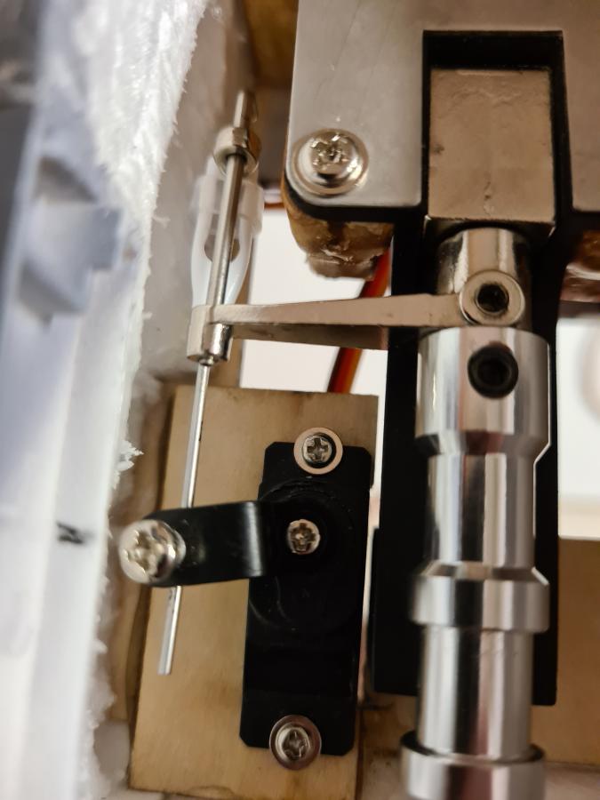

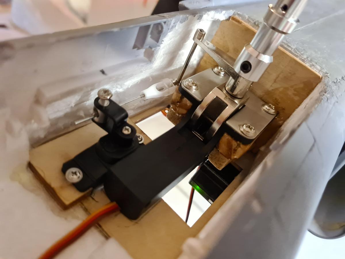

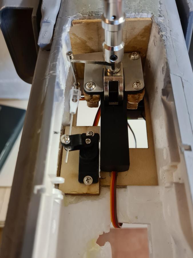

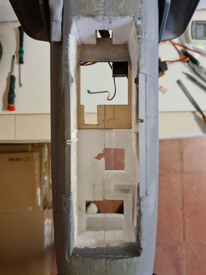

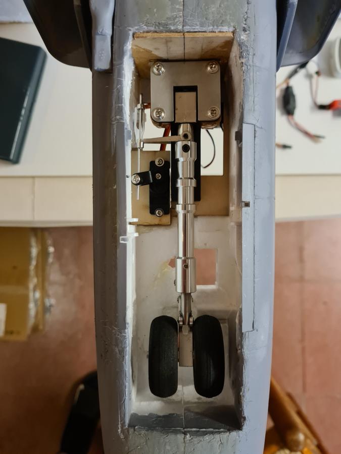

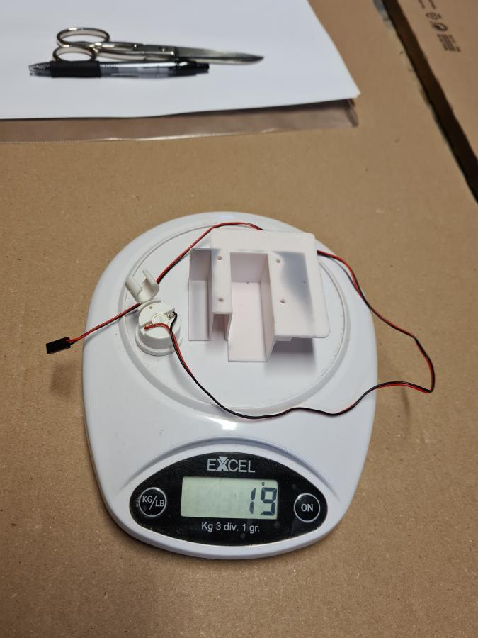

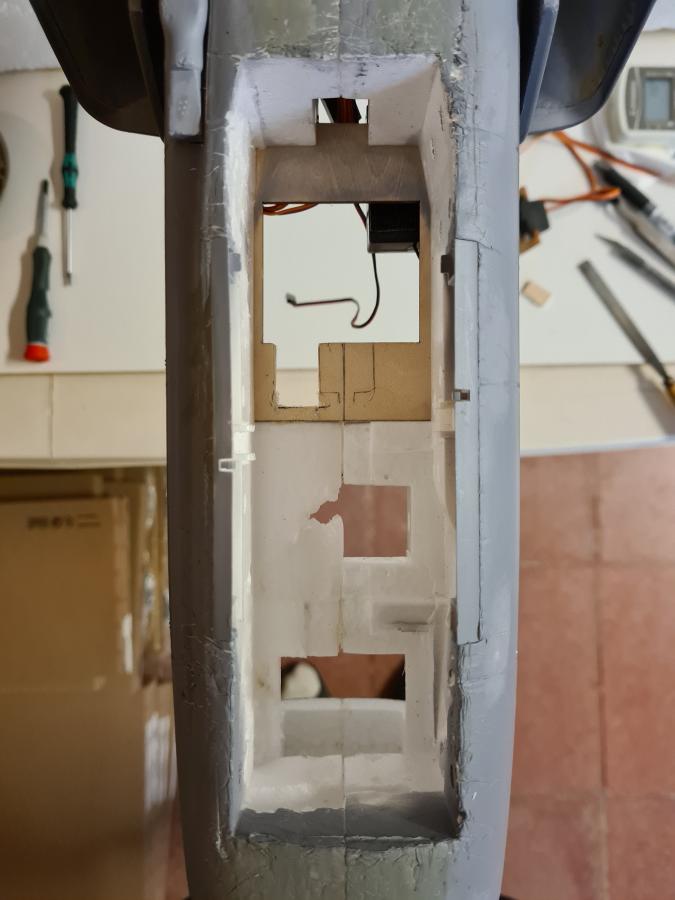

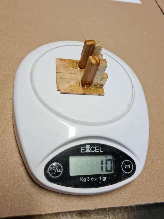

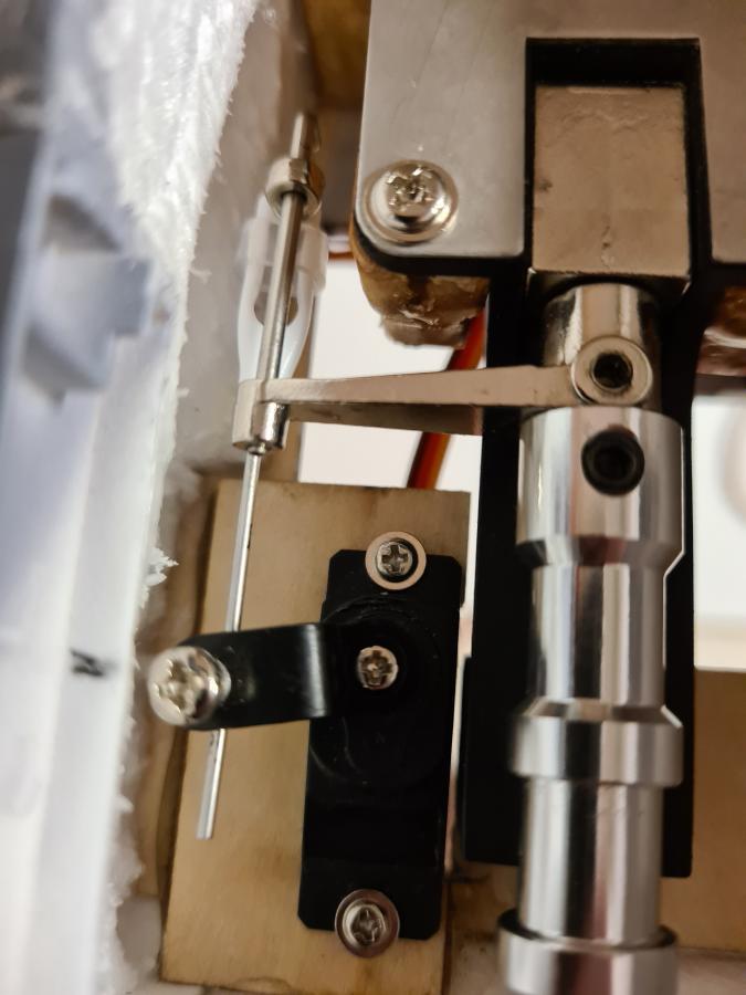

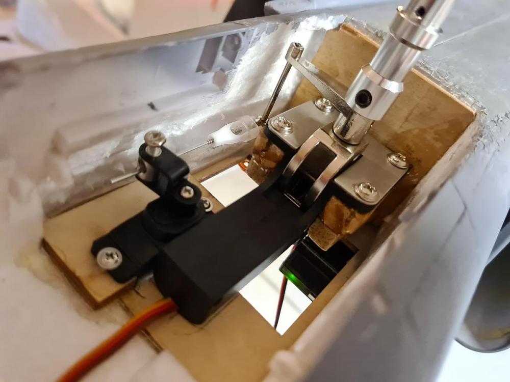

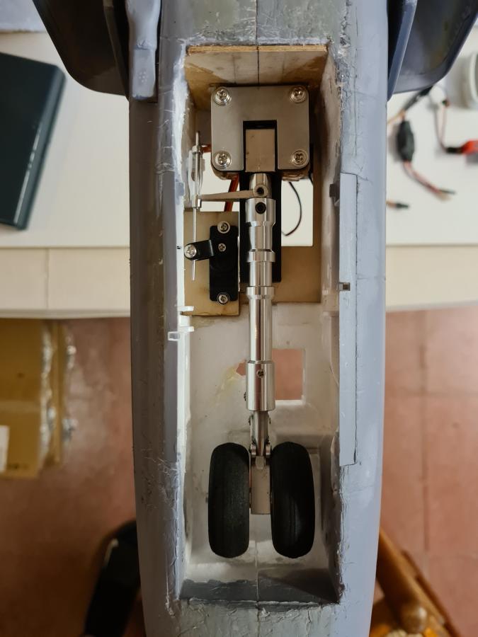

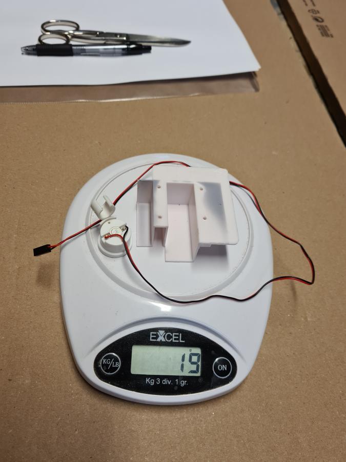

                                  I'm a believer! So are there any detailed pictures taken of reversing the nose-gear? This will be a winter mod for me, if it happens.
                                  • Airguardian
                                    Post Stall Svengali
                                    • Aug 2020
                                    • 1676
                                    • Catalonia
                                    #1957
                                    There are now!
                                    You need to perform some minor foam carving so that the wheels fit in place and the steering arm doesn't rub with the side wall, all pretty easy though laborious.
                                    Notice I also had to cut the stock wooden piece with the square gap to install the steering servo in place. Measure well the distances so it will work as expected.
                                    I use Tx programming to make sure that the steering servo doesn't clip or bind when retracted and limit throws to about 15% in retracted gear position. I still want it to be able to move a bit to 'break free of locks' so that the servo doesn't fry if it got stuck in a bad position.
                                    You can use the stock plastic mounting block by relocating it, but it is designed to slide into the foam and mounting it now that the airplane is glued together would take quite some forcing of the foam and I wasn't happy with that, so I used instead some inventive on my end and made a new mounting block made of 2mm plywood planck, a couple of plywood square rods and some additional balsa rods to keep the weight down. Everything is covered in epoxy to prevent wood delaminations when possible. The wooden mounting block itself, I glued to the foam with the 'Kingboxer' contact glue that comes with FW kits. There is plenty of contact area so it should do a great job. So far so good!
                                    Click image for larger version  Name:	image_74836.jpg Views:	3 Size:	51.9 KB ID:	325072Click image for larger version  Name:	image_74839.jpg Views:	3 Size:	60.6 KB ID:	325075Click image for larger version  Name:	image_74835.jpg Views:	3 Size:	56.3 KB ID:	325071Click image for larger version  Name:	image_74838.jpg Views:	3 Size:	57.8 KB ID:	325074Click image for larger version  Name:	20210904_035046.jpg Views:	0 Size:	56.3 KB ID:	325076 Click image for larger version  Name:	image_74837.jpg Views:	3 Size:	54.6 KB ID:	325073Click image for larger version  Name:	image_74833.jpg Views:	4 Size:	83.4 KB ID:	325069Click image for larger version  Name:	image_74834.jpg Views:	3 Size:	56.4 KB ID:	325070
