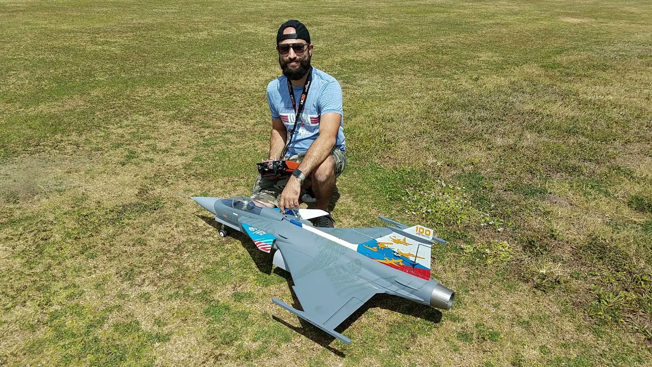

RudyD54 with another flight on his Gripen on a windy, gusty day.

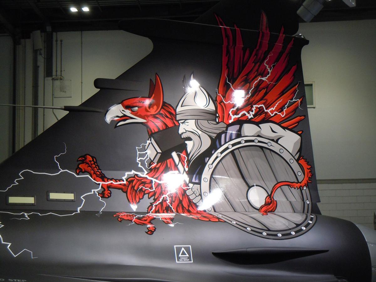

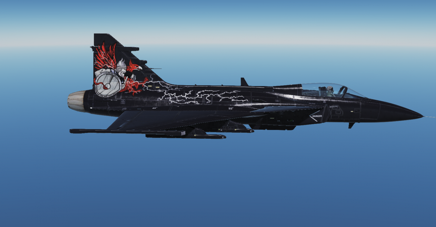

Just wanted to thank everyone in this thread for all the technical advice. I went nuts over this model, as its one of my top 3 favorite fighters. I ordered it, and everything else I could find for it!!!
So far I just got the Gripen in, I ordered Strobon V2's to upgrade all the lighting including adding the whit markers back by the tail cone, I ordered the F-22 Formation light kit to make these working as well, I found a company on aliexpress that had 6 thrust vectoring units left (already cleared customs will be here by the weekend), I ordered an RC Geek centerburner, and for my biggest change I just sent payment to Callie for 2 sets of graphics - one for splinter camo and the second which is going right on, the Aggressor graphics with Thor on the tail!
Cant wait to get this done... with some tricks you guys have come up with added in with my own. Looks like Ill be getting started next week.
