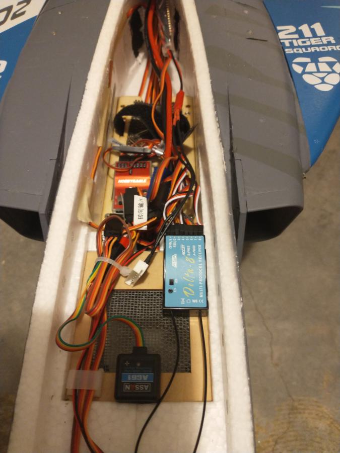

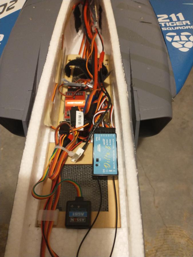

                                        Hi guys, do you have any recommendations or photos for the location of the gyro?
                                        • radfordc
                                          • 375
                                          • Lansing, KS
                                          #1940
                                          Here works for me Click image for larger version
