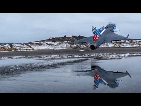

                      Let’s Get HIGH ALPHA and LOW
                      With the 80mm Gripen from Motion RC and Freewing.
                      TURN IT UP 🔊

                        VERY artistic and well done. The snow in the background is a nice touch.

                          Very nice, but it needs an afterburner.
