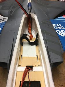

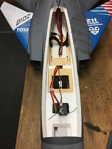

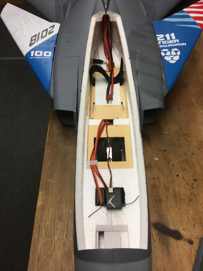

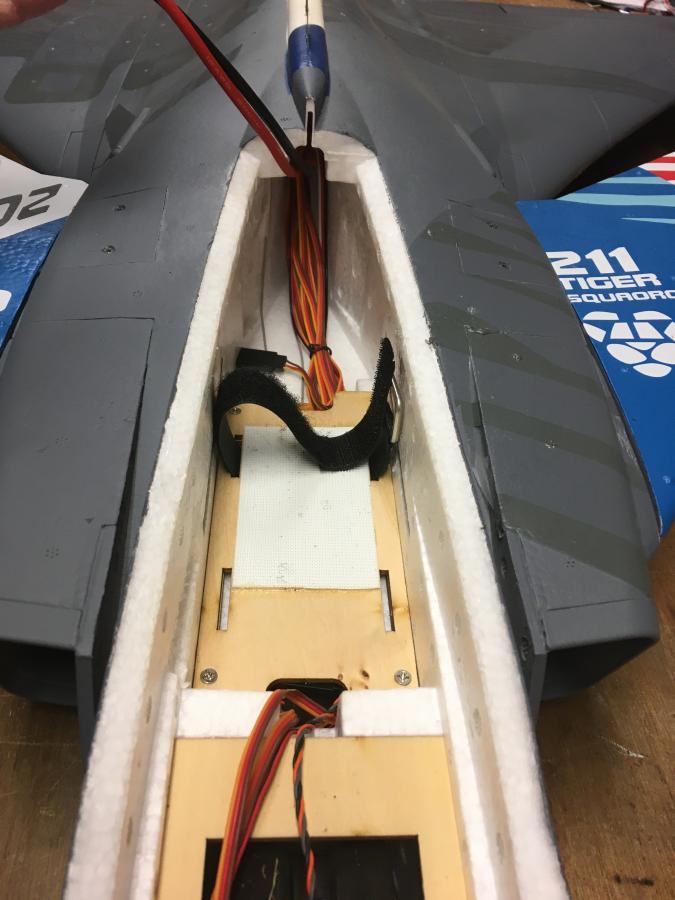

                                  • Not sure what you mean by the very back as the back tapers down pretty far back there. Get rid of everything behind the battery and move it back. put the light module under the battery tray, the receiver too. Here is mine, my 6S non-TV one.
                                    Power Hobby 5000mAh 100C, probably not available where you are.

                                      That wiring is so neat 😱. I've been messing with mine tonight, pulled all the cables from the battery bay into the rear of the jet to move as much stuff backwards as possible, I've pulled the ESC back as far as I feel comfortable and the Rx and led controller are now behind the wooden tray and under the rear of the battery. Let's hope that gives me a few grams of lead out of the tail
