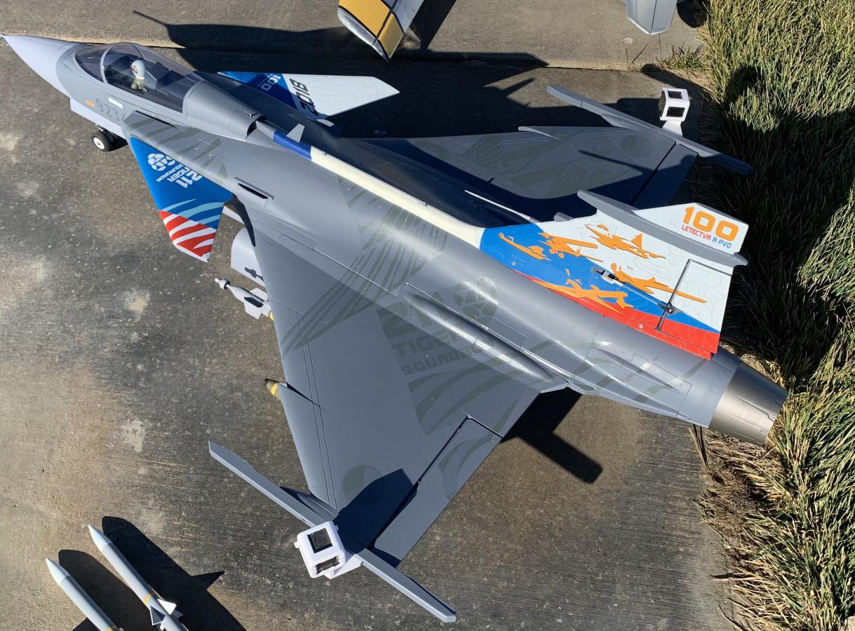

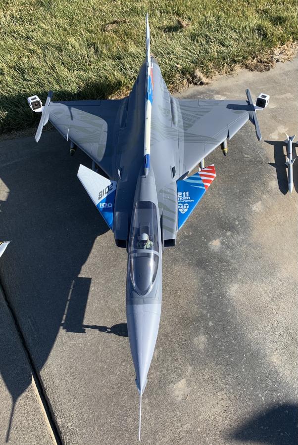

    HAPPY THANKSGIVING! Hope everyone is going to have a good dinner tonight, and go flying tomorrow!
    I think we're ready to maiden tomorrow!!! Really excited!
    I cut away some foam on the horizontal detail on each side of the tail section (on the bottom), and glued in about 3 oz of lead. I didn't want to put anything in the duct, and wanted to use as little as possible, so as far back as made sense. I am balancing on the CG now with the HRB 6s 6000. I don't think 3oz is going to affect the flight characteristics that much at all...and it is a jet, afterall..
    Found these missiles (below) in my piles of "extra stuff", and asked my buddy to print me a few of the connectors so I can slide them off an on as I like...but I really do appreciate the additional contrast from them for visibility too. There were foam standoffs on the shafts of the missles I removed, and you can see where I glued the attachment parts on. I think they're from Freewing, made of foam and paper, so no weight added, really. My buddy also printed missiles for me too, so I can use them if I need a bit more weight towards the back.
    After all the reading, I'm thinking I need to be about 10mm behind the printed CG for best performance, but I'll maiden as is and then do some fine tuning once I get used to it. I have a Lemon RX/gyro with satellite (tested in another jet, so I know it's solid), but I'm leaving the gyro OFF until I know it is flying right by itself. Then I may turn it on for wing-rock and high-alpha stuff...but we'll see. I really don't use gyros in airplanes that often - mostly drones and helis.
    I set my "high" rates to the low rate settings in the book, like Mike? did in the Motion videos, with mid at 90% and low at 75%. We can always add more, but I want to make sure the first flights are successful.
    I watched a lot of the full-scale videos posted here, and suggested by YouTube...wow, it is agile! Possibly tighter turning than our own F-16? Pretty nice jet - and very cool that it stays "in the box" the entire time at airshows. Wow.
    Canards: how many MM's of down should we be at in the relaxed position? Videos look like maybe 1-2 degrees?

ID:	287913 I’m not using any canard reflex, where did you hear to do that? You’ll probably like it balanced a bit behind the marks but on the marks works for the maiden. The missiles look good. I have sidewinders on mine. Good luck with the maiden.

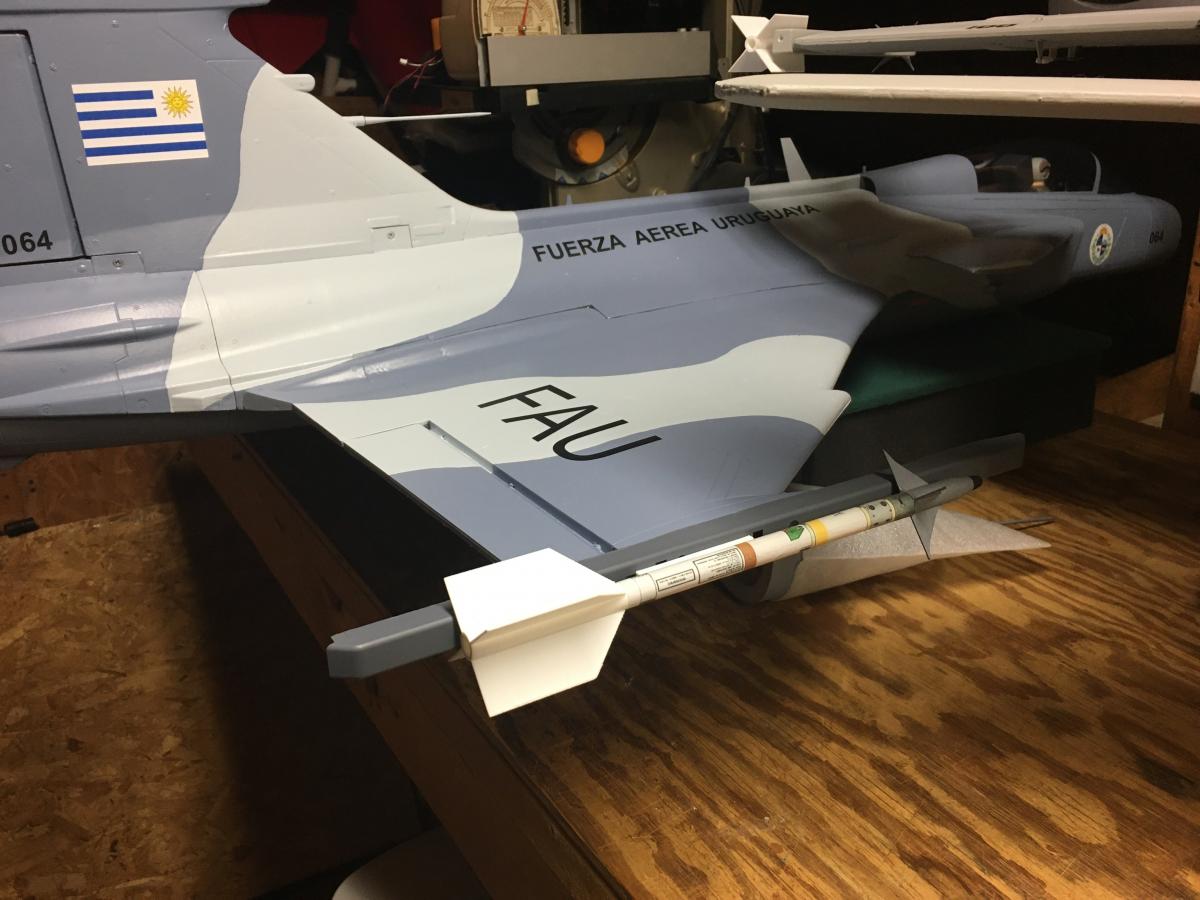

          Originally posted by Marktur
          PS. My buddy printed a tailcone for me. Told him to go heavy on the fill, and it is solid. Just wanted to find out how you guys attached it...it looks like I need to cut off the original tailcone, but leave about 1" to slip inside the new plastic one? It also has holes in it for more weight, and I figured I can pour in some epoxy to add more weight if necessary. I'm going to fly it as stock with my lead weights first because I'm thinking I may want to add more after reading all 55 pages here! :)
          That sounds like the tailcone I designed. https://www.thingiverse.com/thing:4650359
          Yes, it needs a stub of foam (about 13mm) to locate it and to glue to. The holes can hold up to 60g of additional lead.
          I also have Sidewinders to the correct scale (1:9) with lugs that fit the Gripen rails. https://www.thingiverse.com/thing:4653284
          Several of us have found that about 2 - 3 mm down at the front of the canards improves the stability.
