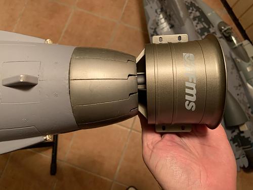

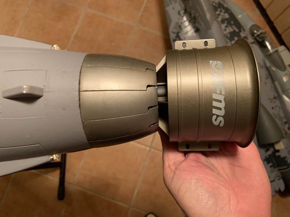

                                      TangoVector I don’t think that it’s such a good idea to consider the FMS 90mm fan for the Gripen...

                                          #1000
                                          Oh...
                                          Thank you!
