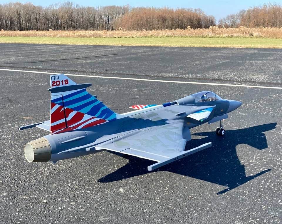

              Finally got around to maidening mine. Flew very nicely with 133mm CG. 5000mAh HRB pack with my "heavy nozzle" worked out well.

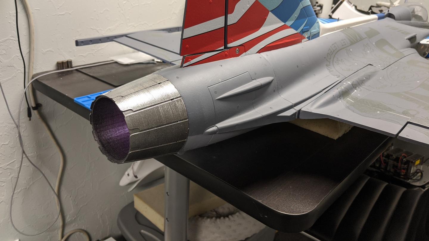

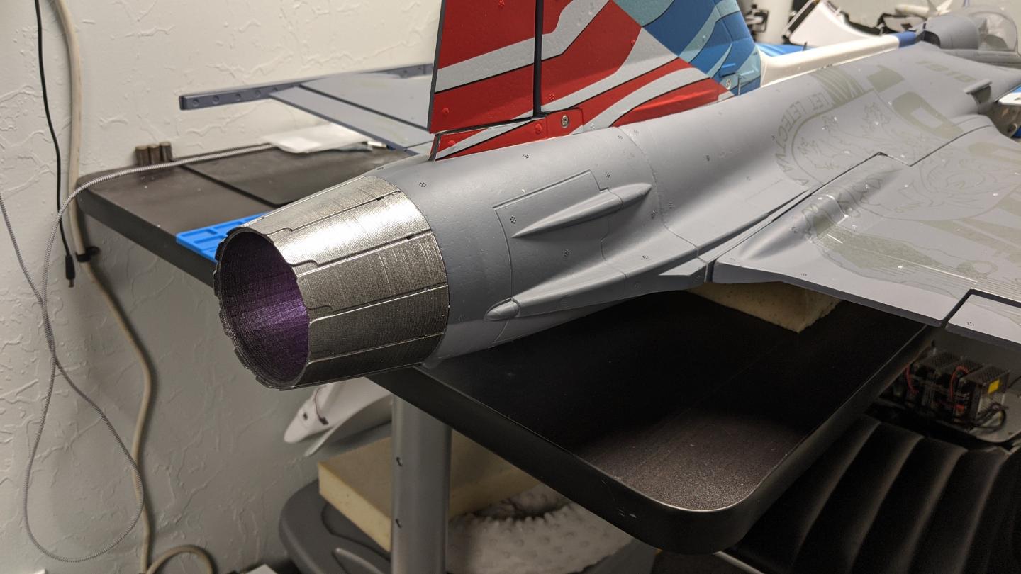

                    #849
                    I have mine printed and it really looks nice. The material removed was 15 grams and the heavy nozzle was 62 grams. Now I just need to figure out how much lead to add and glue it on.

                                    My Kallend Heavy Nozzle ended up at 104 grams. Nozzle with 42 grams of lead shot added to balance my RT 5800s 35C (771 grams) at 10-15 MM behind factory CG. The plane also has an afterburner installed which helps a little.

                                      #858
                                      All planes are different for various reasons but mine took 50g (in the stock exhaust) to balance at 133mm with 8S that weigh 865g.
