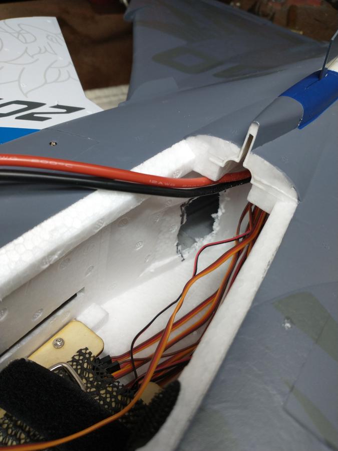

                                I'll take a look tonight, but with some foam shaving is it possible to move the fan unit back some? I haven't really touched mine sans for 3d printing ordinance, but I feel like the weight savings in the front and CG adjustment are the way to go. I remember one person cutting foam to move their battery back, that seems like a good place to start. I'm sure there's more we can do!

                                      Originally posted by HockeyMac!
                                      I'll take a look tonight, but with some foam shaving is it possible to move the unit back some? I haven't really touched mine sans for 3d printing ordinance, but I feel like the weight savings in the front and CG adjustment are the way to go. I remember one person cutting foam to move their battery back, that seems like a good place to start. I'm sure there's more we can do!
                                      Looking at the part at the rear of the compartment where it narrows, that part looks quite thin and you could easily cut right through to the intake channel. I suppose if you cut through, the battery could actually plug the hole.
