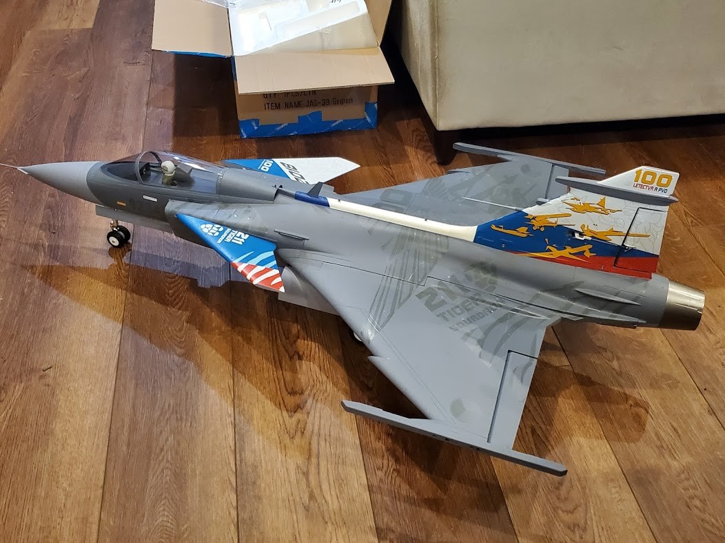

    Hi All,
    I have joined the ranks of Gripen drivers! :) Wife surprised me for my birthday on Saturday! After watching a bunch of YouTube videos, I'm really excited. What a speed envelope!
    She's already built, but wow, I learned something about my wonderful Graupner MZ-24 radio: It doesn't have a Delta wing setting!!!! I have been fighting with programming for 3 days now (and I'm a software developer - shouldn't be this hard, LOL!) but the best I can get it is to have everything working perfectly EXCEPT I cannot reverse the direction of the elevators in the main wings. I used a 2-ail, 2-flap setup (that got me the closest) but if I try to change the direction of the wing servos, the ailerons are backwards. After lots of research and comparing to other name brands, I've realized that I'm missing this important software component...unless I'm missing something, so wondering if anyone is using Graupner?
    I also have a new RadioMaster Tx16s (which I'm really taking a liking to), and an older JR X11...both seem to know what to do (delta wing), so today I'll get things setup on the JR since I am still getting to know the RadioMaster OpenTX software. I really think this is an amazing radio, and it binds with every type of receiver...but I'm going to do my range checking, etc. with some drones and planes I'm willing to donate to the airplane gods (if worse-case scenarios happen). I WILL put a Radiomaster RX and tiny battery as a "passenger" just to have a real "jet test", but will control everything with the JR. It has tons of telemetry (FrSKY) so I'll know everything and may migrate over once I'm comfortable.
    ANYWAY...I'm up to page 17...so I have a lot of reading. Hope you don't mind if I ask just a couple of questions to get quick answers:
    1. Best battery? I have several HRC 6000mAh that I would like to use. I use them in my Avanti and other 90mm's too. Love the extra minute of flight time! It requires about 3oz of weight on the tail to balance based on the marked CG on the wing. What is the recommended CG after you guys have all been flying for a bit? Still at the mark on the wing? I don't think 3oz is going to upset the weight of the plane....but would like feedback.
    2. What are the best Hi/Med/Low rates (how much movement for aileron/ele/canards?
    3. Any last minute tips before I maiden on Friday??? :)
    Thanks everyone!

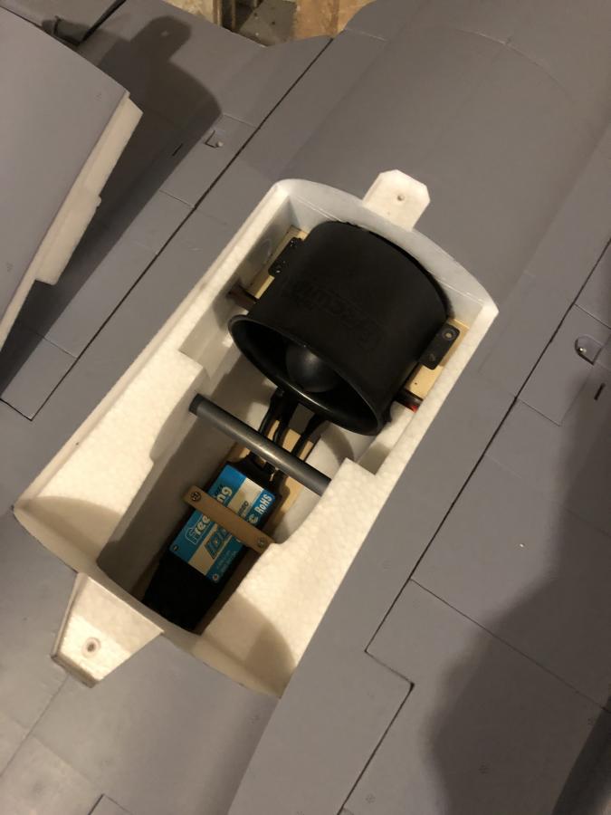

              I'll take a look tonight, but with some foam shaving is it possible to move the fan unit back some? I haven't really touched mine sans for 3d printing ordinance, but I feel like the weight savings in the front and CG adjustment are the way to go. I remember one person cutting foam to move their battery back, that seems like a good place to start. I'm sure there's more we can do!
              With some foam tuning, sure, it should be possible. We are carving foam and gluing new anchors for turbines after all, so why not a fan?

                  Originally posted by HockeyMac!
                  I can't recall who did this, a few pages back.
                  That's what I meant by the foam in that location being quite thin. It's easy to carve right through to the intake tunnel. However, the battery should plug the holes.

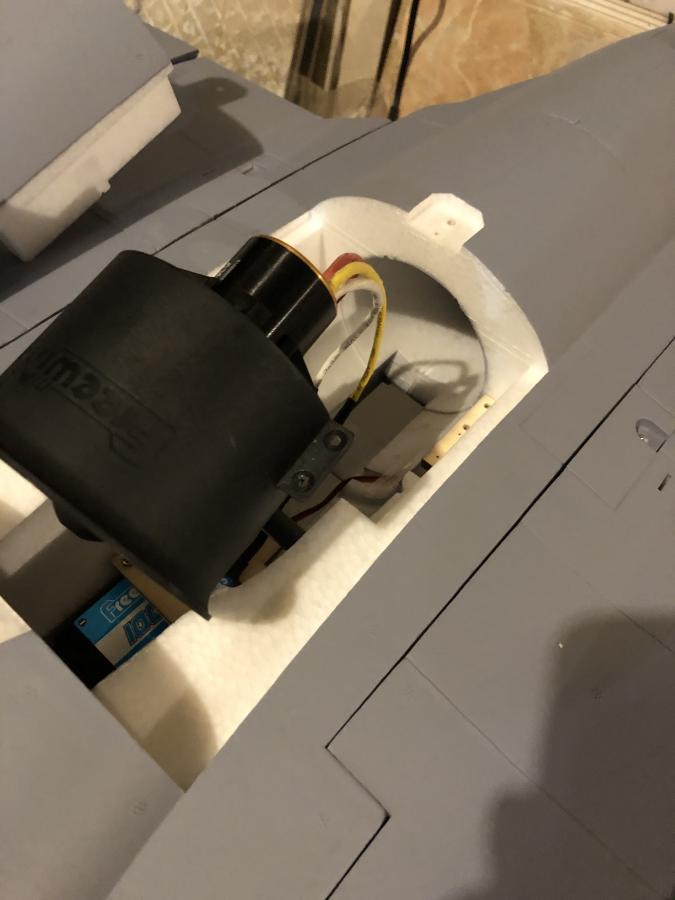

                    #1069
                    Yea I think he mentioned that the battery plugged those holes for sure, or at least I’d hope!
                    Here’s the fan unit. Good point by janmb with our turbine friends carving foam out. Certainly seems doable and can make some mounts that are 3DP or very simply plywood. My take is alpha tried “balancing” this model for two setups. One with and one without the vectored thrust unit. I just hate to add dead weight and a 4-4500mah battery :)

                                #1075
                                Looking at the part at the rear of the compartment where it narrows, that part looks quite thin and you could easily cut right through to the intake channel. I suppose if you cut through, the battery could actually plug the hole.
                                Cutting through isn't a problem. Many jets have cheater holes in the intake. And, yes the battery does plug the hole in this case.
                                • HockeyMac!
                                  • Nov 2019
                                  • 34
                                  #1076
                                  Originally posted by radfordc
                                  It was me...and it flys awesome!
                                  Ah it was you haha! Do you think we could cut more foam and sit the battery back further?
